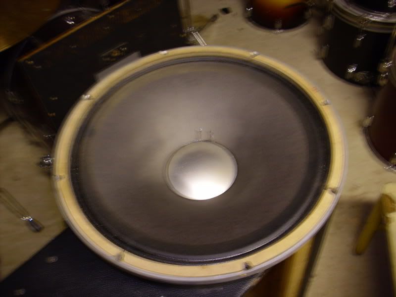

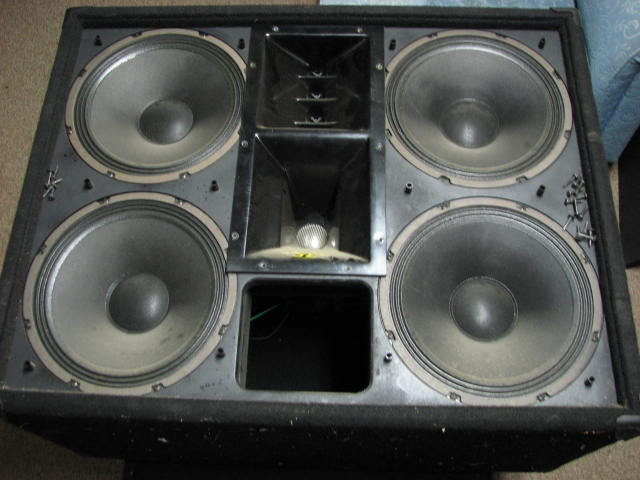

so far
Well the cab is built, still got some work to do on it, but the basics are there
these speakers are ancient!!!
here are a few pics if anyone was still interested.

Hey DH, The cab looks pretty good. Are those Altec?!
😀 If so, you have some really sweet drivers right there. They are quite possibly worth some bucks, so treat them kindly.
So, are you going to finish the cabs in tolex or carpet, or are you going for polyurethane for a natural look. Have you found a suitable metal for grill covers. If you are going to put some sort of grill cloth over the front, then you could cover the speaker cutouts with a coarse screen from a hardware store for an extra measure of protection. And if those are Altecs, they are worth protection.

hmm
I have no idea what they are lol. ill check them out
yea im planning on getting some carpet this week. I got some thin metal made for going infront of old school furnaces. its pretty thing so i think ill get some screen like you mentioned. Thanks for the help

Hey DH, I was looking at your thread in the musical instrument section, the original cab for the 15's looked like an old fender cab for the bandmaster head of the 60's. We had one of those setups in my high school auditorium. They had a damn fine tone. I remember a guy jamming away on a strat doing some surf music. It looks like you got a great score with that find. You could probably still sell the cab to someone!

well
1 problem. the cab is in really bad condition. has sheetrock screws put in all over the place. it looks like someone tryed to repair it or something. definatly not built this way in a factory. has 2X4's all over the place on the inside. looks like a 12 year old got ahold of a drill and some wood haha
