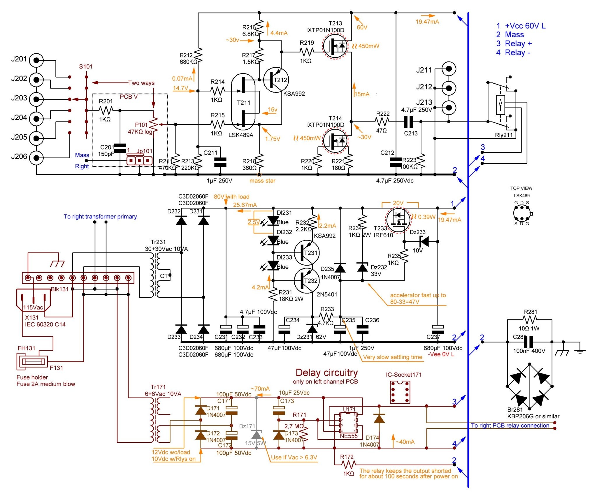

My last post was about the validation of the Cascode/Sziklai configuration. I didn’t post its schematic, and @Alexandre said it should be OK.
It works for sure, Thanks, Alexandre! I was able to test it. All working points are OK. I heard one only channel in my test installation (because of burnt left LSK489), the music flowed across it, but I’m not yet able to say anything about its sound quality.
Now I’m able to post the whole schematic, so the thing is a lot more clear, and ask again:
Do any of you spot any negative points in this Cascode/Sziklai circuit?
Looks good to me!
I was going to suggest that you also try the Baxandall cascode, where the gate of the cascode is connected to the source of the main jfet for AC. But it sometimes rings, it's less stable.
- Thank you @Alexandre
I had some trouble keeping it quiet, but once housed in the cabinet, and connected to the potentiometer it stopped oscillating, so the issue is resolved. It works at its best with R216=8.2KOhm and R217=470Ohm to say 1,2mA across the JFETS, and 2,7mA across the BJT. The sound... I can't be impartial Google "scarrafone rule". To me, it sounds like my hybrid LeGrand at #1, just the sound I was aiming for.

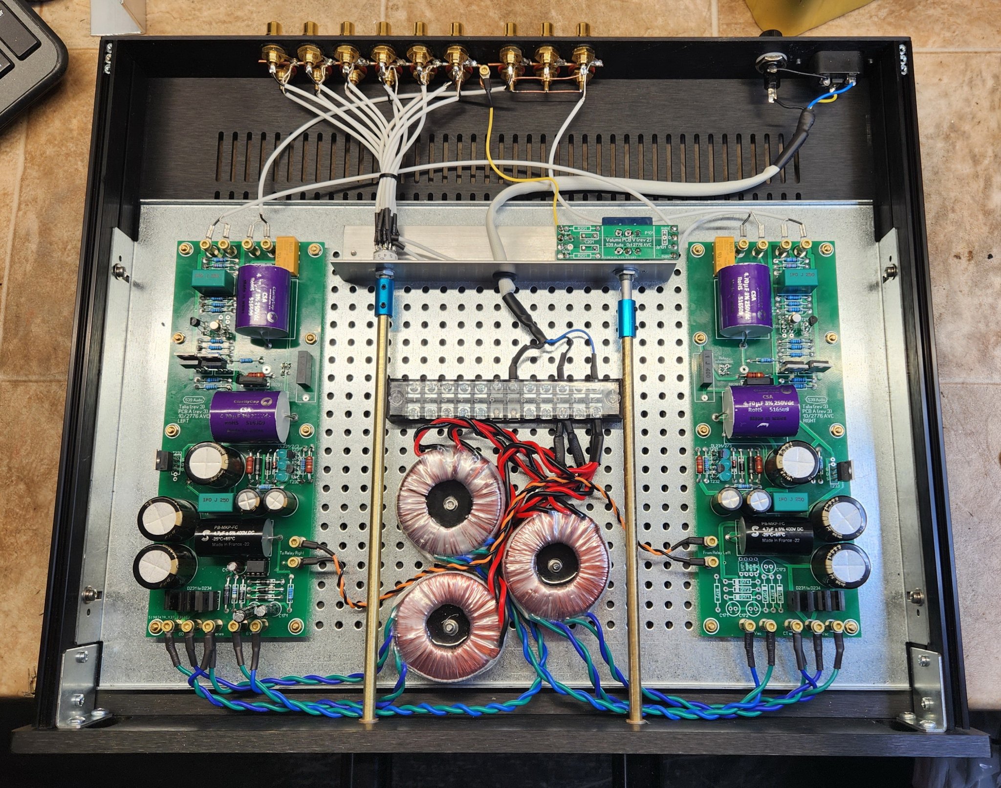

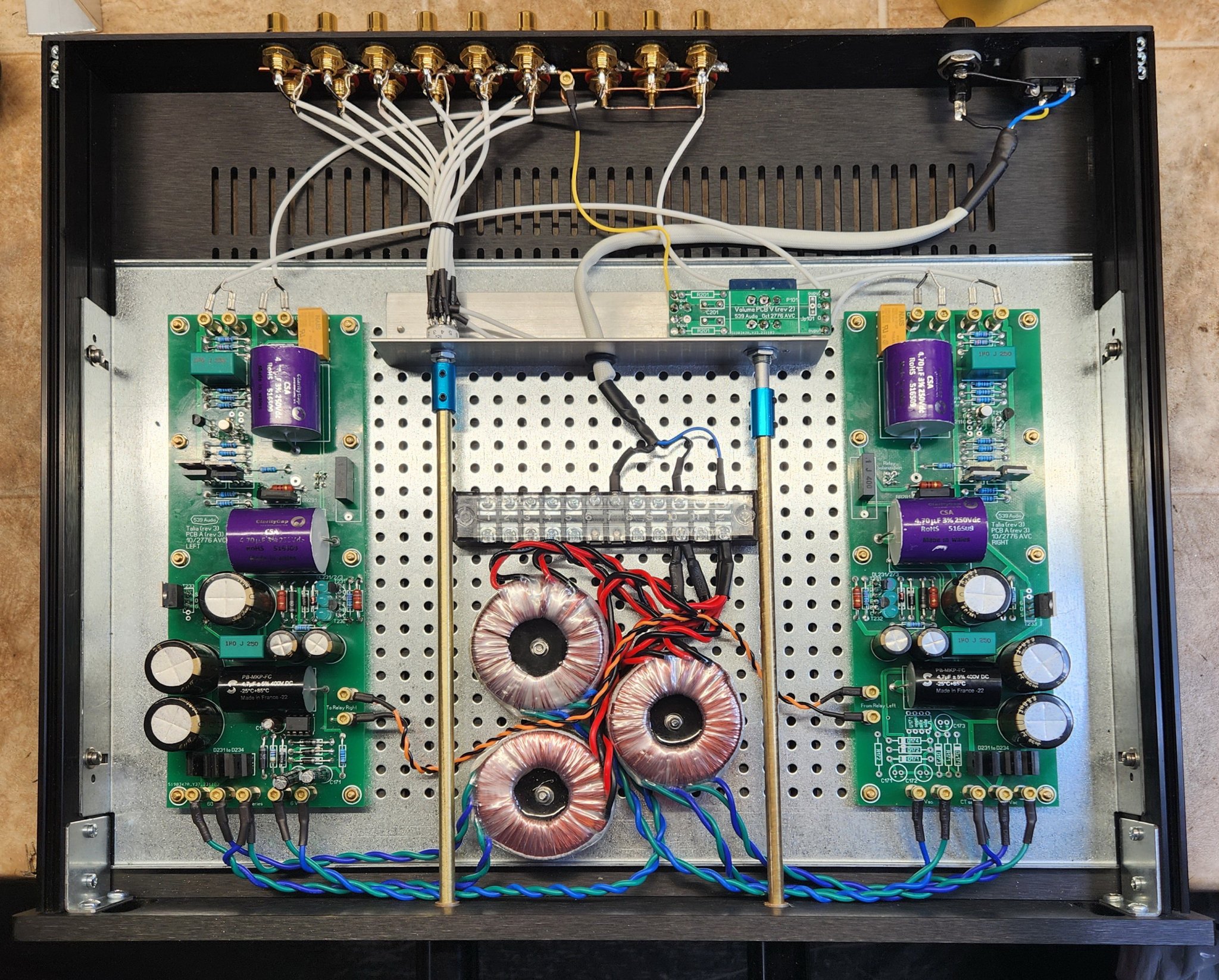

So it was time to reopen the project "Tre" without using obsolete components. I saw some of you tried to start the Tre but had to renounce it since the BF244B is tough to find nowadays. I tried to buy some, but I received fakes and BJTs.
I didn't want to trash this project, because I love it. So here is the °Talia", which uses the LSK489 as the main component. The sound is per my preferences, otherwise I wouldn't post it here.
If some of you still have the components bought for the Tre, they can use almost all of them. No need to use the fancy and expensive Clarity Cap capacitors to achieve good sound.
I've been listening to the Talia for over three weeks and I don't regret the sound of my WOTS LeGrand.
The PCB is reversible and designed to fit HiFi2000's Slim Line 350/1U. Talia is very slim.
If you are interested in this almost easy DIY, if you have some suggestions, please contact me.
If you got bored with this useless "one more post-amplifier", please accept my apologies.
Hello. I really like "Talia" preamp. Can i use MPF 102 or 2SK30? What component to be changed for MPF 102 or 2SK30? Thank you so much
I'm glad you like the Talia.
The" Tre", Talia's predecessor, was conceived around the BF244B, no substitutions worked with it. Then BF244B became obsolete, so I had to modernize the schematic to use one of the best suitable components available at this moment. It was quite a job, to have the same "old sound" I'm used to liking.
So this is Talia's project.
I do not have an answer for you (BTW the two components you said are obsolete too), I should put myself to work at the same job I did for the LSK489. You are asking for a new project!
You are here, then supposed to be an electronic expert, so you should be able to carry on the same work I did, then hear the sound and decide if you like it or not, and act consequently.
Following are the hints I can give you:
Current PCB's constraints are as follows:
- you can use almost any TO220 enhanced mosfet as a follower (I used a depletion here, just for experimentation purposes, and it fits very well);
- you can use a depletion mosfet like the cheap DN2535N5 as a CCS keeping in mind its -1.5Vgs(off);
- R217 imposes the current across the cascode T211 (Id=T12's Vbe/R217);
- you must find the correct polarization by varying R216 and R218, achieving the midpoint voltage at the value you see in the schematic with a 10% tolerance (to be refined in a second step), and last but not least, a sound you like;
- GSD pinout for mosfets;
- LSK489-like pinout for the double JFET;
- other obvious constraints due to the components to buy.

Are Ciss and Crss of the selected Mosfet and Jfet the most important parameters?
I have been following your 3 WOTS pre-amplifiers and found they are inspiriting.
AFAIK when you use a mosfet as a follower, its input capacity is very low. So I neglected mesfets' input capacity reported on their datasheets. Everything works perfectly. We must also consider that 6H30's and paralleled 6922 triodes' plate impedance is very low, so there is no hassle to drive the mosfet. The last version uses the ECX10N10, which today is the best possible power mosfet for audio. This speech is about the LeGrand E2. Talia uses a depletion mosfet as a follower, whose capacity is extremely low.
