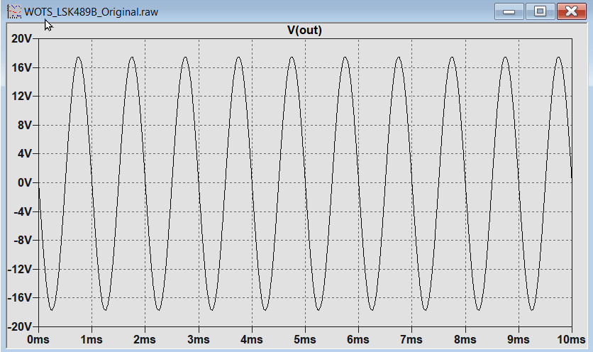

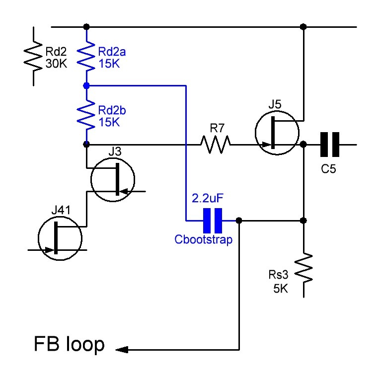

As I connect 2.2u to S of J5, the output is very lowdivide Rd2 (30KOhm) in 2 x 15KOhm and connect their midpoint to J5's source with 2.2uF or so. You obtain a bootstrap for the second stage which is supposed to lower the already outstanding THD.
