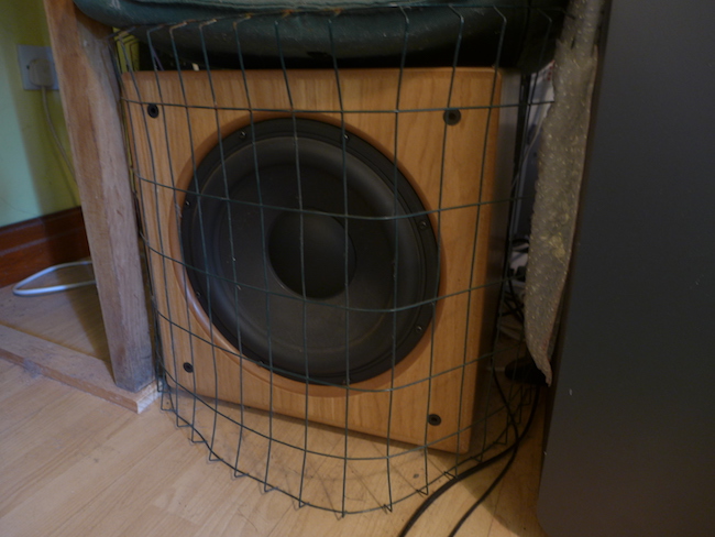

@RobWells - I'm afraid not. I spunked the big project spend on a table saw. A router for my next sub/speaker project might be on the cards though. God I'd love one, but not as much as I loved the idea of having a table saw!
LOL Btw., you'll need to do something similar with your down firing design as well. I don't know how much of a gap you have between the sub and the floor, but cats can (and will) get into impossibly tiny gaps. A wire mesh 'skirt' is highly recommended.

That's a goos shuot there... A couple of 15" grilles woild be great.
Subs will be about 100mm off the ground. Not enough for th4he godzilla beast to get under, but the little female... I suspect she might manage it. Also, is not there'es the whole "hassing a ball of fluf under the sub and randomelu claeing it to egt it oitl£
