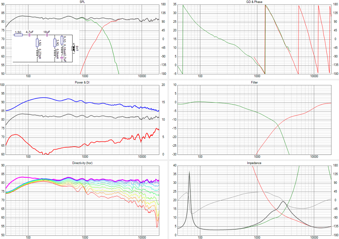

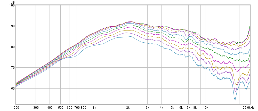

As already mentioned, large bevels around tweeter work very well for DXT. See my measurements horizontally 0-90deg.
I also attached vituix six pack for combination with SB17CAC.
