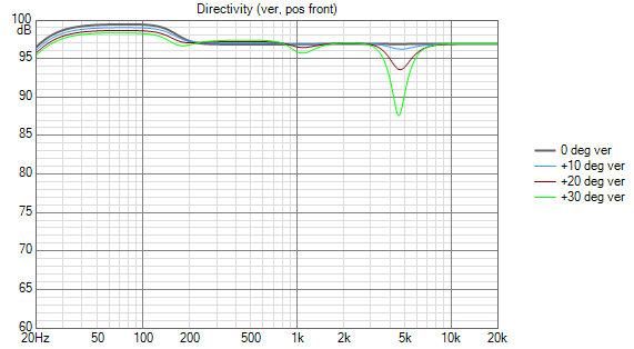

Morel tweemid TM4055-8 is a better solution.
what on earth is that 🙂 - C-C distance is approx. 62mm
directivity is way better ...but how will i fit ribbon in that 😀

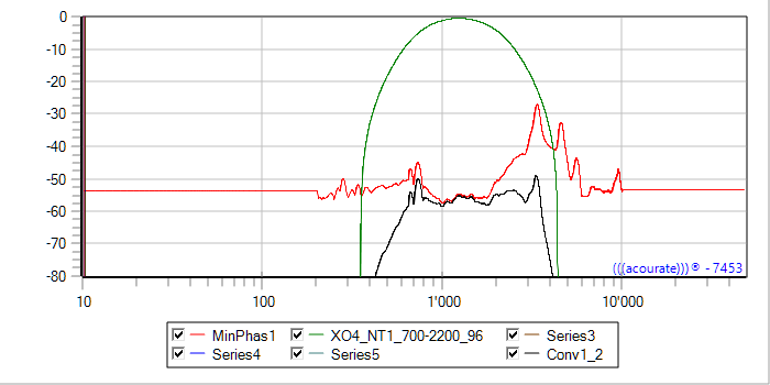

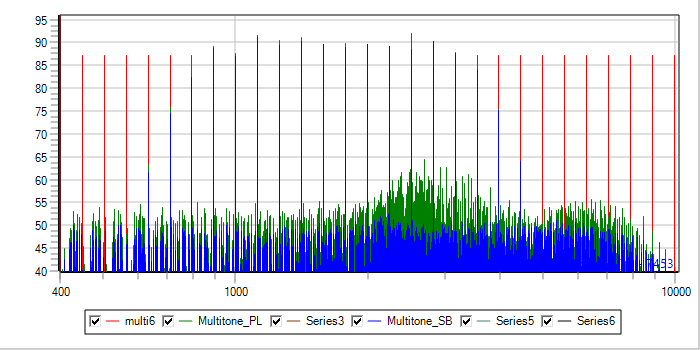

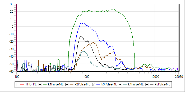

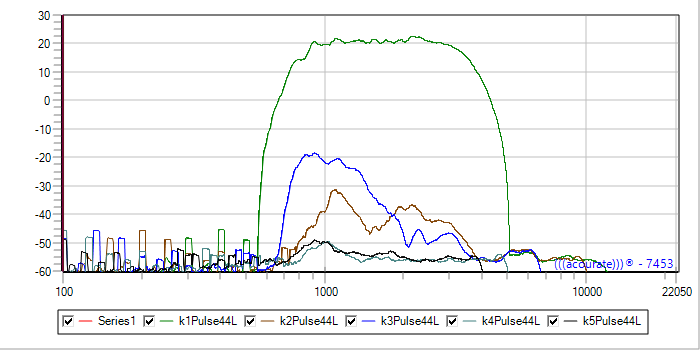

... there is a lot about regular midranges, but what about drivers that work in upper part of midrange? i'm looking for a driver that would fit in 1-4kHz freq. range and there are compromises everywhere ...

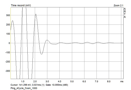

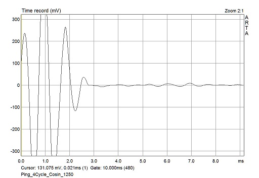

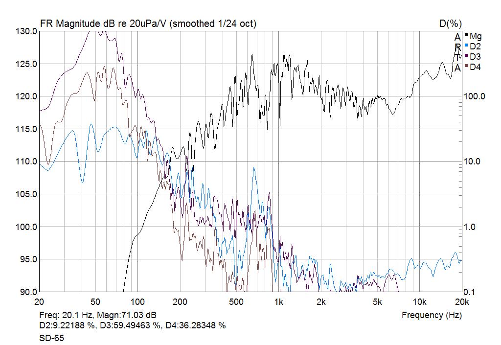

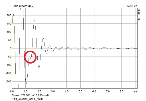

So we are up to split the midrange discussion into the “lowermid” and “uppermid” league. And maybe introduce a “midmid” flawor. Your remarks about the 1kHz … 4kHz seems is quite true to me. Because I did not find any suitable, “best” midranges for this range until now.
Let me explain: I have made experiences with a “lowermid”, a “midmid” and two “uppermid” drivers while designing an amusing myself with Horbach-Keele Arrays some time ago.

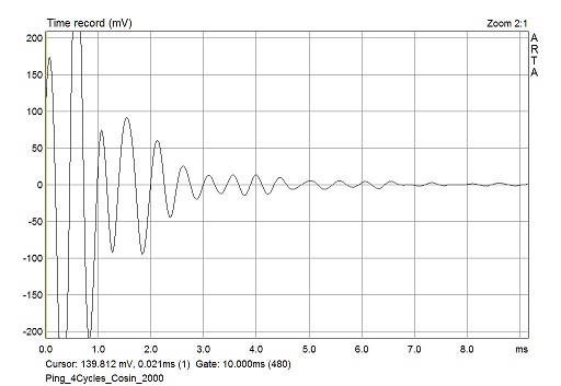

My “lowermid” was the Seas Excel W22EX001. It’s an excellent magnesium cone driver, besides falling apart to dust (Magnesium oxide) in the long term if your climate is too moist. Measuring these drivers with the cosine windowed ping-test, it became clear that it’s upper working limit was at approx. 1250Hz, which is below the THD peaking of the 3rd harmonic distorion of it’s first cone resonance at some 5kHz. This was much above what was needed from the geometry of my Horbach-Keele system, so the W22Ex was the “best midrange” at this place and suited the bill by large margin.

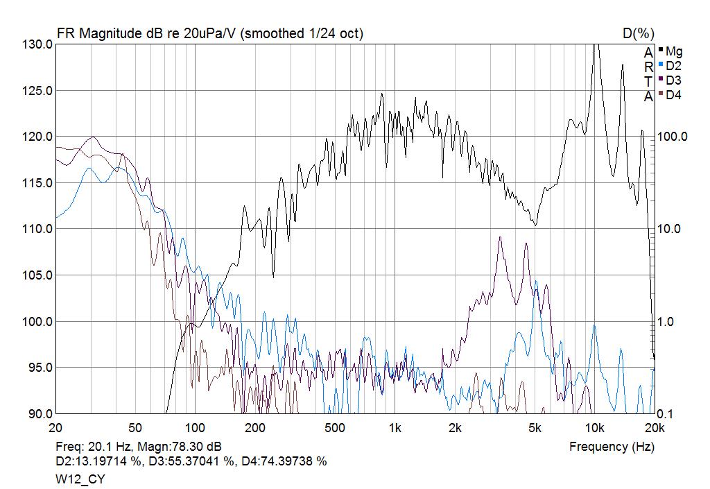

My “midmid” was a Seas Excel W12CY001. Also this driver’s magnesium cone breaks up like nasty sunday morning’s bells, threefold at 10kHz, 12kHz and 15kHz. And these resonances show up as increased harmonic distortion in the lower frequency region at f_breakup/2 and f_breakup/3 , so that this driver was finally usable only to some 2.5kHz for very best results in terms of THD. Tweaking a xover, for fun and interest, the graph relates to the best and lowest THD figures (black curve) of this drivers when driven by a NT2nd bandpass from 700Hz … 2.2kHz. Not really a broadband configuration ...
Besides this, a 2.2kHz highpass was too low for the intended tweeter SPL in my project. So let’s look for a “highermid” or an “uppermid”. The missing link? I unsuccessfully tested two of them, a decent, but still not good enough SB65WBA and a quit[FONT=Liberation Serif, serif]e awful Peerless [/FONT][FONT=Liberation Serif, serif]PLS-P830983 [/FONT]for this wished-for 700Hz … 4kHz range. Measurements in the following graphs are with a NT2 bandpass from 800Hz … 3.5kHz. Neither of them was brillant, the SB65WBA becoming really nice only at > 1.8kHz. So this was a blind alley. From today’s perspective, and in the logic of this thread, unfortunately I missed to also ABX-listen to these two drivers, because it was so evident from the measurements that the SB was of superior quality. I guess that a person with a correct Klippel score might be able to take one apart from the other because of the high amount of THD the Peerless presents.
So this set of drivers would have neccessiated a hinarious midranges multiway system with the W22EX001 from e.g. 250Hz to 700Hz, then a ridiculously narrow-banded W12CY001 from 700Hz … 1.8kHz and then an also ridiculously narrow-banded SB65WBA from 1.8kHz up to 3.5kHz or 4kHz. Messy, messy … And from 4kHz upwards the tweeter. The tweeter instead would have bee then freed of the burden to reproduce lower bands at higher levels.
My personal conclusion was that there might not be really neat and nice enough, “world best” midrange drivers for a standard multiway system. And neither for a Horbach-Keele array. Therefore and in the end I bought a pair of Quad ESL 63. And I am delighted with them. This ESL really is the best midrange I ever listened to. I guess that even Troels Gravesen would agree with that after having confessed something about his everyday home system:
http://www.troelsgravesen.dk/The-Loudspeaker-III.htm:
Troels Gravesen said:“ … It is the closest I have come to my QUAD 2812 speakers in terms of a coherent and utterly transparent soundstage - plus the dynamics the QUADs are short of ...”
Now also this one seems SHOCKING - Troels Gravesen listening to custom gear at home... But why not?
