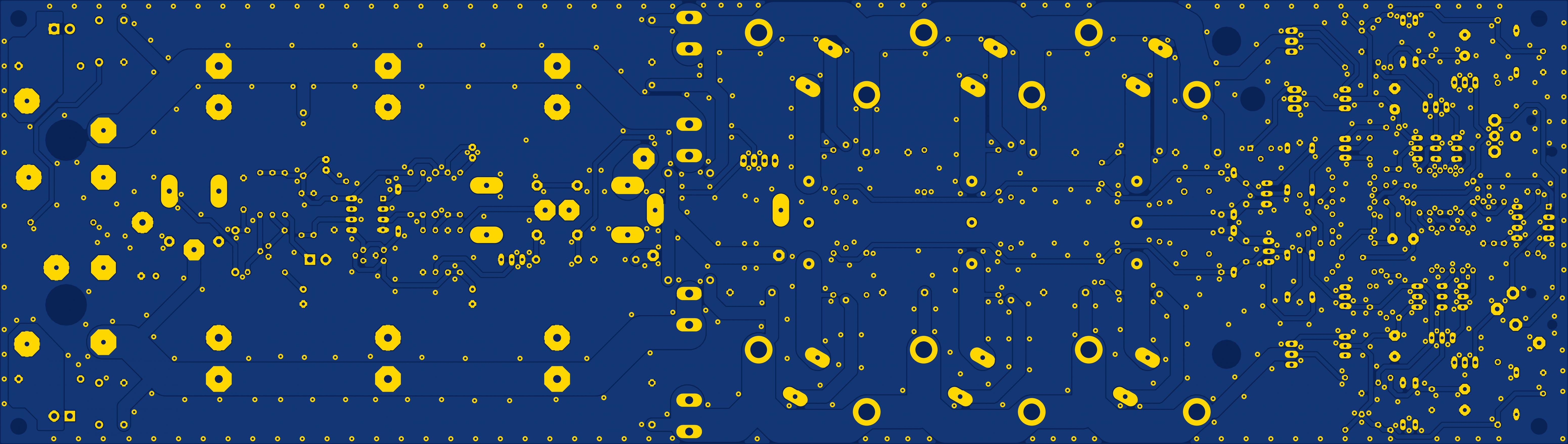

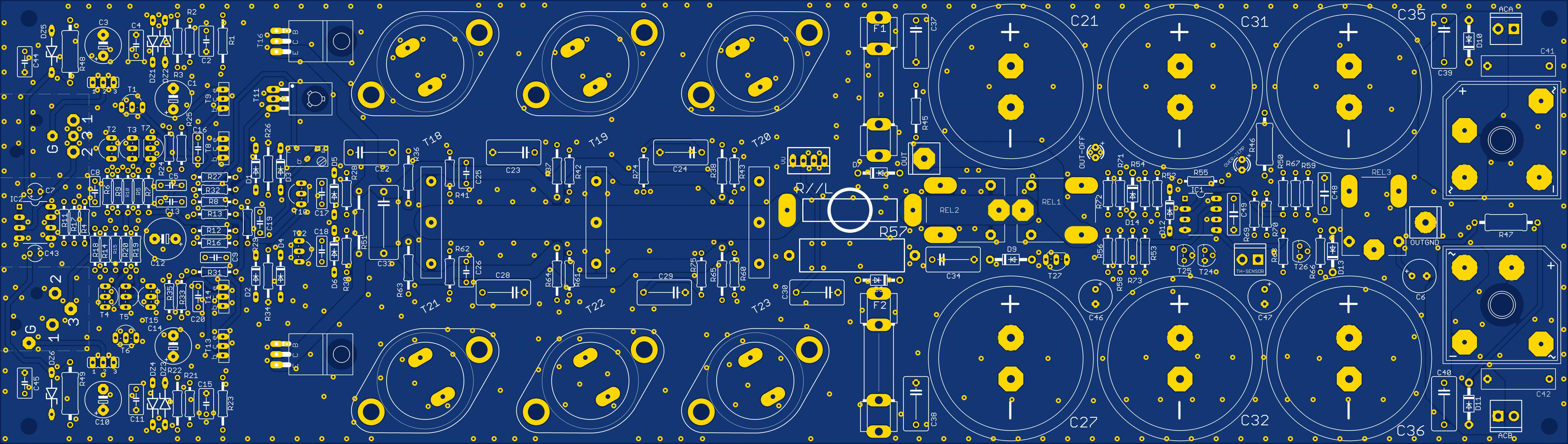

Here's the pcb and sch:
  • leachamp3pairsMJ_sch.pdf

I am doing the design from the pcb all the way to the case in every detail, so then it can be built with all the proper parts professionally manufactured. I have a good contact in china who can make all this metal stuff properly, with the laser cutting table and the whole shebang. I only need to find a good place to get the screen printing done. I will also have the aluminum parts anodized black, in the same way the heatsinks are, for a good overall impression. The theme is black, with most parts, including most screws in black color.

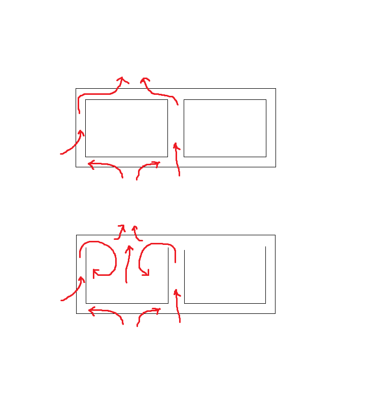

but it is also a somewhat dangerous design

might be a good idea to put a lid on the heatsinks of each amp module (inside the vented box)
The heatsinks are at ground potential, galvanically isolated from the DC in the amp, no voltage applied to them, so there is no issue there, and no hands can go inside touching the transistor cases, which do have potentially lethal voltages, unless someone purposely opens the case and goes fooling around inside, but then there is nothing to do about such stupid behavior.
There is a lid, full of hole, just because it must breathe. There is heat to evacuate all over and the more air flows, the better. It would be a pitty to block that air flow.
Now if you are thinking about someone dropping some tiny metal part through the vent holes on top of the pcb, then it's true this could cause an issue, but who would find something that small and metal, that could pass through those holes, and who would go drop it there? Unless it's done on purpose, I don't see why this would happen in normal use.
Plus, why also block the view from all that electronics inside? That too is a sight that I like in the amp. Seeing the guts of it is a plus to me 🙂😀
that was my main concern, yes
imagine yourself bending over your amp, and dropping a small solder bit from your clothing 😱
when using amp for PA/instrumnet I might have a bad habbit of placing various things on top of it 😱
but could be anything really ... never dropped a component, like a resistor, or a screw ?
anyway, venting would not be limited, but maybe even improved
here is what I 'expect' the convection will look like, with and without the 'inner sub lids'
its about controlling air flow to avoid possible turbulent chaos
I see what you mean, but then the central area above the pcb would no longer have convection and would be enclosed.
Only a "hacker" messing around with tools and soldering iron over the amp could drop something in those vents. I doubt in the field when putting amps in a rack and during their use there would be any chance of small bits of metal falling inside the amp. It's so unlikely that I would prefer leaving the air flow than block it from flowing.
I've seen so many diyers making good looking layouts, big heatsinks, and then enclose the whole thing in some wooden box with hardly any air circulation...
In this design, I make use of the inner room to have double the heatsinks. Of course the convection won't be the same between the inner sinks as it is for the outter sinks, but I think this should work anyway. Short of going forced convection, this overdesign should ensure some level of reliability. As long as any pcb layout related considerations have been addressed.
I want to aim for the best layout possible, so I am open to suggestions that help in all respects this layout.
no, you could have increased airflow coming through the ends of each amp module
but basicly, route the air between the heatsink towards the top of heatsink, and the air escaping there will increase the outside airflow at fins
and that is also where it really makes a real difference
the inner side of the heatsink is not very effective, only the fins are
so basicly you want the inside 'trapped' air to escape such that it 'supports' the outside airflow
There is no gap at the end of the modules on the input side, as the edge of the module butts against the back plate, for the XLRs to poke through. And on the front side near the vu-meter, the gap is small, mostly to let the few wires from the transformer come through and leave a little air come in to cool the small heatsink placed on top of the rectifier bridges. The distance between the ends is about 40cm, so that is a very long way for air to flow.
I'll output a top view of that area so you understand how it's layed out inside that case...
