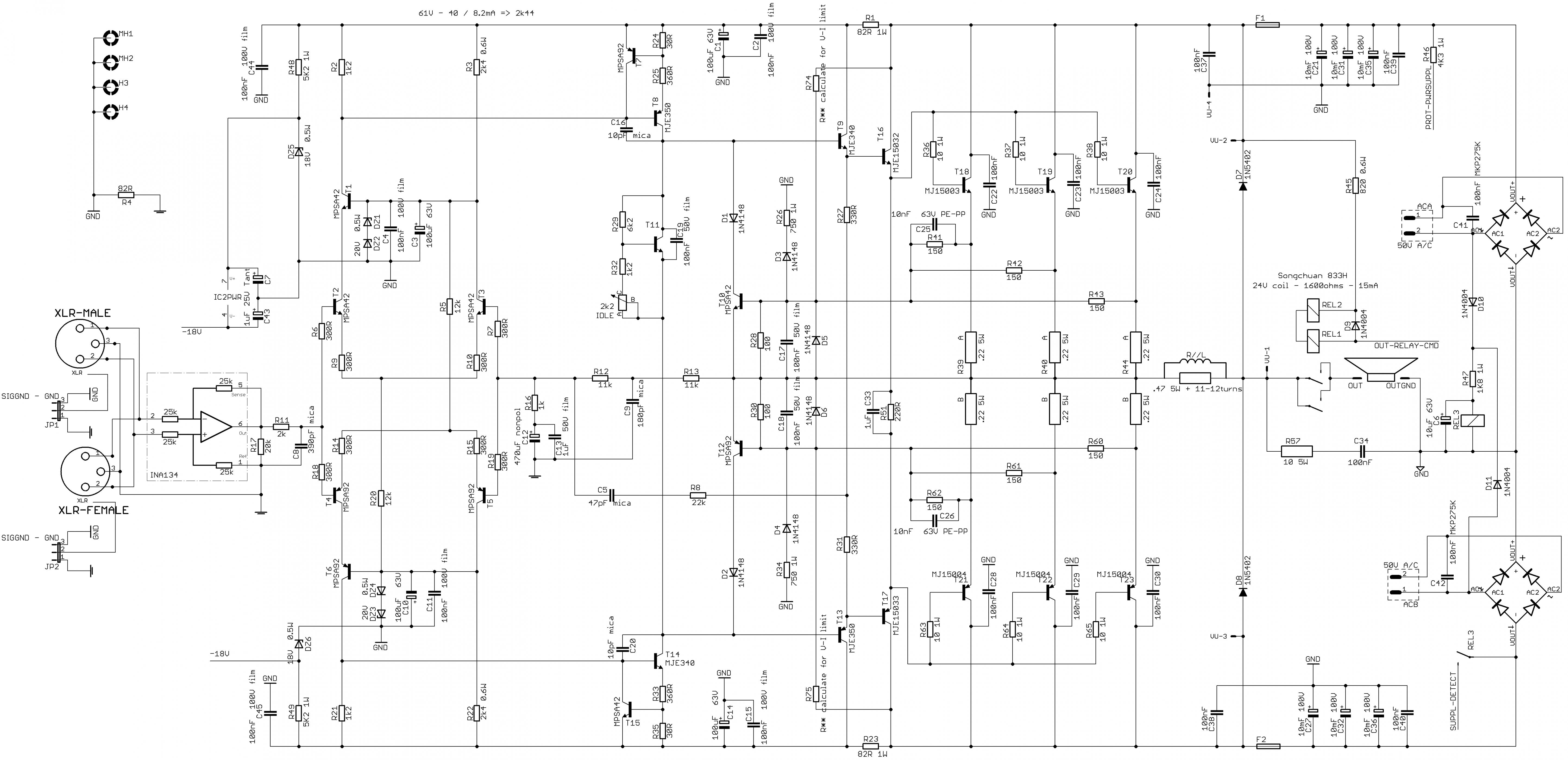

Here is an updated schematic with some of the protection resistors calculated.
I've been busy on other things, so this one advances a little slower, but I just ran most of the calculations on those protections and I wouldn't mind getting some feedback about this.
The resistors R41-43, 60-62, and R28/30/26/34 are the ones in question. And I still don't know how to proceed about the R74/75 ones.
Any hints welcome.
Any hints welcome.
The relays will be the SongChuan 833H, with a 24V coil.
If that is a protection relay, it looks totally inadequate with a contact
rating of 7A/ 30VDC for such a powerful amplifier.
