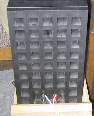

noisenyc said:b&w has been doing an "egg crate" style bracing
Each one of the squares is an approx 4" tall pyramid on the inside of the box.
dave

Da5id4Vz said:Is that the B&W?
Looks intersting.
Whats it made of?
DM302... plastic
dave
