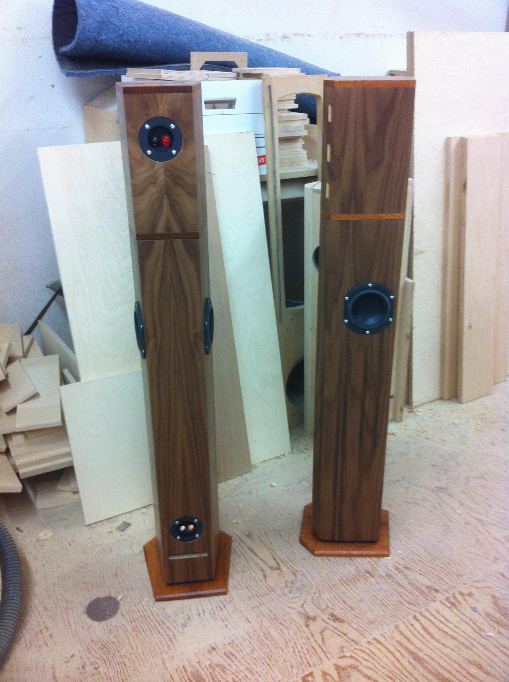

isn't that a pair of W14s in the trapz MTMs? they certainly work quite well in the "ken" style vented enclosure - although those are modest enough size to not provide adequate height to act as a stand themselves, but something like the dual 830870s for FF85WK might work?
As pictured, approx 860mm for the woofT section, and with the upper enclosure inverted, the FF8WK was targeted to center at 1000mm

After listening to the succession of dual and quad driver woofer arrays during the past year or so, I'd be very interested in a larger size push/push MLTL with the W14s - a helluva performer for the price.
Twin W14s fit nicely in an ML-TL woofT with internal height of 838mm. Tallish, you'll need to flip the dMar-Ken7.3 upside down.

I guess port size would need to be quite big, about 4"? And would the width/depth be the same as the kens, 239 x 227?
Vent is not all that big. A fullwidth slot on the back. Footprint is the same as your Mar-Kens.

as with the walnut uwoofT/FF85WKs
it took almost as much time to align grain match/wrap the veneer on those 4 boxes as to build
almost, 😉
