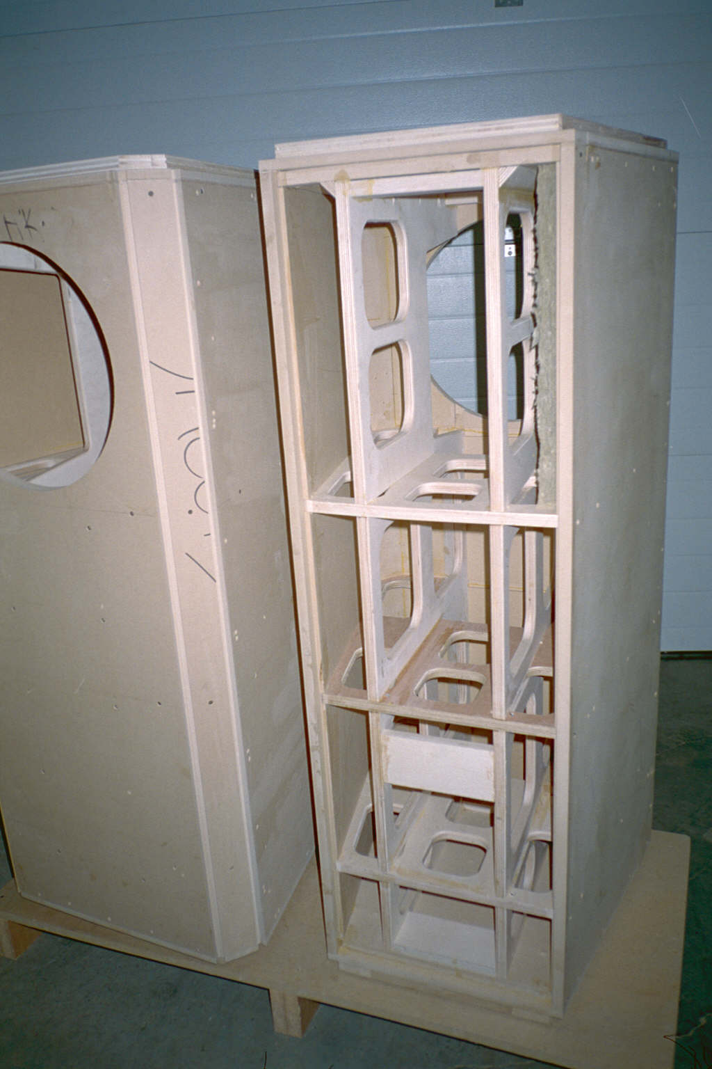

Ref the vents are they to take the same size and format as the dmar-kens or a round port/tube?
Also, is a full height internal brace like the dmar-kens best used?

In general, our own approach re bracing is - when ever possible, cross brace opposing panels (with uneven spacing) and interlock on larger enclosures
of course one could get carried away 😉
As to the venting - high aspect ratio slots might be less important acoustically in woofers than in wide-band enclosures such as the MarKens, but in the interest of aesthetic continuity, why not? 😀
The vent on the woofTs (in these last 2 cases) are slots at the back/bottom, loaded by a vertical vent shelf up the back.
Chris, what are those? Something for Mr Sidney?
dave
dave
carcass for Tannoy 15" Dual Concentric - aka the Churchillian fridges
aka Charity Cases.
