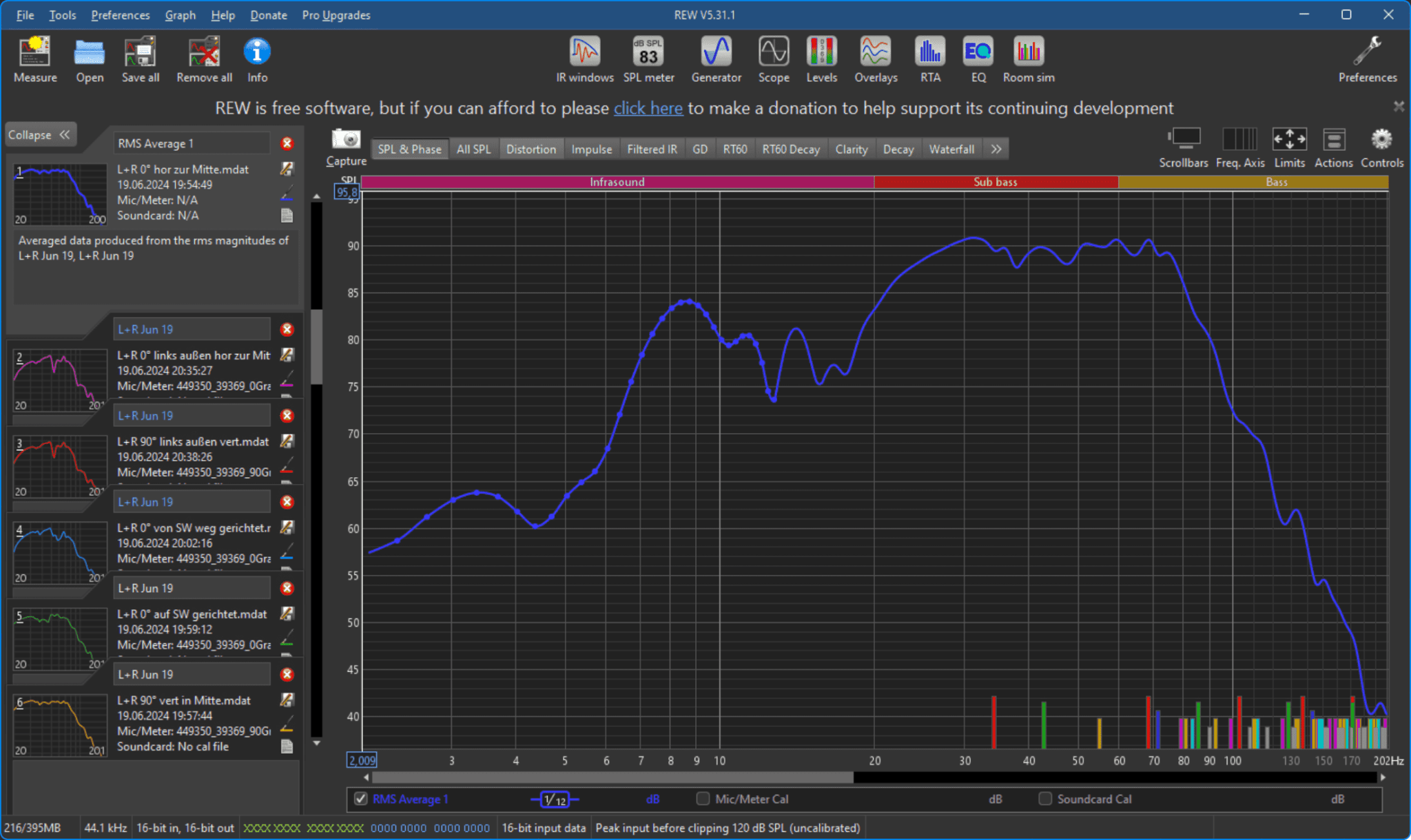

I grasped the Hypex software, it wasn't that difficult. The crossover (now 10Hz/24dB highpass and 80Hz/48dB lowpass) and DSP for the subwoofer are now running on the Hypex amp alone. I have also equalized the dips in the frequency response and compensated for the necessary digital signal attenuation (so as not to exceed digital zero) with the gain control at the input of the Hypex amp. This works very well and so the digital resolution of my main DAC is not affected.

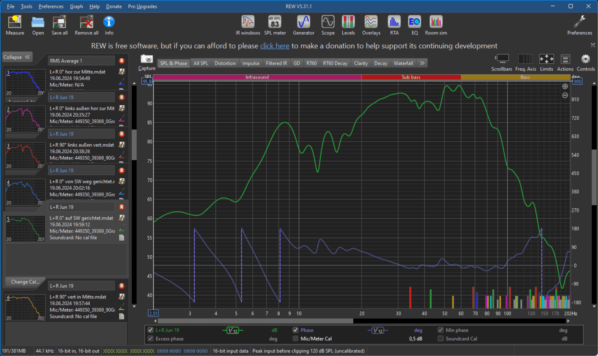

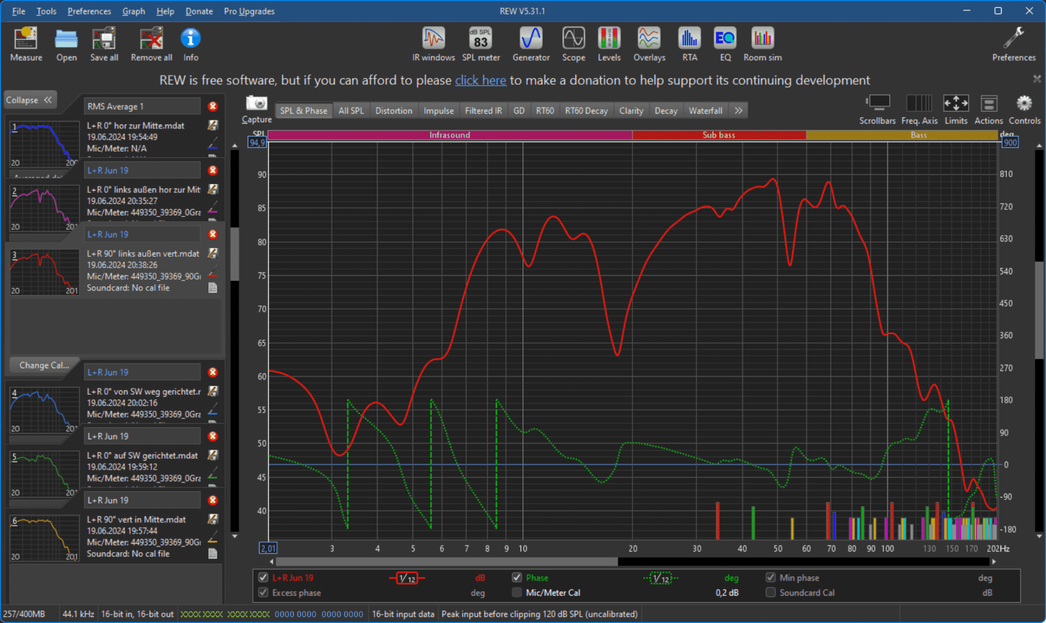

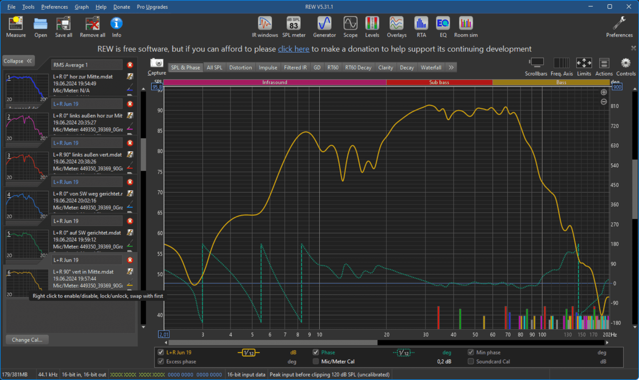

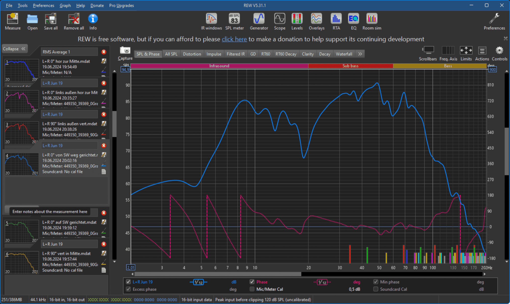

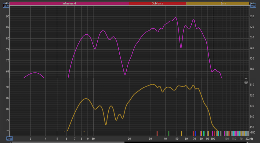

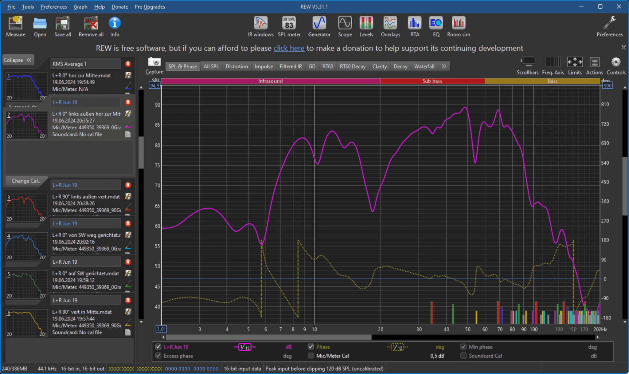

Here are a some measurements for the sub alone. I'm not sure which microphone orientation is the right one for my particular listening situation. The most plausible way seems to me to be the average value from a measurement in the head position with the microphone vertical and a measurement on the left and right with the microphone horizontal to the center, i.e. pointed directly at the ears at a distance of 20 cm from each other. This average is therefore the basis for the EQ and the resulting measurements up to 200 Hz.
Mic horizontal, pointing like straight to ears, 30 cm distance to sub, average from two measurements with the microphone horizontal to the center at a distance of 20 cm from each other
Mic vertikal, like in middle of head, 30 cm distance to sub (virtually no difference to the previous one)
Mic horizontal pointing straight to sub, 30 cm distance
Mic horizontal pointing straight away from sub, 30 cm distance
Mic horizontal, like sitting on outer left of sofa with right ear pointing to sub, 70 cm distance
Mic vertical, like sitting on outer left of sofa with right ear pointing to sub, 70 cm distance (virtually no difference to the previous one)

The orientation of your Beyerdynamic MM1 omni mic only makes a slight (2dB) difference at 20000Hz, no difference at all below 5000Hz:
The mic capsule positioned center between where your ears are in your usual seated position would be a good target.
Nice position choice, the center couch sub response looks great!
With a +3dB lift ~ 25Hz, move the HP up to a BW24 ~20Hz, voilà: +/-2dB 25-75Hz.
The L/R couch sub response ~ -6dB on average, about the expected near field inverse distance drop from 30-70cm. Moving the couch a bit further from the woofsorber would reduce the variation a bit, though might screw up the center response.
What EQ filters were used to remove the dips in the frequency response ?

There will certainly be enough days with shitty weather this summer to fiddle with REW. Enough for now ...
The filters:
F Q Gain
35,40 18,29 -07,55
43,40 04,99 -15,90
49,80 17,65 14,87
55,00 20,00 -05,55
57,70 11,20 12,72
69,90 04,99 -15,90
71,90 13,63 10,38
89,90 14,56 15,00
99,70 04,99 -15,90
