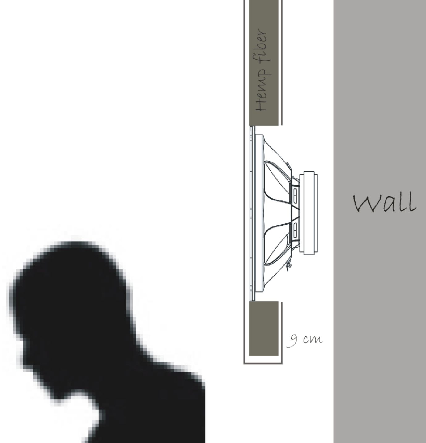

For days I've been racking my brain over all the possible (and impossible) options for a subwoofer for my particular listening situation. The room is unfavorably dimensioned and the neighbors are sensitive. So I think about how to minimize room excitation.
My latest brain fart looks something like this: An DSP-driven (so with appropiate equalisation and delay) open-baffle woofer (for example https://www.sbaudience.com/index.php/products/open-baffle-drivers/bianco-12ob150/) about 20 cm behind my head, integrated into a large absorber attached to the rear wall with 9 cm spacing.

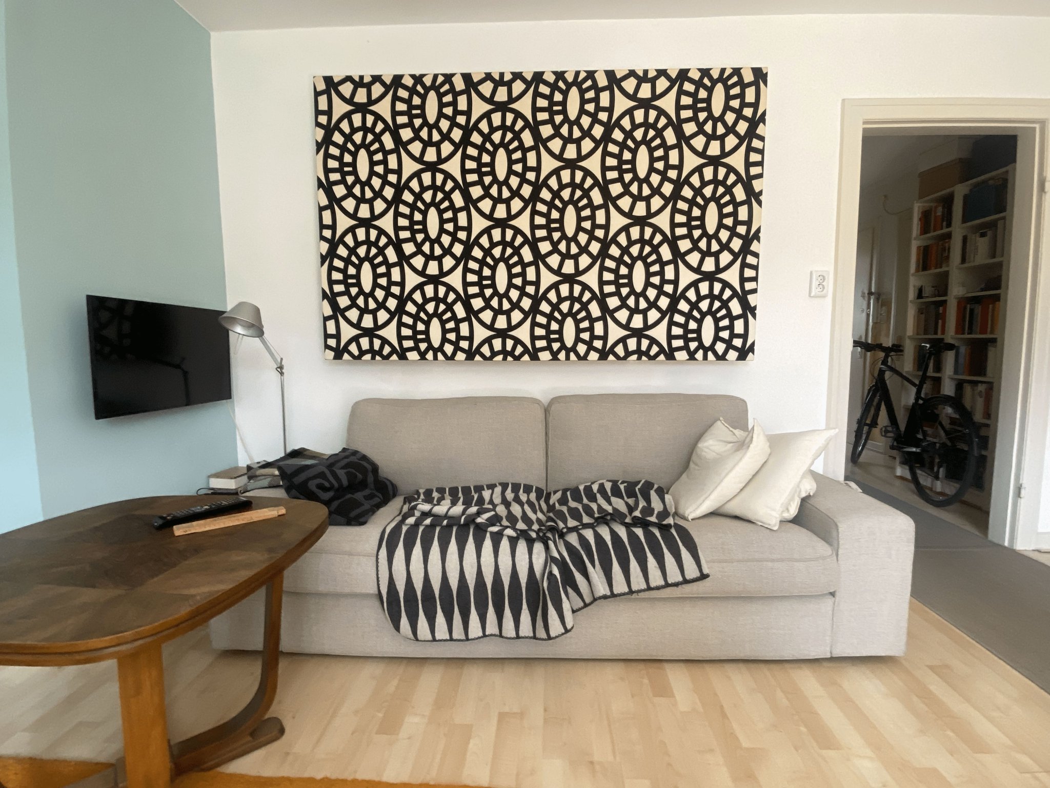

The absorber consists of a 6.5 cm thick wooden frame covered with canvas on both sides. Behind the canvas are 5 cm thick hemp fiber insulation panels. My idea is to integrate the woofer into the absorber behind the front canvas so that it is as solid and vibration-free as possible (I haven't thought about the details yet).
I practically never listen to music louder than about 80 dB, so the woofer shouldn't experience much excursion.
In principle, what do you think of my idea - worth a try or nonsense?
![sofa und absorber.jpg sofa und absorber.jpg](https://www.diyaudio.com/community/data/attachments/1219/1219566-9ec49da4766b36032a1f8ce6c489cb97.jpg)

![Woofsorber.jpg Woofsorber.jpg](https://www.diyaudio.com/community/data/attachments/1219/1219565-078506d20c3e21105512e14602c27e6c.jpg)

Sounds good to me, maybe with some tweaks. The hemp fibers will not really absorb low frequencies but that does not matter. Your idea essentially is a dipole souce, with a dipole spacing of roughly 20 cm. At much larger distances, a dipole is an inefficient radiator. The front and rear contributions of the woofer have equal levels and they mostly cancel. There is no full cancellation, because of the difference in path lengths and therefore phase.
At much smaller distances however, the path length differences are relatively large. That mean that the front contribution is louder than the rear contribution - they do not cancel! More bass for you - or less for the neighbours.

The vibrations transmitted into the wall have a good chance to bother your neighbours. You could either decouple the woofer from the wall, by suspending the wooden frame in springs, or you could actively counter the vibrations with a bass shaker, as done in the Sunfire Subrosa.

I agree with TBTL's comment on the hemp not really doing much - passive sound reduction for lower frequencies/longer wavelengths requires significantly large structures if you're trying to absorb the sound.
The "best" solution, if you really want something loud for yourself but not for the neighbours, would probably involve 3 or 5 woofers arranged in a line (if 3) or in a plus shape if 5. The central firing woofer would be in phase with the others out of phase and attenuated. You'd get a thin/narrow lobe beyond which the sound would quickly die down. But woofer costs might become an issue.
A partial solution to this, would be to fold the back output of the single driver towards the front and bring it in from 2 opposite sides (like the 3 driver solution). You wouldn't need more than 1 driver, however there may be resonance issues, and you may need to be careful with the frequencies being fed to avoid it turning into a horn of some sort.
Btw I'd suggest looking into the ripole (also mentioned in the thread linked above), you can modify the side at which it is open to suit your cancellation needs. I'd also suggest playing around with simulations to make sure you're getting what you want, and how strong you want. Stronger cancellation = potentially quieter sounds/quicker drop off, and humans needs a lot of sound pressure for bass to sound even medium-loud (Fletcher-Munson graphs).

Sure. The absorber was never designed for this. I installed it long ago; it only serves to attenuate the reflections from the rear wall.Sounds good to me, maybe with some tweaks. The hemp fibers will not really absorb low frequencies but that does not matter.
Roger that.Your idea essentially is a dipole souce, with a dipole spacing of roughly 20 cm. At much larger distances, a dipole is an inefficient radiator. The front and rear contributions of the woofer have equal levels and they mostly cancel. There is no full cancellation, because of the difference in path lengths and therefore phase
Interesting stuff - food for thought. But my ideal situation is to manage without any additional boxes in my living room - that is the core of my considerations.Edit: I see I have written about this subject before. Check this post.
Well - I have made a calculation based on my average listening level:The vibrations transmitted into the wall have a good chance to bother your neighbours. You could either decouple the woofer from the wall, by suspending the wooden frame in springs, or you could actively counter the vibrations with a bass shaker, as done in the Sunfire Subrosa.
In order to achieve 75 dB at a listening position 2.5 m away, the main loudspeakers have to produce about 83 dB at a distance of 1 m.
To generate 75 dB at a listening position 0.2 m away, the woofer in the absorber must generate around 61 dB at a distance of 1 m.
The cone movements and thus the mechanical excitation of the absorber construction attached to the rear wall with only 3 narrow steel brackets and the wall behind it should therefore be very low. Moreover, the rear wall is located inside my apartment and does not border on the neighbor's apartment.

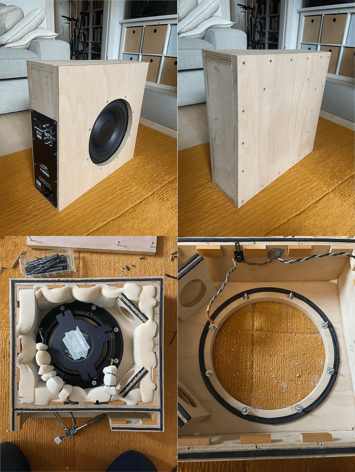

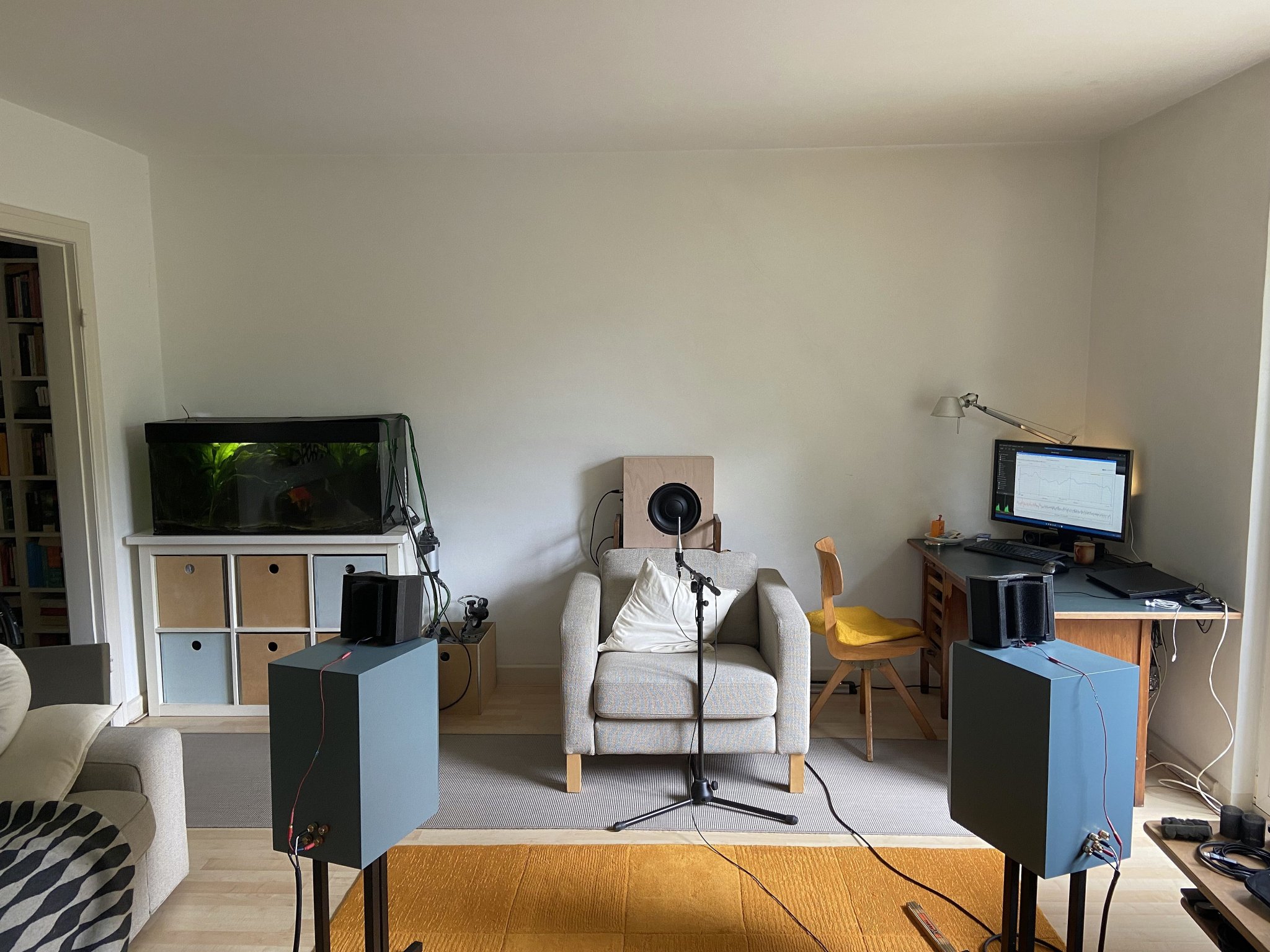

What has become of it so far? For now, a subwoofer that I can use in other ways if necessary:
An SB Acoustics SW26DBAC76-8 in a volume of approx. 10 liters powered by a Hypex FA251. The cabinet is made of 18mm beech MPX. The size is 42 x 42 x 13.6 cm, just finished (not yet sanded) and therefore still untested. More on this soon ...
Try lowering the box, you might prefer it that way. It looks like you could even experiment with under seat positioning.
Nearfield subs will give you some of the cleanest bass you have experienced and they won't annoy the neighbors nearly as much as a conventional placement.
