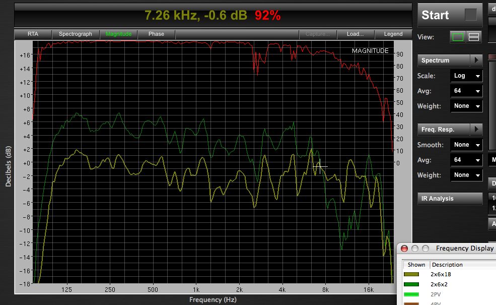

Having done an outdoor test to confirm just that, the results are posted below.
The test used one and two full range cabinets, both placed on speaker stands , tweeters at about 2 meters high, pointed at a mic on a two meter high stand at two meters distant, the tweeters and the mic making a (roughly) equilateral triangle.
There was a 6 dB level increase using two cabinets up to 1.6 kHz, then the level increase drops to no increase at 7.26 kHz, and various amounts of gain or loss above.
The reason the summation was not 6 dB all the way out to 16 K is threefold:
1) The speaker stands were on uneven ground, resulting in slightly different angles and path length to the microphone.
2) The two speakers have minor deviations in tweeter frequency and phase response.
3) Wind plays havoc with high frequency response when the sources are separated as they were in this test.
Even with the above problems it is clear that mutual coupling, summation, or whatever one chooses to call it, works at all frequencies, and is not dependent on directivity, which can affect whether 6 dB per doubling of speakers occurs.

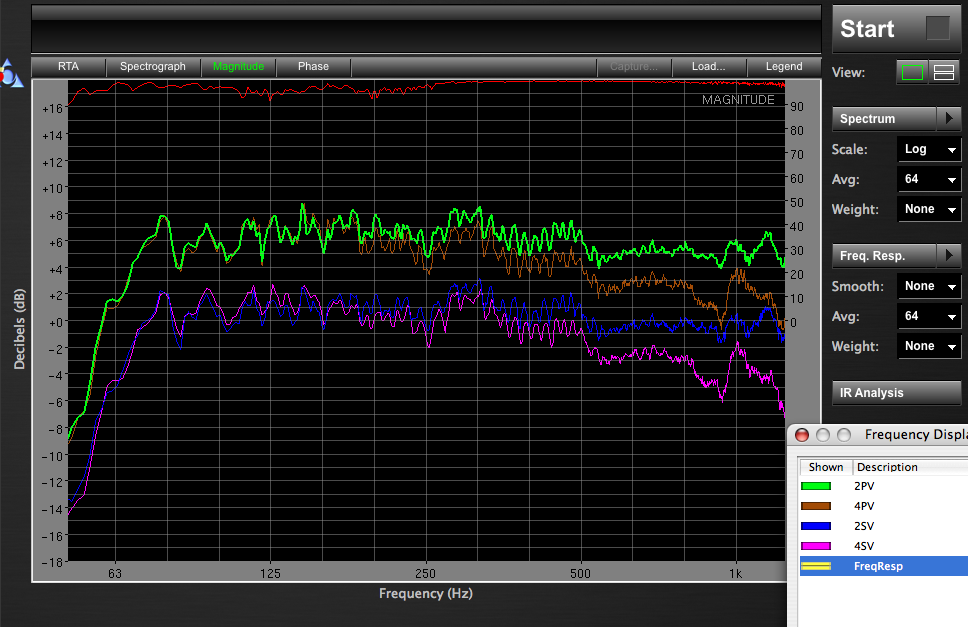

The results of the tests I made using Eminence Alpha 8 in series show none of the problems you mention regarding speakers in series.
http://www.diyaudio.com/forums/subwoofers/204472-multiple-cabinet-combined-response.html
The tests below were done with the same stage monitor cabinets. Each cabinet consists of two 8 inch woofers in series with a passive crossover and a tweeter between the woofers.
Cabinets were vertically stacked two and four high, 22.5” and 45” vertical height.
The same pink noise signal was applied in all tests, no level variation.
The difference in response above 300 Hz is due to directivity change from the vertical array, identical whether series or parallel.
The differences below 300 Hz are on the order of 1/4 dB, track the individual pairs of cabinet differences, and are virtually identical for both the parallel and series tests, proving that wiring in series does not cause frequency response aberrations.
The green trace is two cabinets in parallel, 8 ohms nominal.
The brown trace is four cabinets in parallel, 4 ohms nominal, trace lowered by 6 dB to show how frequency response is unchanged.
The blue trace is two cabinets in series, 32 ohms nominal, the lavender line is four cabinets in series, 64 ohms nominal.
If two (or more) speakers have grossly different response to start with, their combined response will generally be poor whether wired in series or parallel.
If speakers are reasonably matched, either wiring series or parallel (or series and parallel) can be equally useful.
Art Welter
Reactions: Hydrogen Alex
