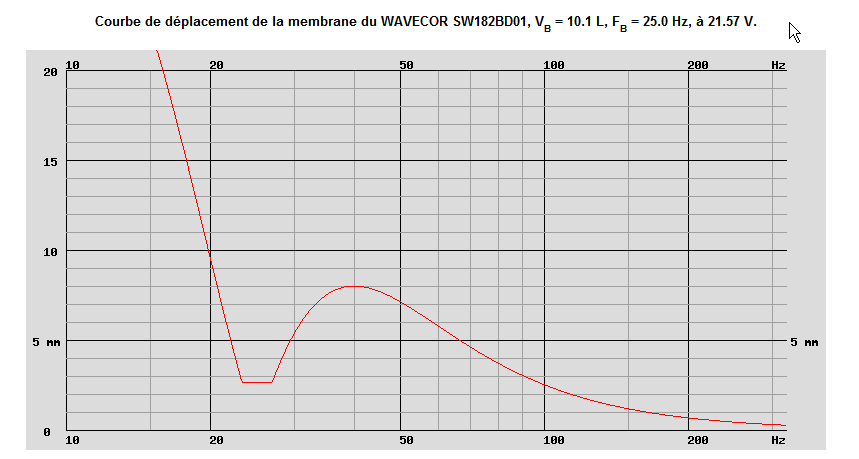

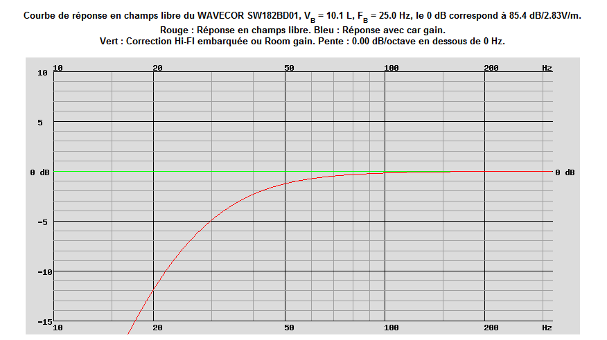

WAVECOR SW182BD01, VB = 10.1 L, FB = 25.0 Hz, le 0 dB correspond à 85.4 dB2.83Vm.
F3=37 Hz, F6=28 Hz, F12=20 Hz
WAVECOR SW182BD01, VB = 10.1 L, FB = 25.0 Hz, à 21.57 V.
http://www.wavecor.com/SW182BD01_02_specifications.pdf
