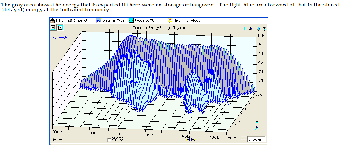

If you have or can borrow an Omnimic setup, you can get a graph of shaped toneburst envelopes (energy storage) over any range of bands in a waterfall format, calculated from impulse response...that's for measurement, not a simulation. Might not be what you wanted.
Not what I wanted but highly interesting regardless. Maybe time to finally get an Omnimic that my buddy has been bugging me to.
