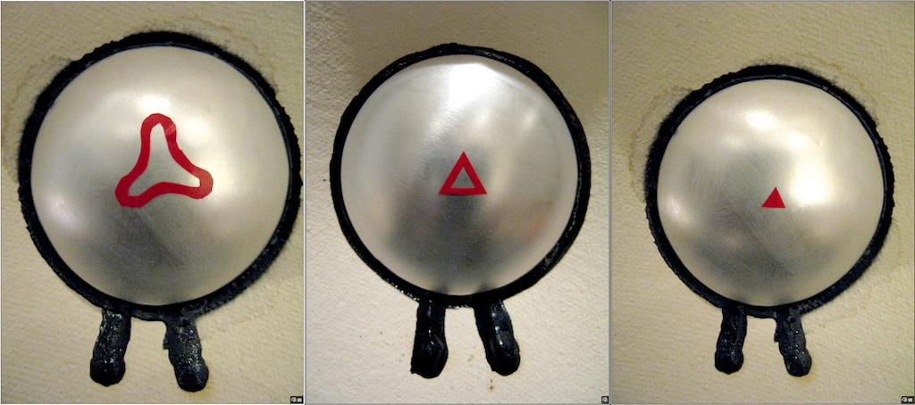

Regarding dustcap resonances, here is an interesting trick I discovered with electrical tape:
https://www.diyaudio.com/community/threads/dust-cap-damping-with-caterpillar-tape-hump.355080/
In the past I also have used electrical tape to model - though not at the creative level of the hump! 👍Regarding dustcap resonances, here is an interesting trick I discovered with electrical tape:

Yes, I've tried small shapes of tape on different parts of speaker cones and there is usually very little effect unless you cover a large part of the cone. You need something of comparable stiffness to the cone itself but with a high tan delta or damping factor. Or in some cases just something heavy that can shift a bending mode. You may have gotten better results using much larger pieces of tape.
In that sense EnABL is somewhat benign in that it doesn't seem to affect the measured speaker behavior much. So it's less risky to try than say cutting slits in the cone or heaping on the mod podge.
Yeah, those little pieces of tape were just to understand what was going on - whether pure mass was the solution or whether cancellation was also in order. Both were appropriate, and the final result was very well behaved.Yes, I've tried small shapes of tape on different parts of speaker cones and there is usually very little effect unless you cover a large part of the cone. You need something of comparable stiffness to the cone itself but with a high tan delta or damping factor. Or in some cases just something heavy that can shift a bending mode. You may have gotten better results using much larger pieces of tape.
