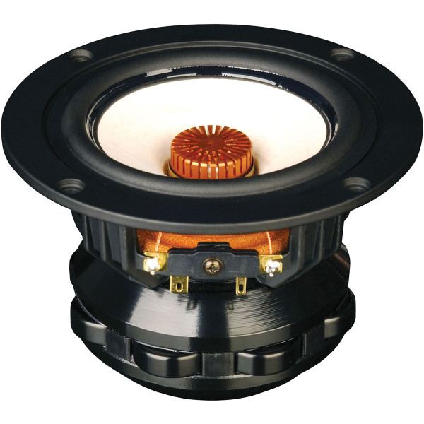

An alternate take on phase plugs was done by Decware which experimented with a resonant cavity in the phase plug
https://www.decware.com/paper46.htm
If I am allowed a personal opinion I don't really want a resonator built into my speaker, It's all we can do just to stop the cone from flapping around. But, I would eagerly listen to this speaker and see for myself if I had the opportunity.

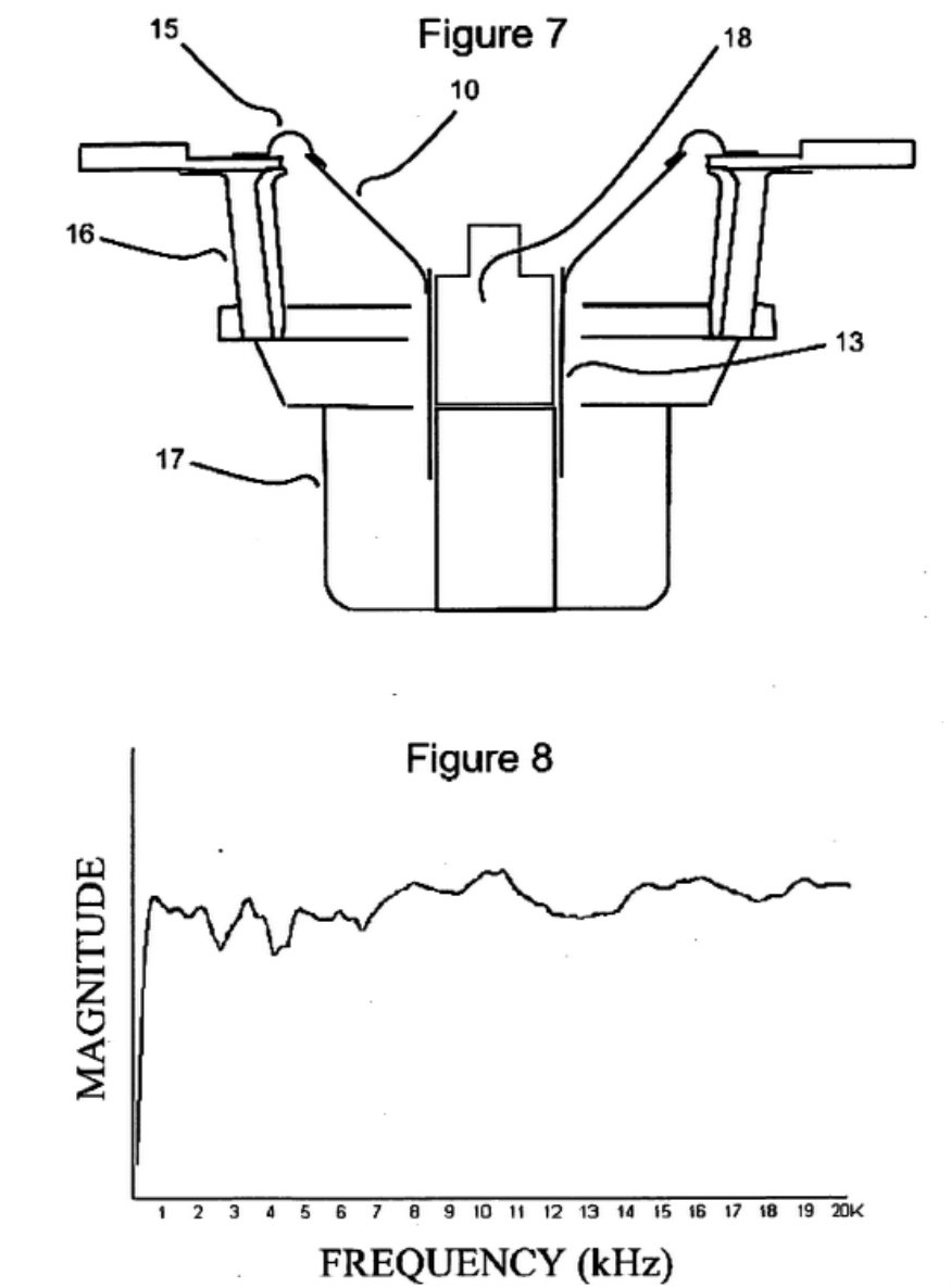

A very different take on phase plugs is given by Mark McKenzie in one of his patents. This is very interesting to me as it demonstrates application of acoustic theory to the design of a phase plug for woofers. I'm not sure of the boundary layer acoustics he speaks of, although it resembles the discussion on the Decware plug.
https://patents.google.com/patent/US20070297638A1/en?inventor=Mark+McKenzie&page=1
Mark makes some interesting comments on phase plugs when he first mentions his patent US20070297638A1:

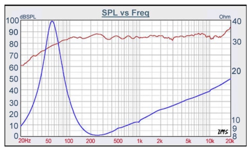

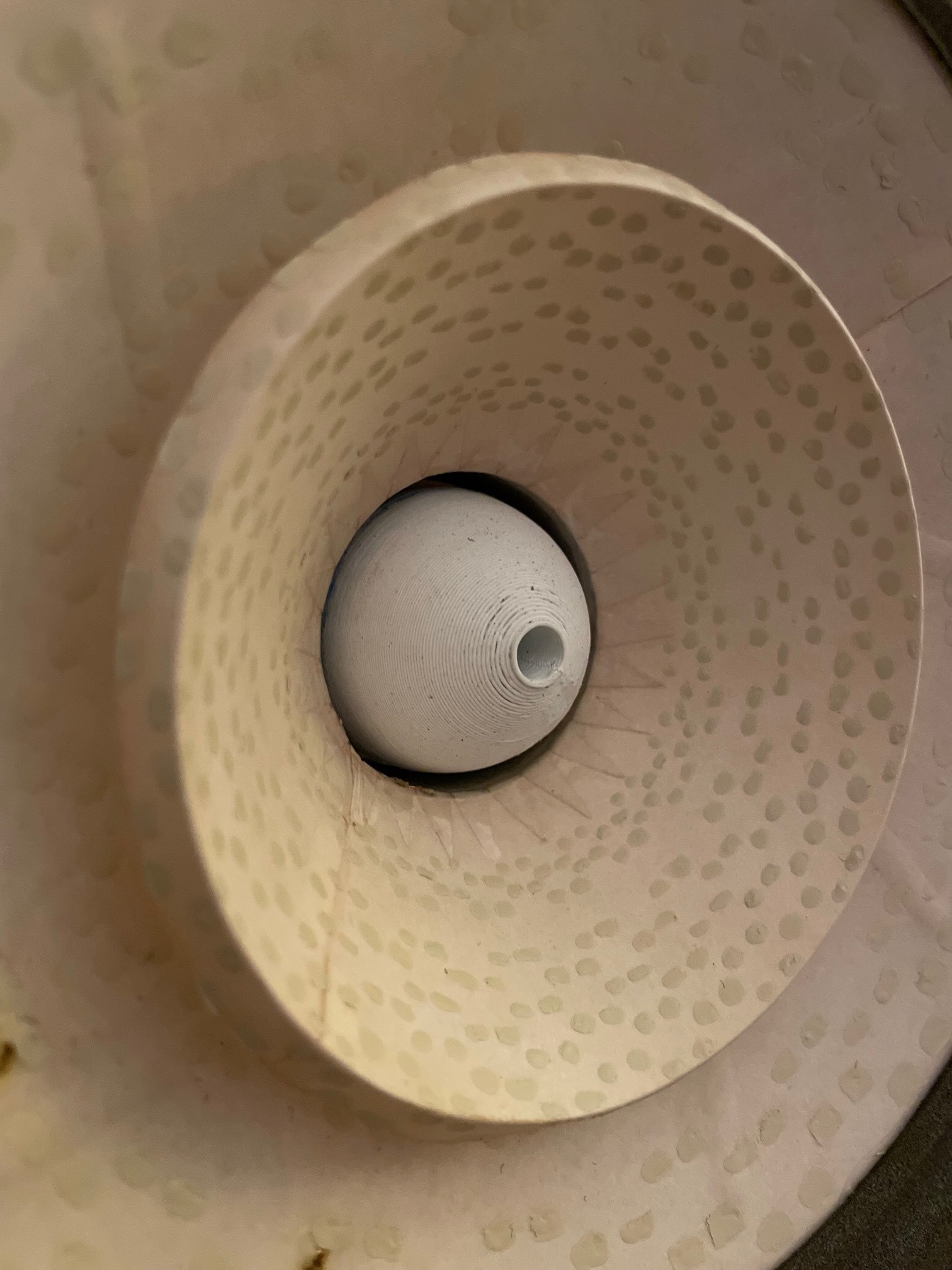

Today someone asked if my FE103/40-1197 phase plugs would fit into the FE127.
So i was oblidged to do a dustcapectomy... after a bit of a struggle getting some errant bits of dust cap out of the gap....
The FE127 has quite long voice coil that extends quite a bit beyond the apex of the cone. The 103/1197 phase plug is the right diameter but i think needs about 9-10mm more "shoulder".
It was interesting to see some ripples in the out-of-the-box impedance curve disappeared with the dust cap removal (some came back with the too short phase plug)...
dave

On a closer read of the patent and some of Mark's comments, the patent seems more targeted toward midrange speakers IE 3 inches, where the plug is more critical, although it is still applicable to woofers.

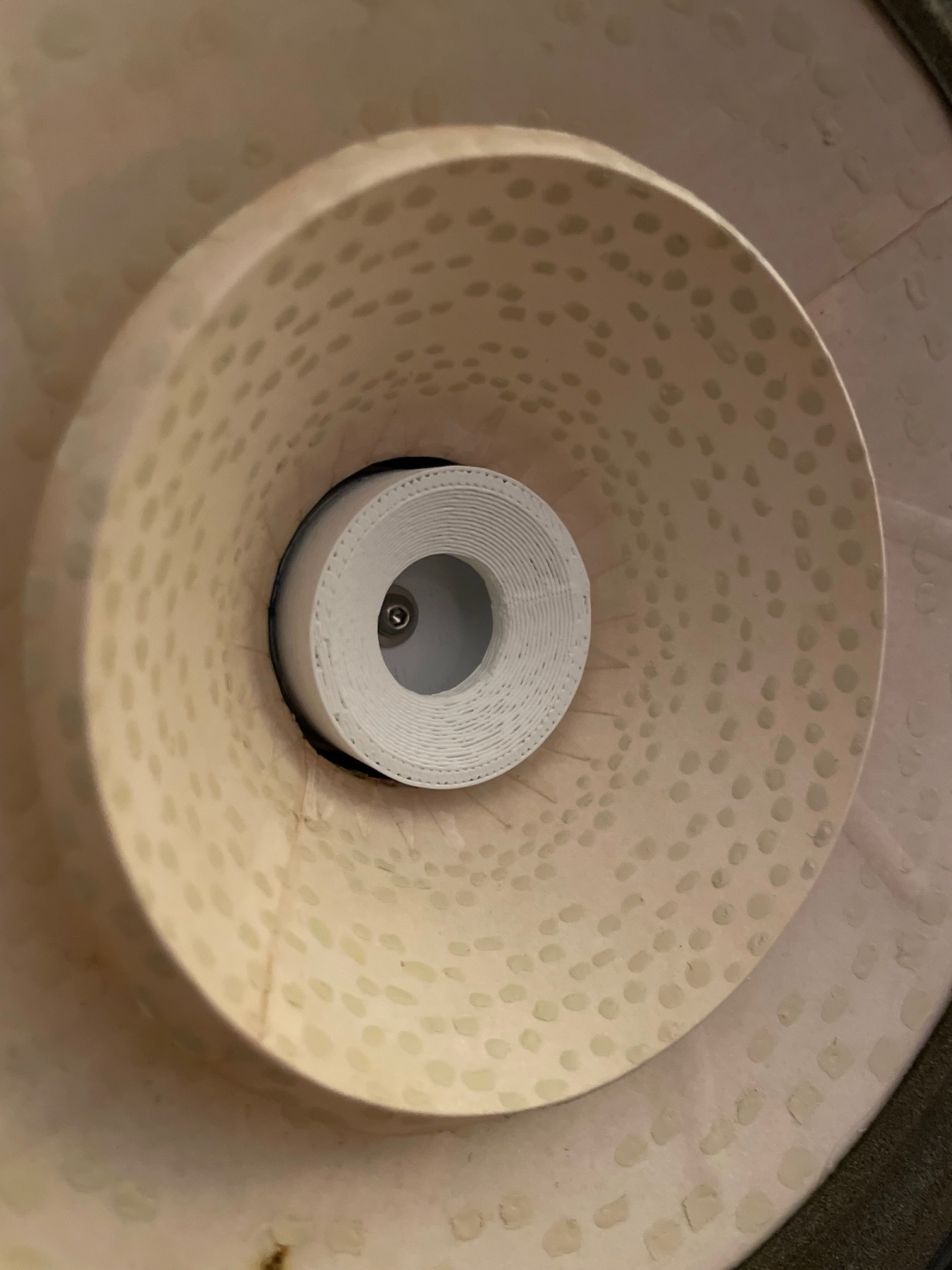

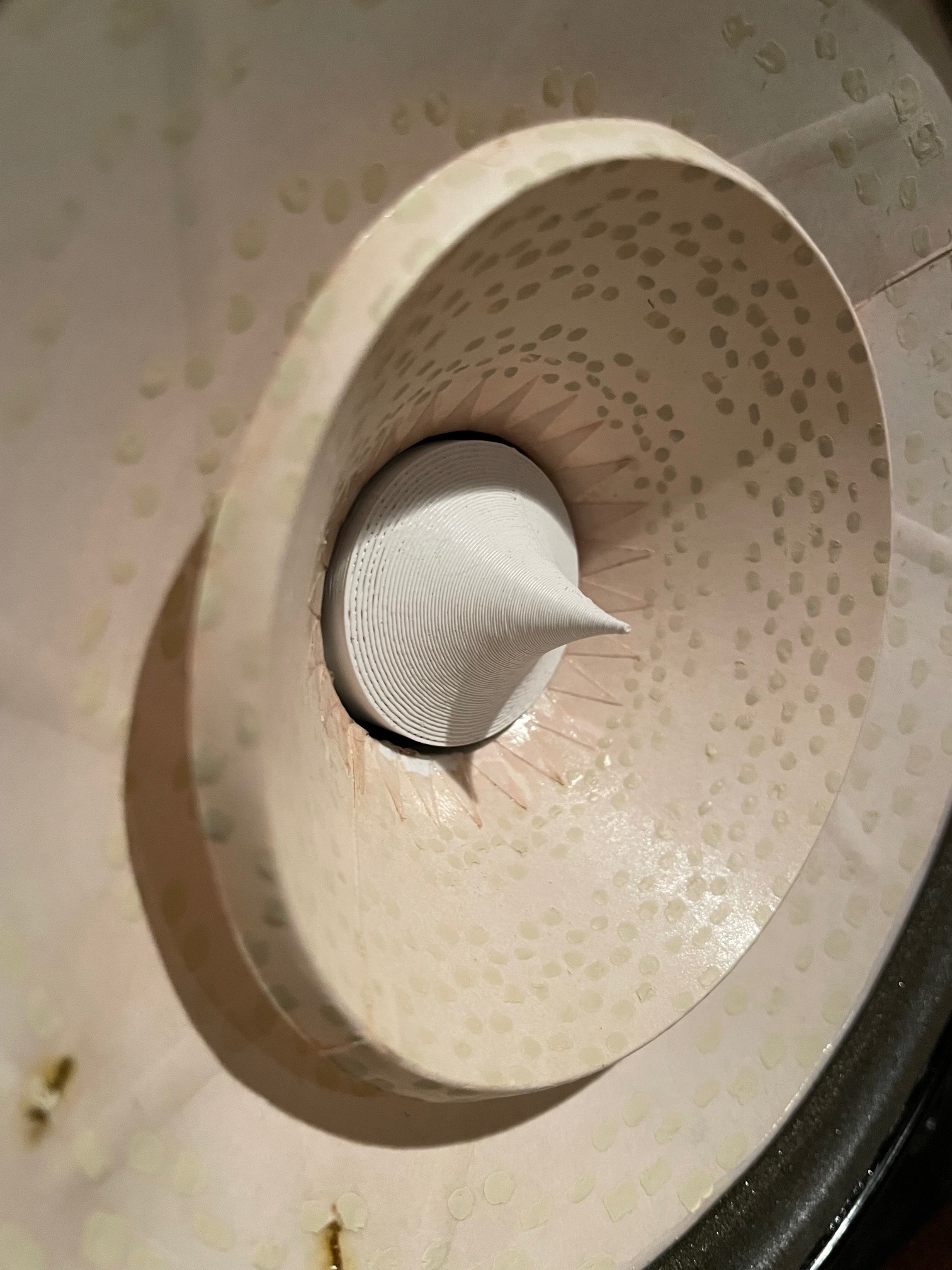

I'm a cone tweaker who is not afraid to experiment, and I have had very agreeable experiences with various treatments for cone breakup. I have been in the process of taming Lowther 8" "full range" drivers, which I use with crossover for midrange. (Second order upper rolloff @ 4600Hz) The Lowther DX series come with two styles of phase plug. The standard one is very similar to those that Dave at Planet10 makes. The "exotic" one on the DX4 is a wave guide dubbed the 'holy doorknob'. I read that the doorknob is less desireable when the driver is not back loaded, so I tried removing it. The result was an obvious increase in apparent detail and thus began an experimental trial of different plug shapes. My son was kind enough to share his 3D printing skills, and made just about everything you might imagine sticking out beyond a voice coil, including a series of resonators based on the Decware article noted above. Our microphone was 12" from the driver, and we were in my very challenging listening room with lots of midrange modes.
The stock 'holy doorknob' causes a gigantic cancellation trough at 3 kHz, which is missing when it is removed. That trough was nasty - a sharp 30 dB or so... The exposed pole piece is recessed 1/2" from the cone/coil former joint, and with the stock plug removed that recess causes a ~5 dB bump in the frequency response centered at 2.5kHz.
Here is a summary of what we observed with various shapes of 'phase plugs':
1. Cylindrical resonators (a la Decware) were a bust at any length and extension. The shortest one extended only about 1/8" beyond the V.C. former and it allowed all of the 2.5kHz bump of an empty cavity. The longest one was about even with the edge of the whizzer cone and it caused the 3kHz cancellation trough like the stock phase plug. In fact, on these drivers ANY cylindrical extension out from the cone base produced this obvious 3k problem. So ANY kind of exotic junk - bound to fail with respect to the 3k downward trough.
2. Bullet shapes were better as long as they were short, with the beginning of the taper at or near the base of the cone. They gave an attenuated combination of both the 2.5k bump and the 3k dip. We decided to go back to the printer and make some spikes...
3. As long as there was precious little cylinder emerging from the pole piece, spikes were the best. The 2.5k bump and 3k trough were further attenuated, though not absent. OK, so we cranked up some very high res music comparing the short bullet to the spike. The spike was better and its effects on audio clarity were a little startling! On very familiar recordings suddenly there was an improvement in source locations, and maaannn... you could hear every singer's every breath and all the sounds of handling acoustic instruments, etc. Oh, and audience applause sounded quite real. We may make nice metal versions of the spikes, but I wouldn't expect them to sound any better.
Frank

To save folks time of having to click on the link to the patent, here is what the investor is proposing:

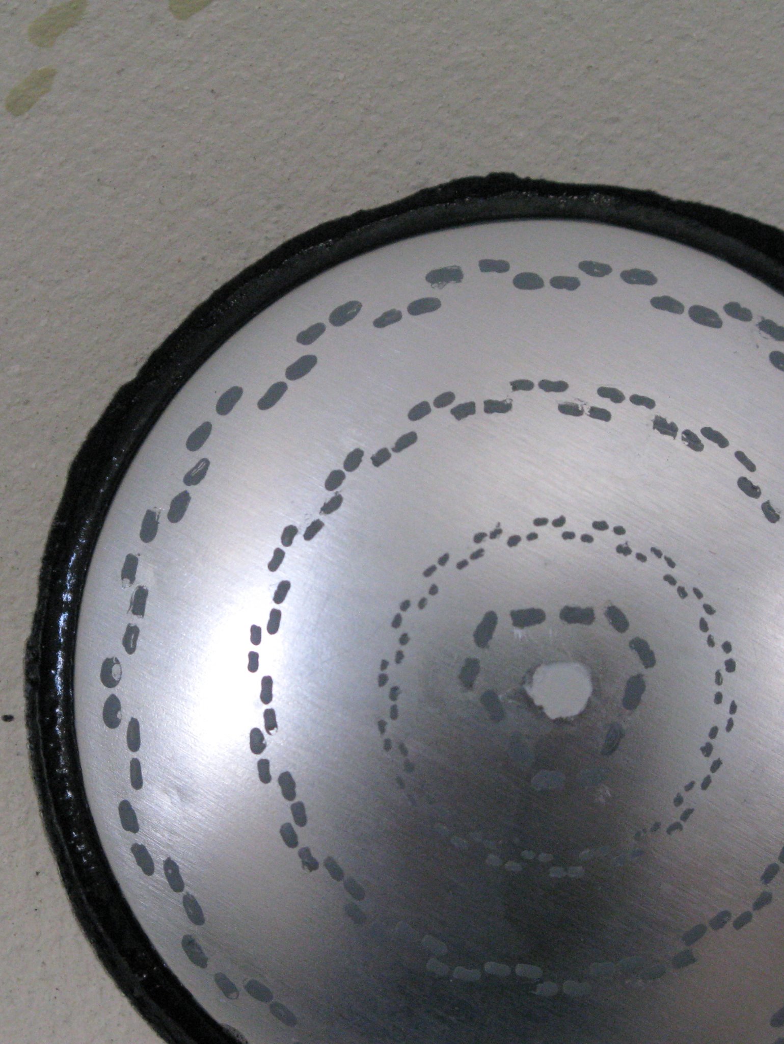

The photo is from a very difficult old JBL dust cap. First step is the center dot of elmer's glue. Second is the perimeter row of cancellation dots. If still needed, additional rows of cancellation dots can help. On woofers, I've never needed more than the first two. Also works to smooth out dome tweeters, btw. [Disclaimer - the exact mechanism of action is not well understood nor consistent among the wide range of transducer materials. I'm comfortable with that...]
