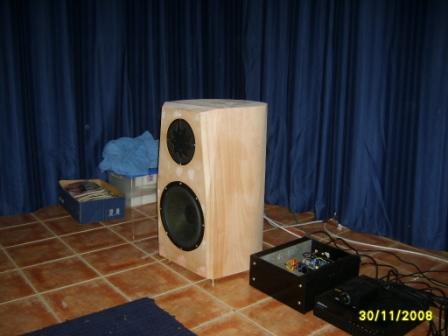

please excuse the bad pics
i am a good gasfitter but not much of a photographer😱
the pics make the cabs look uneven and crooked but they are nice and straight
they will have a leather front baffle and veneer on the top and backs
i also have to build stands to get them off the ground more
regards to all sheafer

Hello SLR..
Nice work. It looks nice without veering. ^^
What is the woofer?..
The distance between MSW and woofer looks a bit far..
Would you describe your plan for this speaker?

WOW!!
Sheafer, impressive matrix cabinet!!!!!!😎
I only suggest to put grey( or black) wool felt instead leather!😉
Stand..............make they serious!!😀

hi all
thanks for the kind words
my plan for the speakers is to use them as test cabs to get a feel for the sound of the 2/way with the manger transducer the whole project is a bit of an experiment
the bass driver is a eton 12" hexacone and blends very well with the manger i feel ,and to be honest i just took a guess as to the distance between the bass driver & manger
can you explain further why you feel it is too far any advice would be helpfull
im very happy so far and am amazed at how the speakers dissapear in the room and the natural presentation of the mid and highs of the manger but i will do it a little bit different next time
im planning on trying the manger central in between 2x bass drivers next and then ill do some messing around with open baffle designs

Experiment
So now I dare critisize such a nice thing
It seems like its too low
Manger should be at listening height
I think some one mentioned a standmount (Paolo?), or just some feet, thick plate or something
Crossing low you should have no concerns about distance between drivers
Doing dipole is no good fore bass, I know many are happy with it
OB would only make sense to me with subs
And dipole subs would be as big as IBs
But sure, a single good woofer with high sensitivity would work
You probably miss the BSC in midbass
Your present woofer is too low on sensitivity or Manger would need attenuation, which would be awfull
Only, a woofer with high enough sensitivity will be low on deep bass
Some could live with that
Personally I would only consider such expencive driver in as system that would be true "fullrange"
hi tinitus
do not fear as i am not offended by criticism of my design
people who have more experiance than i picking apart my design
can only help me in my future projects making them get progressively better each time
i value very highley the oppinions of others on this site and it is with help from them that i was able to build this project
i plan on making some stands for the speakers in the future which will bring the mangers up to ear level ,they were designed to be standmounts but i just haven,t the time
by trying ob i mean just the mangers and the bass drivers will stay a sealed design but with a q of .5 instead of the .7 it currently uses
i,m also curious as to what the mangers would sound like paired with a 15" to 18" high efficiancy driver

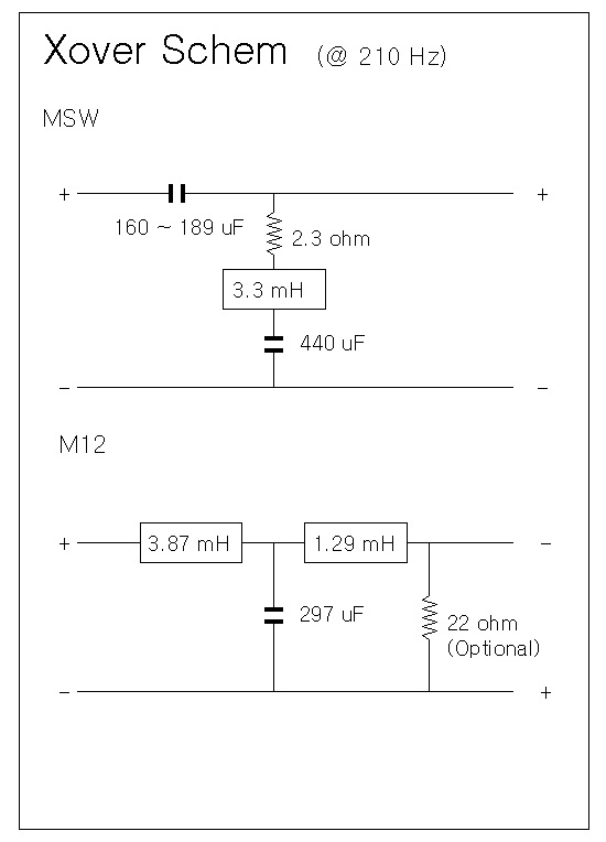

Hi Sheafer,
IMO you need a guidance to avoid to waste a lot of work,time and money😉
Your work have to be understand exactly how good the system is now,
and paragonate with high end commercial brands.
This is a long work , not easy, eh !
When I am talking about "monstruosity" I was thinking exactly as like the drawing you have posted !
No offence here, just warning, you are moving toward a very dangerous road!
You have to motivate why you want a bigger woofer.
12" is not sufficent? IMO you guys are obsessed by high SPL....Why this? ( again no offence here )
Exerpt home theatre, I do not see the reason. This is IMO a wrong habit , 100dB spl CAN BE sufficent .
I am familiar with La Fenice Theater in Venezia and Arena of Verona.
I assicure you the SPL is not so High, even with big orchestra symphonic, when you are seated in a medium row.
And if you do not become deaf in the next 20 years, is better you
change your approch to listen 😀
About How to drive two electronics you need a simply Y adapter after your stepped volume. Is it 10Kohms?
Then you have to add a passive high pass in the signal path for the MSW. Line level, speaker level or both. It depends.
I can help you, no problem🙂
Drop me an e-mail , if you want of course.
Paolo
Paolo
hi paolo
thank you for your advice and kind offer of help
i will drop you an email shortly
regards sheafer

hi all
has anyone else here done any more work with the manger ?
i have an update on my project if any one is interested
i have 4x scanspeak 25w/8565-01 that im going to pair with the mangers and will report on my results once finnished
i still have not finalised a design yet but have some thoughts ill throw out there and hope you guys will offer some advice /opinions
1) build a copy of the zero box 107 but with the scan drivers instead of the vifas used by manger
2)build a wmw design with a ss 25w 8565 on top and below the manger
as for sealed of ported i am not sure but i am leaning towards sealed with a q of .7 so the box will need to be 180 to 200 litres for 2x the scan 25w per cab
another dilema is the baffle ,should i do a wide or narrow design
each seems to have its up and down sides
i have read in another thread that appx 10 " baffle width will work well with the manger and counter act the rising responce it has towards its lower registers
any ideas or what ever you can add will be much appreciated
regards sheafer
i have an update on my project if any one is interested [/B]
Hi Shaefer, nice to see you finally ! ;-)
I am interested.
[/B]
2.5 ways TMW , passive x-overs or other ?
1) build a copy of the zero box 107 but with the scan drivers instead of the vifas used by manger [/B]
Not a bad idea , man!
2)build a wmw design with a ss 25w 8565 on top and below the manger [/B]
Nope! 🙂
as for sealed of ported i am not sure but i am leaning towards sealed with a q of .7 so the box will need to be 180 to 200 litres for 2x the scan 25w per cab[/B]
Sealed. BTW, are you sure of 200 litres ? seems to me a bit exaggerated......check better your datas 🙂
each seems to have its up and down sides [/B]
No dilema, narrow of course.
i have read in another thread that appx 10 " baffle width will work well with the manger and counter act the rising responce it has towards its lower registers [/B]
Probabily true, but better if you can make a basic measurement or obtain a serious measurement set from Daniela Manger.
any ideas or what ever you can add will be much appreciated [/B]
We are here exactly for this ! 🙂
Paolo
hi paolo
ive done some more modeling with lspcad and worked out the following
ok for a q of .707 the box will be 131 l with 50% fill and will give a -3db of 39.7hz , for the bass drivers and the manger will be in a seperate box on top the same size and volume of the zerobox 107 design
i think i might copy as close as possible the zero box design and just vary the depth front to back of the cabs to get the box volume i need for the different bass drivers (ss 25w as opposed to the vifa that the zero box uses )
passive or active hmmm
i have a dbx 260 so active is doable
i have 2xstereo amps of nelson pass f5 in progress which i could use to biamp the system in either passive or active mode im just not sure about the power needed
the f5 is 50w into 8 ohm and my room is 25 m2 so 1x f5 for the mangers and 1x f5 for the bass
sound doable ?
feel free to pick apart my plan
sorry paolo its meant to be a zerobox 103 not 107
sound doable ?
slr 5000 said:hi paolo
Sort of "Clone", eh? 🙂
Decent idea, but maybe you can add some little particulars/differences that make a big difference! 🙂
e-mail me.
Volume calculations are always approximations, IMO you can go 100%stuffed and make it a lot smaller.
The separate head is foundamental.
[/B]
OK, and maybe will do it also matrix-type 🙂
[/B]
The most logic thing in your specific case is duplicate the output of the master volume/ preamp ( even if it is a passive attenuator!).
One directly into the amp of the MSW
and the second passing trought the DBX into the second amp
, only for SS woofers.
sound doable ?
[/B]
Mmmhhh, Nelson Pass here, you are smart guy! 🙂
F5 is 50W ? Well, I do not remember all those numbers ( I 'm starting become old, guys😀 ).
What is the Z input of the F5 ?
I believe the power can be sufficent ( bass expecially need power) but ONLY if the speaker will sound very good and if you will make a optimal setup in your room. This is not a joke; efficency, powers, all the calculations you want are good for mics, not for humans!
Paolo
Swan M12 Woofer..
Hello.
I am considering to build 2 way with Hivi M12 woofer.
It's 93 dB which is a little more efficient than MSW, but the 3rd order Xover IMO cut 2 dB.
Woofer volumn would be around 50 liters and would be ported.
Tuned at 30 Hz..
I need your advices for the enclosure and Xover design.
Outer layer is 24mm thk of white birch plywood and inner layer is 25mm MDF.
It would be very heavy. ^^
Regards.
Hello.
Tuned at 30 Hz..
Regards.
