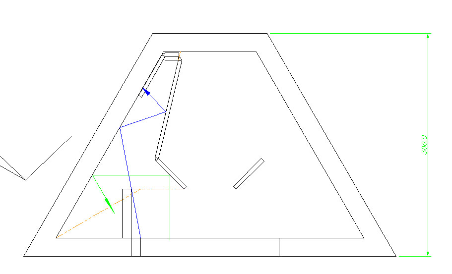

MSW enclosure
This is some concept.
The sound radiated from the inside of the voice coil of MSW reaches the back of the enclosure.
And some area of outside of the VC reflects and absorbs at the corners.
The refecting plates are made of steel and the enclosure is wood, MDF, or steel.
Is there anybody tried this?

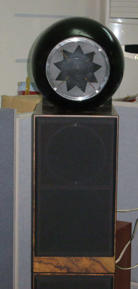

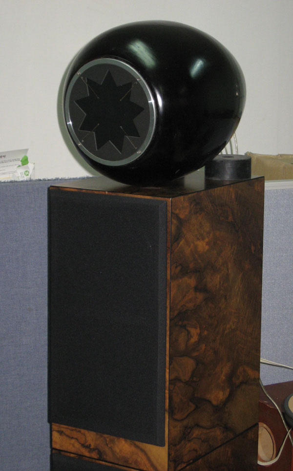

Very beautiful eggs , Richard! 😀
I think the "step" of the woofer cabinet have a negative impact on the sound emanated from the "egg". Very bad diffraction effect. Put some thick felt on it , the more you can . 😉
What woofer are you using?
