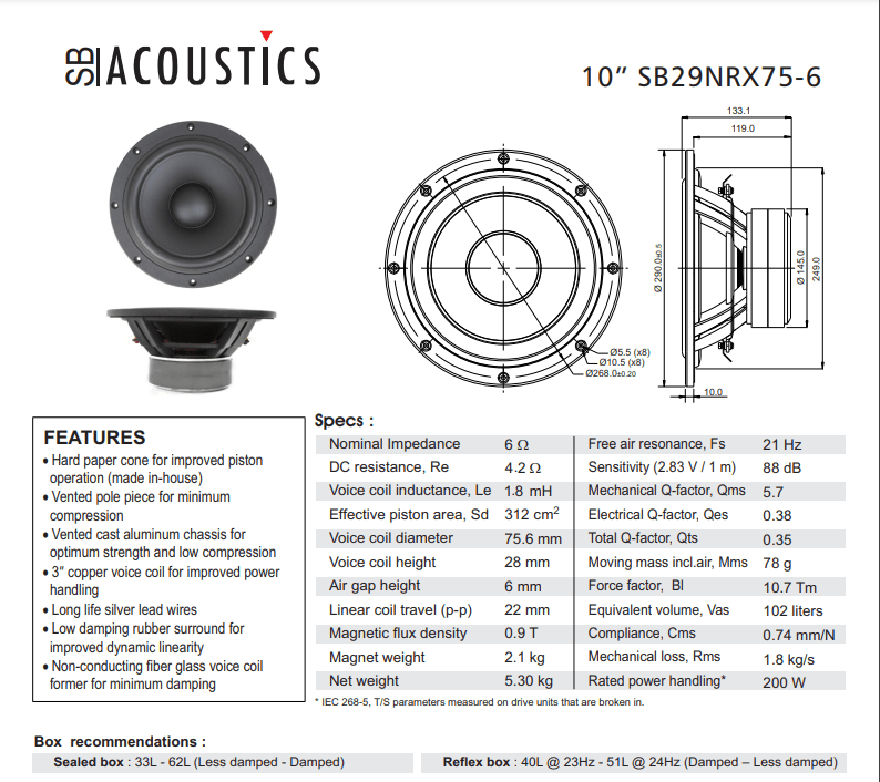

This one is also easy:10" sealed
Easy
https://sbacoustics.com/wp-content/uploads/2020/02/10in-SB29NRX75-6.pdf
Thank you Draki, I have seen it.
