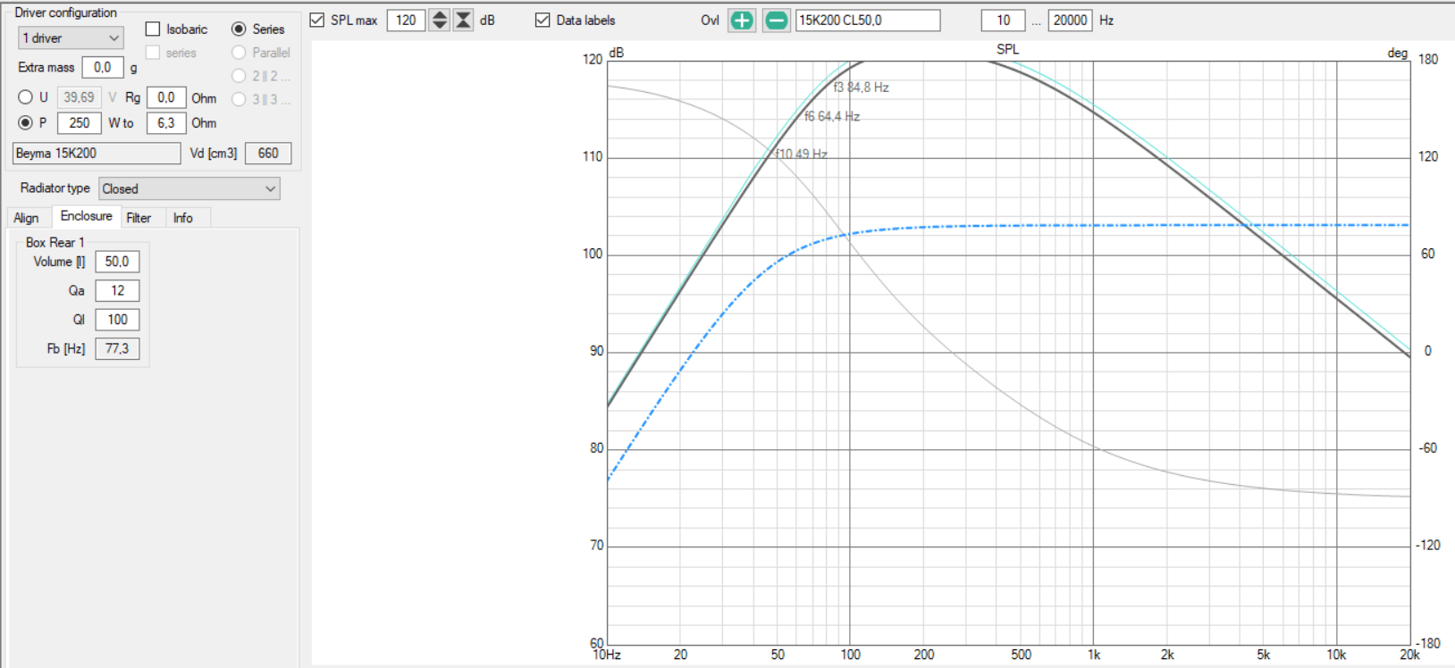

Hi, FYI, for 50 litre closed box many 12" or 15" drivers fit as well, and potentially have more max output if that is something useful.
For example the wavecor you mention seems to bottom out with 30Watts in 50 litre enclosure. You could put it into ~10litre box to use all your amp power, or four of them to the 50litre box. Or, put a 12" or 15" to the 50 litre cab, pour in all your amp power and get mo max output. Mo power is mo heat so what feels nice compromise to you. DSP allows quite much flexibility.
Old beyma 15k200 can do ~10db more at 40Hz on the 50litre box with 250W amp, than the wavecor above. Wavecor falls short due to small cone area and xmax. Its good for smaller box though. Blue dotted line is wavecor in the same 50litre sealed box hitting xmax, black line 15" driver with 250W watts you have.

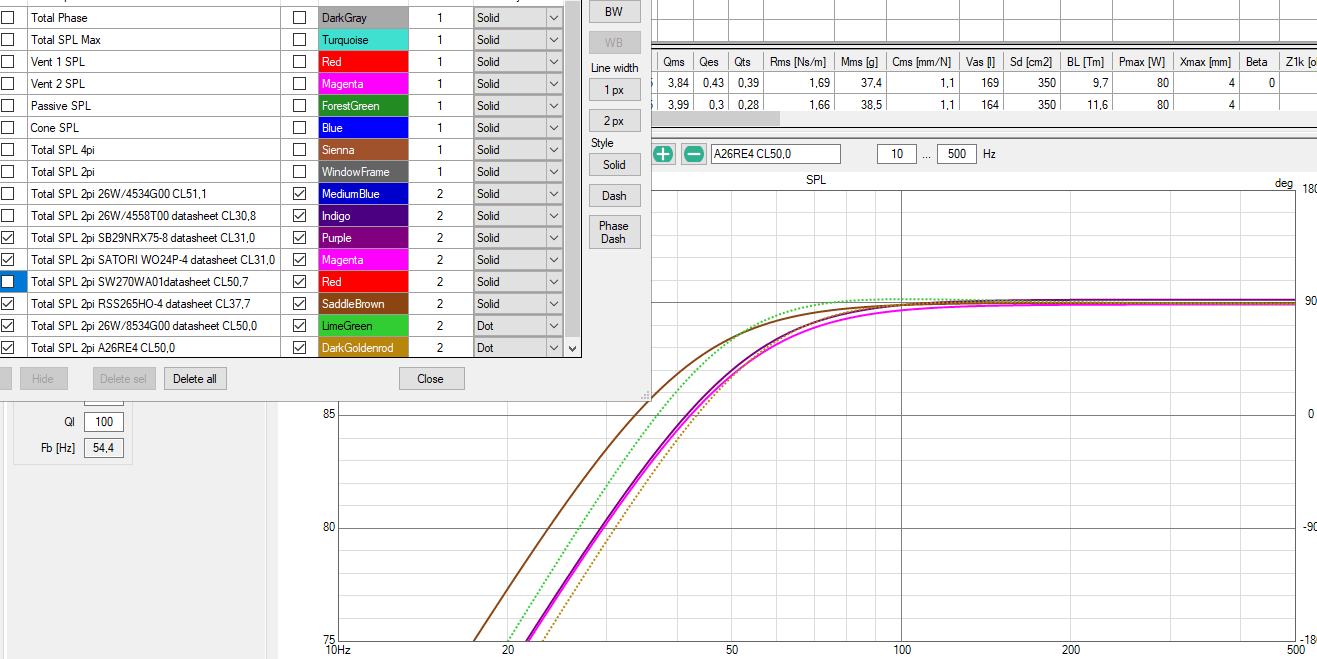

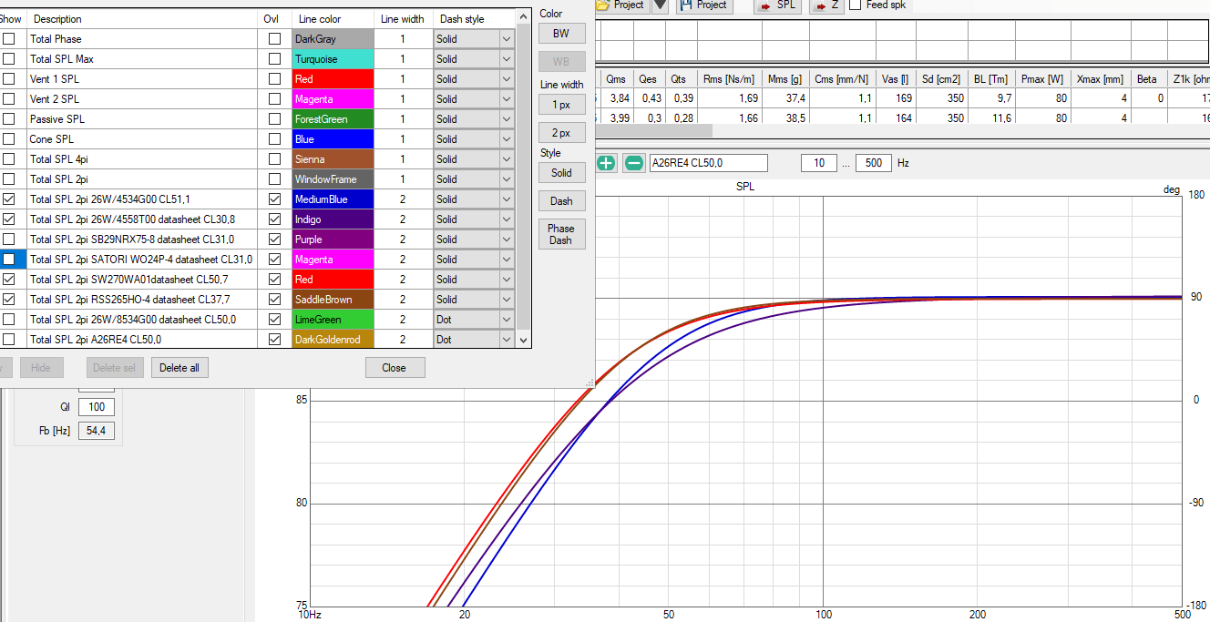

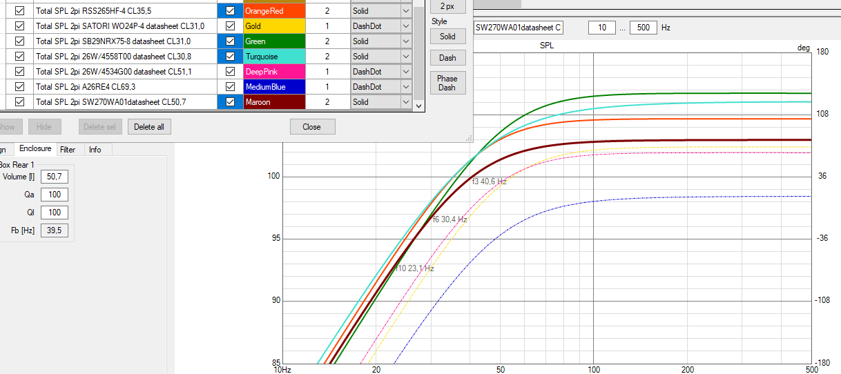

I've tried to quick simulate all the woofers we are talking about... of course, for what I understand, F3 is not the more important parameter but, just for having an idea, Dayton RSS265HF 4 and Wavecor SW270WA01 go lower than other drivers, F3 is about 40hz.
Scan Speak 26W/4534 and 26W/4558 are doing well, F3 is about 46hz.
For SB, Satori WO24P-4 and SB29NRX75-8, F3 is about 50hz.
I've tried also Seas A26RE4 with an F3 of 50hz, and SS 26W/8534G00 but they need more volume, so Qtc is more than 0,7, especially SS26W.
Checked also EBP ...
Dayton Audio RSS265HF-4 EBP 48,3
Wavecor SW270WA01 EBP 51,9
Seas A26RE4 EBP 58,1
Scan-Speak 26W/4534G00 EBP 62,2
Scan-Speak 26W/4558T00 EBP 63,6
SB Acoustics SATORI WO24P-4 EBP 66,6
SB Acoustics SB29NRX75-8 EBP 67,0

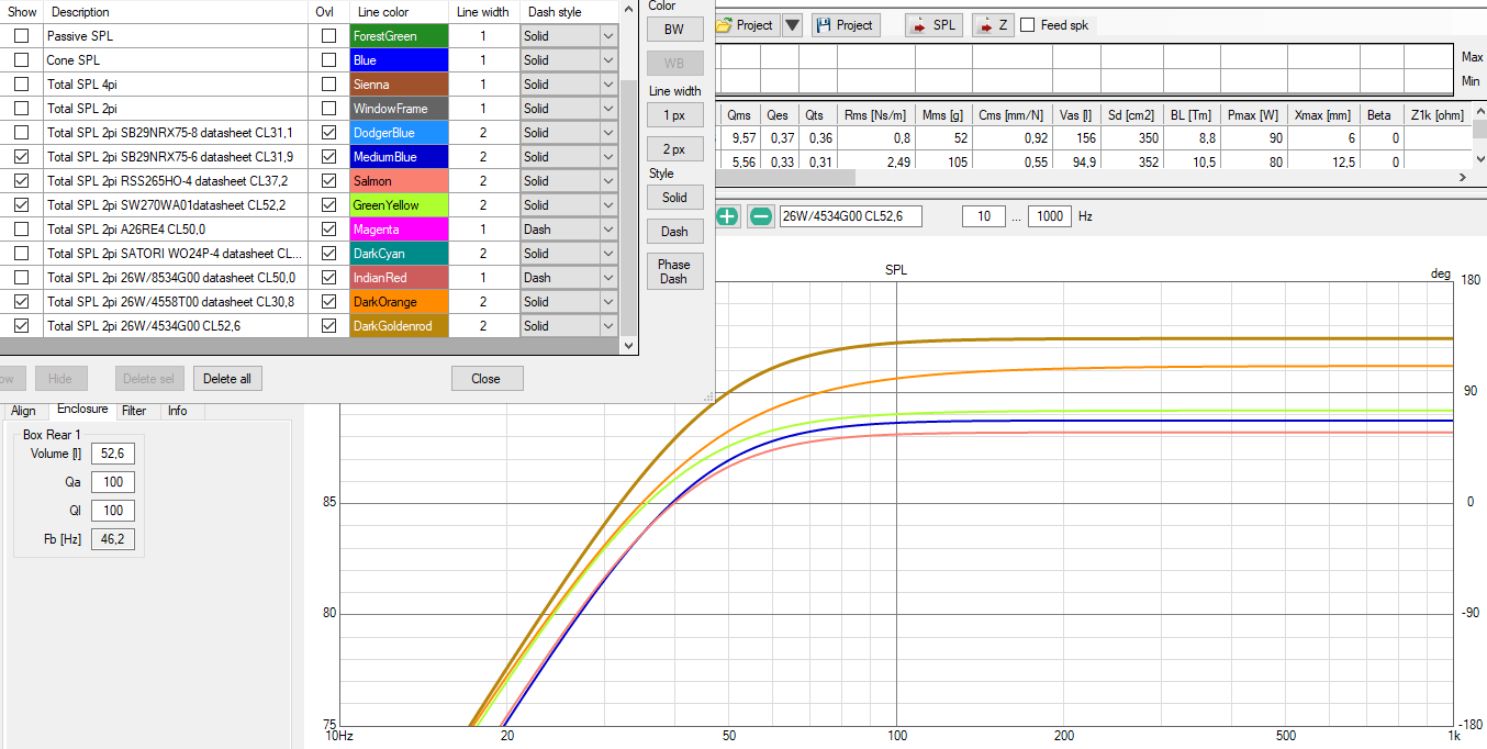

About the plate amp, I was thinking at Hypex FA251, 250w.

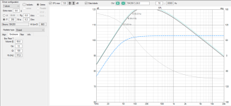

And here is, max SPL/max excursion, I don't know if I have done it right, with an eye on Excursion, I have rised PW until the limit:
If it is right SB29NRX75-8, 26W/4558T00 and RSS265HF-4 in about 30-40 liters have higher SPL, then SW270WA01 in 50 liters.
