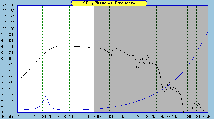

So after much searching, I found ONE 3rd party test... Zaph Audio 3-way tower uses the SB Acoustics SB34NRX75-6 in a 107 liter enclosure and gets this graph: (I don't like the dip at 650hz, my planned crossover point)
attachment.php
Zaph measured their own T/S parameters and came up with some slight differences, but still it seems like it worked fine in a smaller box than recommended by HIFI Speakers calculators. Given that I have 2 drivers per speaker, I would get an SPL bump and also room coupling boost, so I think it makes sense.

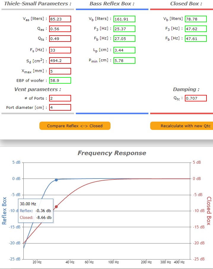

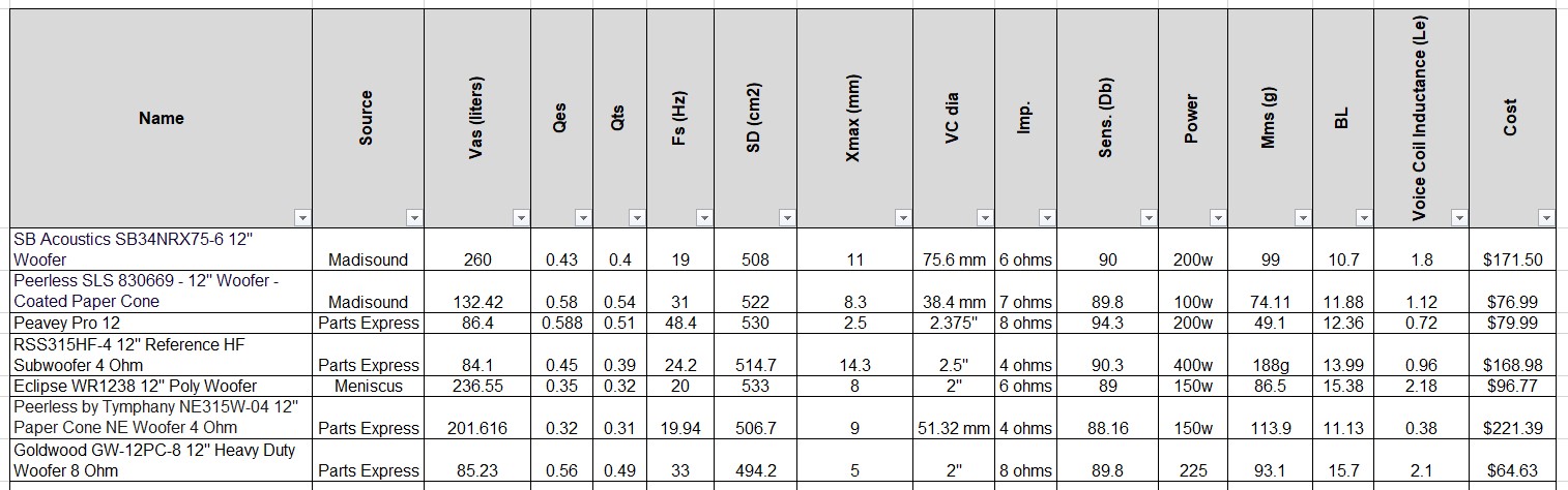

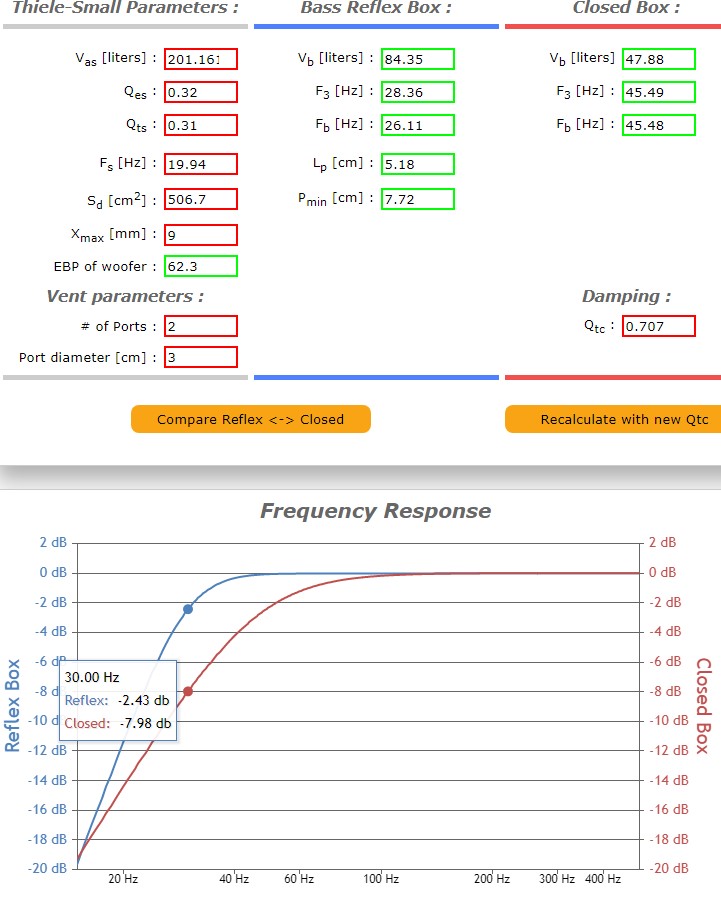

The Peerless has impressive specs, I modeled it as a higher-priced alternative plus the Goldwood GW-12PC as a lower-priced option... they are both in the range, (the Goldwood and Eclipse probably have significantly higher distortion, comparing the LE and QES parameters). Overall, the Eclipse still seems like the right price/performance compromise, being at the lower half of the price range and providing most of the performance I'm looking for. I've emailed Meniscus to see if they can provide more complete T/S parameters or a graph... I've read lots of positive comments about it... nothing earthshaking - but a good, solid driver with a long track record. So far that is my top candidate.
Here is the updated list of drivers under consideration and the two most recent models to compare with the previous postings on Msg #38
attachment.php
Peerless by Tymphany 4-Ohm
attachment.php
Goldwood GW-12PC
attachment.php

This is not getting easier... the Tymphany seems to be a great driver, but at a significant price.
