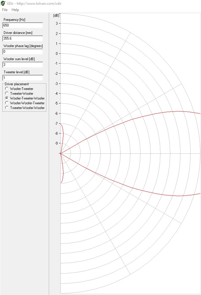

That’s gonna have a nasty forward lobe and null no matter how low you cross it.
Ok, so I found a way to model the CTC spacing (15") and the various crossover frequencies, at 600 hz there is only one 60 degree lobe, at 635 it starts to develop small side lobes, and here is at 650 below...
Since the horn is 60x40, this appears to be in-line with my expectations of reducing floor and ceiling bounce.

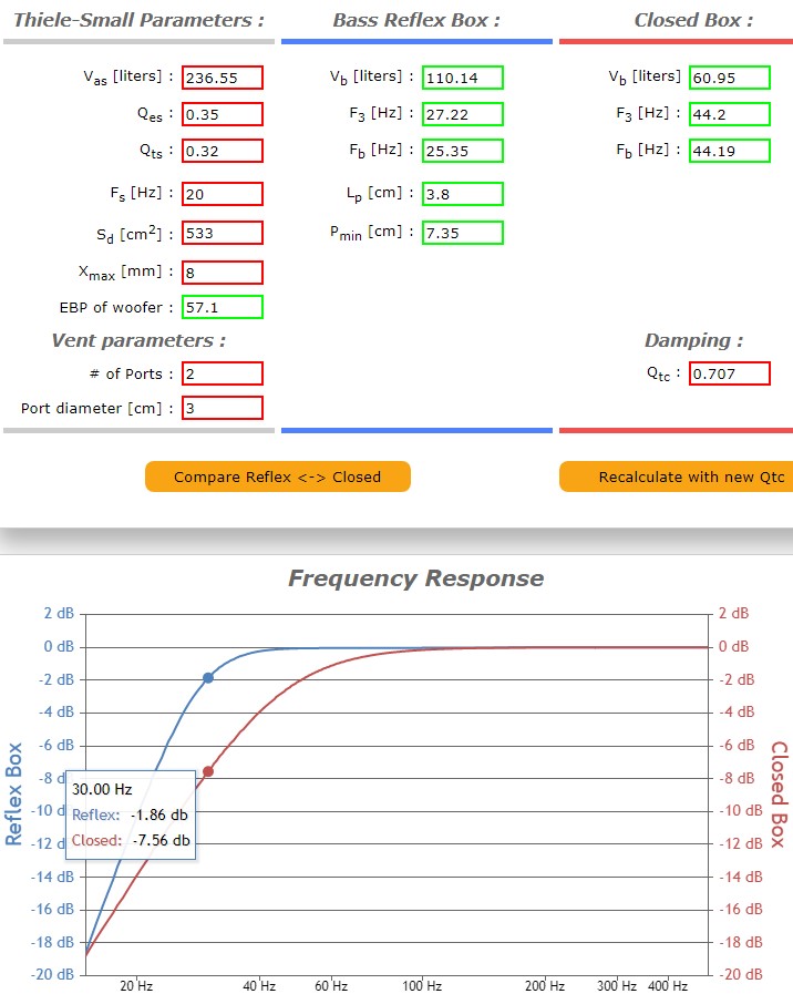

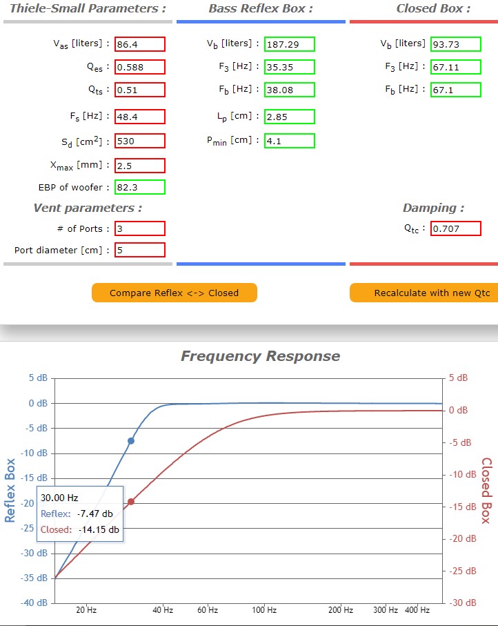

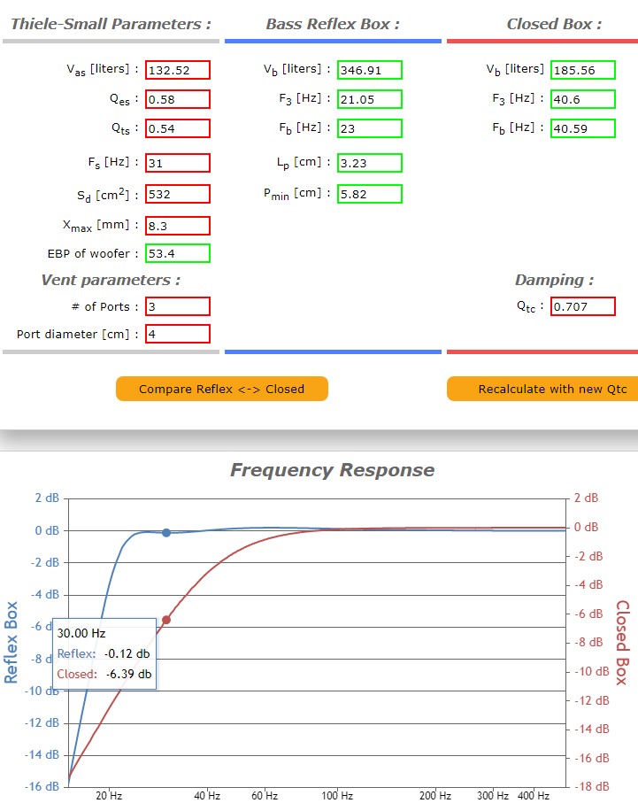

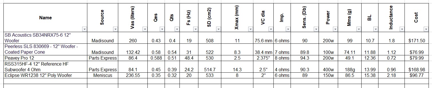

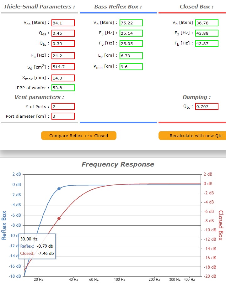

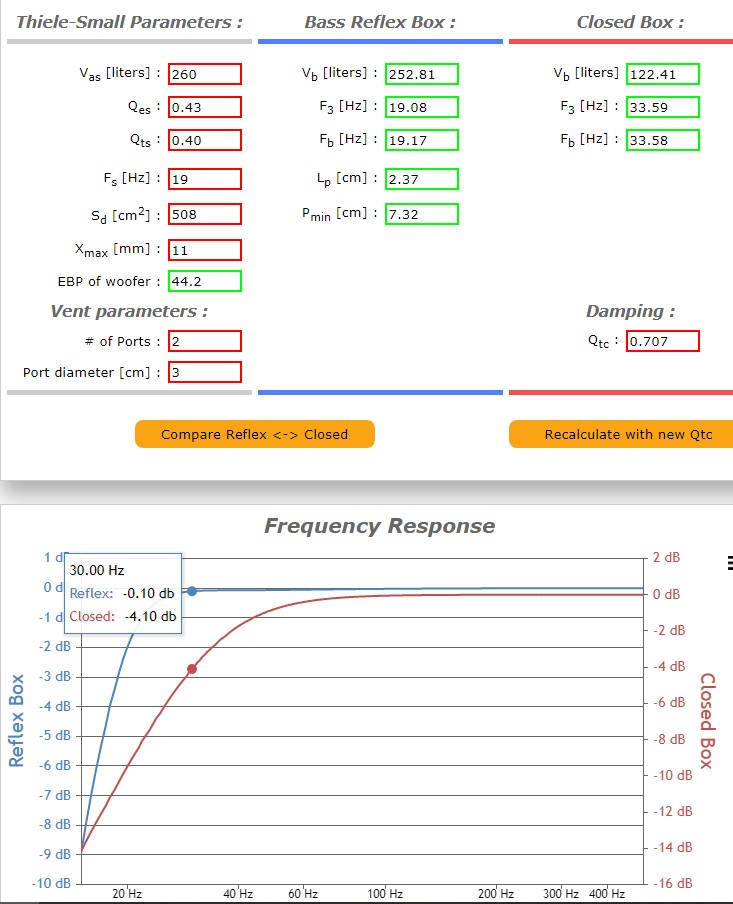

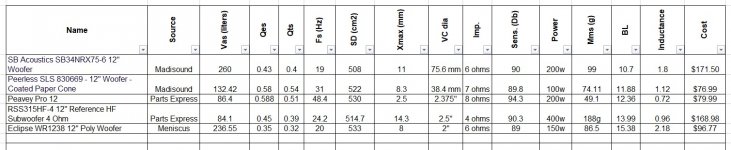

5 Options Modeled, updated driver data...
Here are the 5 drivers modeled in a vented and sealed box, plus additional driver data I typically use for comparisons....I'm still studying the graphs, so I have not come to a conclusion yet... but before I saw the graph, the Peavey was a strong contender, I just don't see it performing well at 30Hz. The two that seem to have the best low end extension are the SB Acoustics and the Peerless but the vented box sizes are significant. I was surprised the Dayton did not go as low as those two, but the box size is much smaller...wonder why?
The Eclipse seems to be a nice compromise between low extension, reasonable box size, and price...
Would love to get opinions on this! - Thanks! - Six.
5 Driver Datasheet Comparison

This is GREAT! Now; here is where we REALLY need a 3rd party test. Because; the OEM specs. are not always updated; they are not always accurate and we need a totally unbiased opinion based on both scientific methods and listening tests. Some things I trust; Zaph, Troels and Audio Xpress, also there are many others but I'm snacking right now waiting on my Crown amp. delivery so I'm not into a deep dive myself right just at the moment. I suggest doing a deep dive into 3rd party tests to confirm the OEM specs. You can model and speculate all day long; if the specs. are off by 20%, 50 % as some are; well...come to your own conclusions about accuracy and validity...
