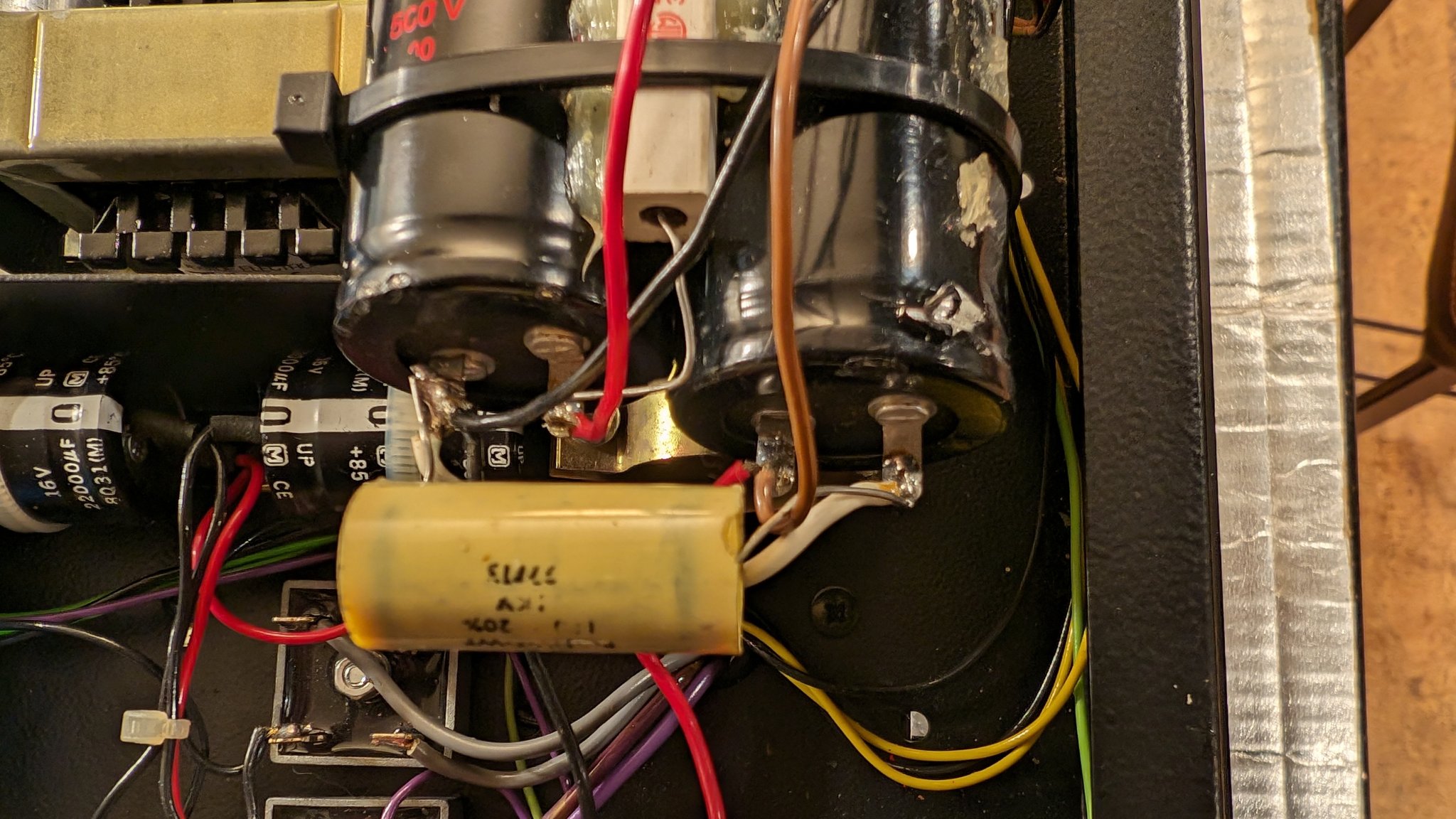

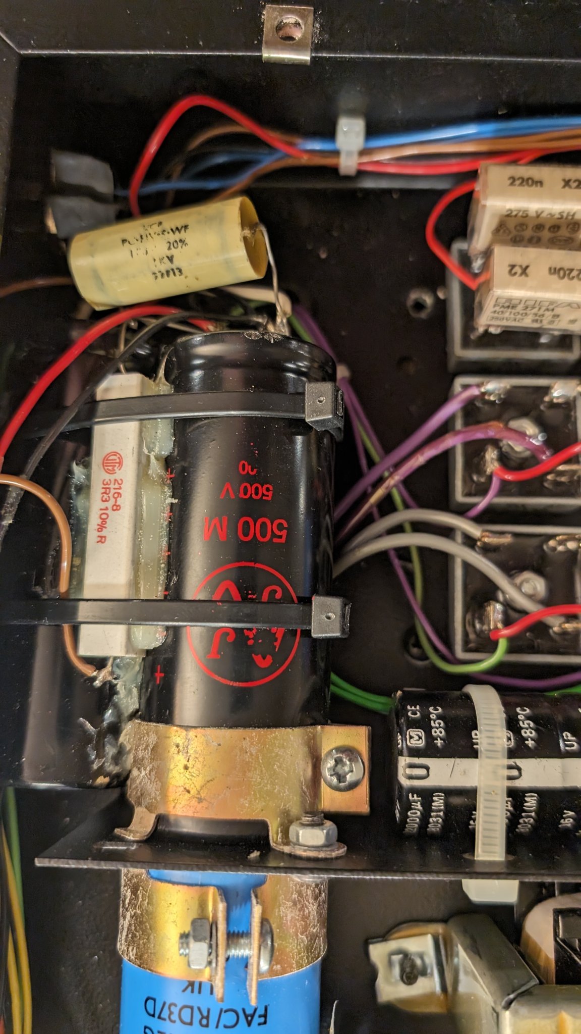

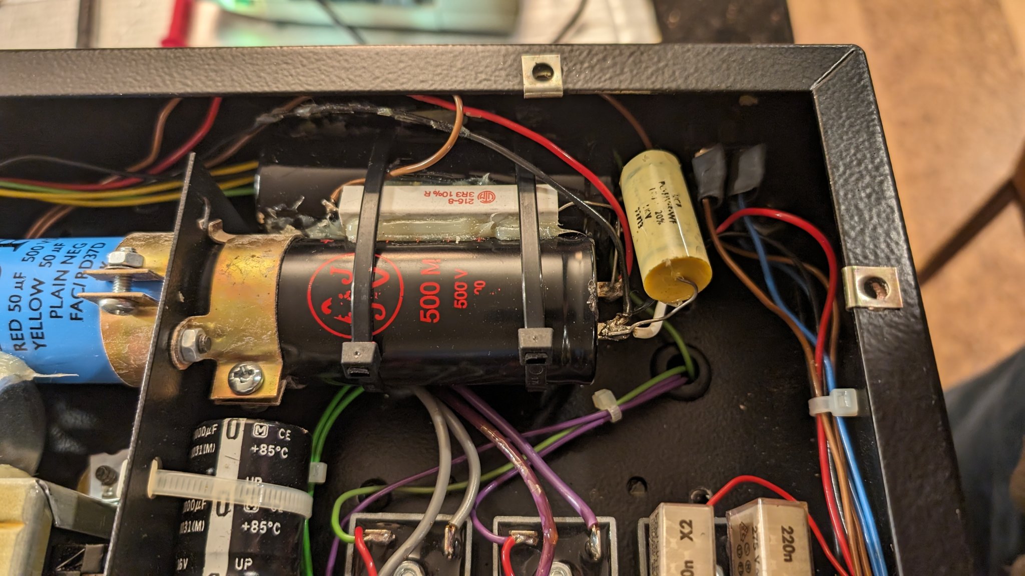

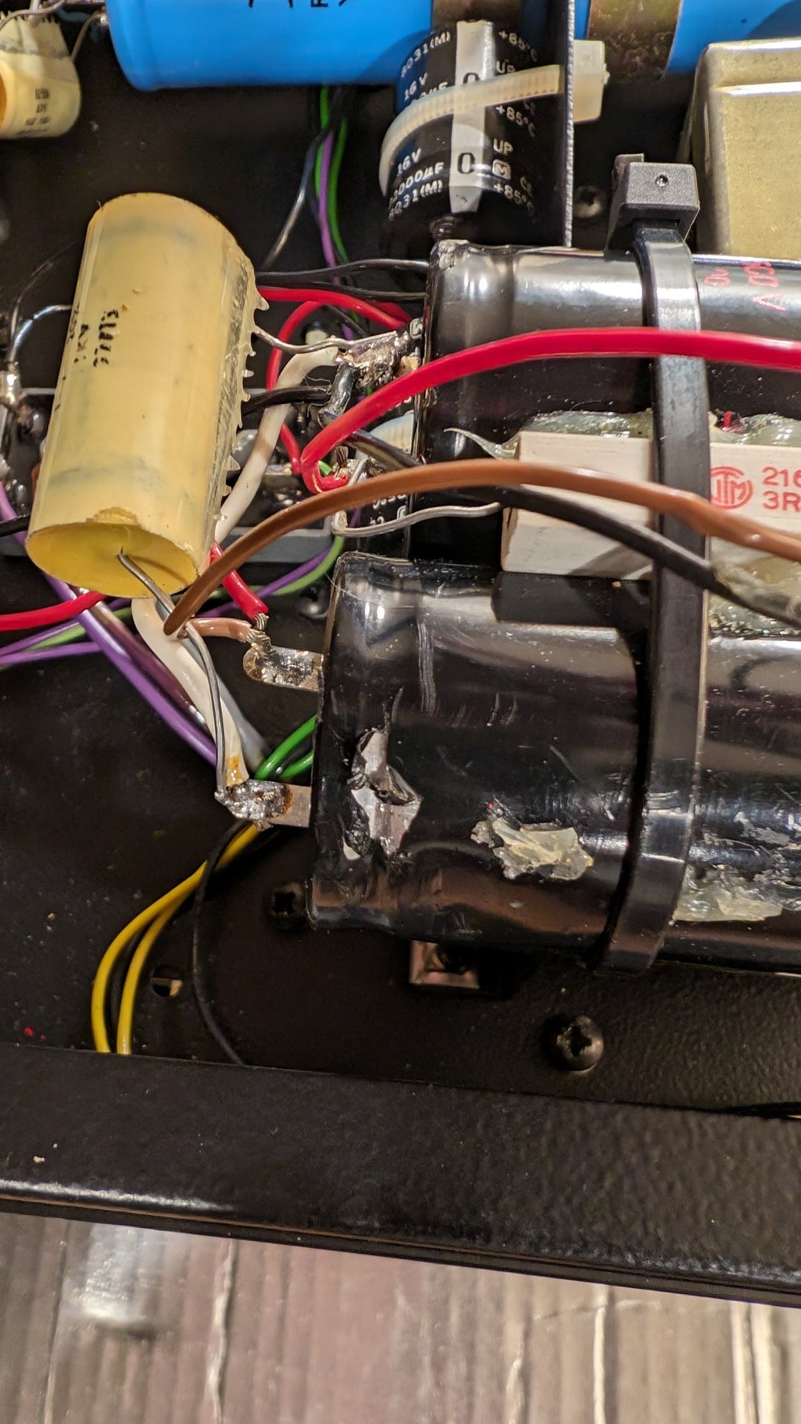

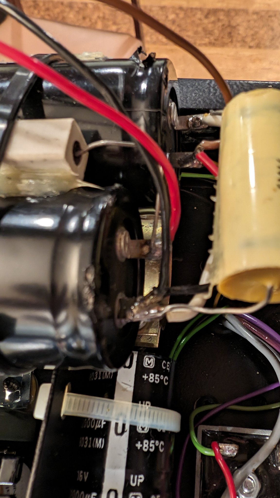

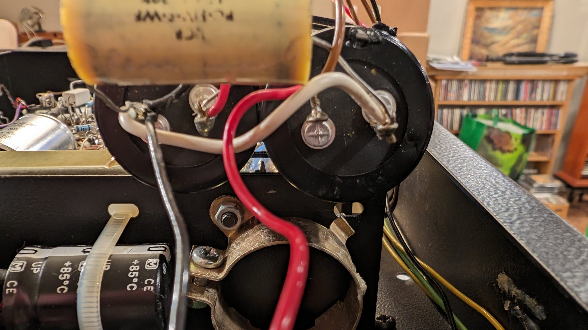

I think you're onto something. There are actually two (2) 500uF JJ caps in that spot zip tied together along with that big ceramic resistor. I'll take some better photos for you of the area tomorrow. I wonder if there is someone locally who can help me map out the power supply here in Regina, Saskatchewan, Canada. I can also check with Radford Revival to see if they have access to the power supply schematic .. it's been a few years since I've contacted them other than recently while I was looking for a couple of pull and turn voltage selector switches for a pair of Radford MA-25 mono blocks I've got running again. I wired them internally but it would be nice to have the original switches in place. You can see the switch behind one but the pull and turn part is missing. Anyone have a couple to spare?IMO that 500uF JJ cap is very suspicious and probably has no business being in there. I'm guessing somebody thought to give the amp more OOMPH by adding all that capacitance, but that can cause real problems. It may be the cause of the blown fuses.
Honestly, unless you're a skilled DIYer, I would find someone to help you map out the power supply and do some testing without the tubes to see where the short is.
The two suspicious 500uF JJ caps. I pulled them out of their holder so you can see the poor job someone made of it at some point in its history. This may well be the problem.
1000uF. Madonuzza santa. What people do to their poor tube amps. It could be that the bridge rectifier is blown or at least one diode is shorted.

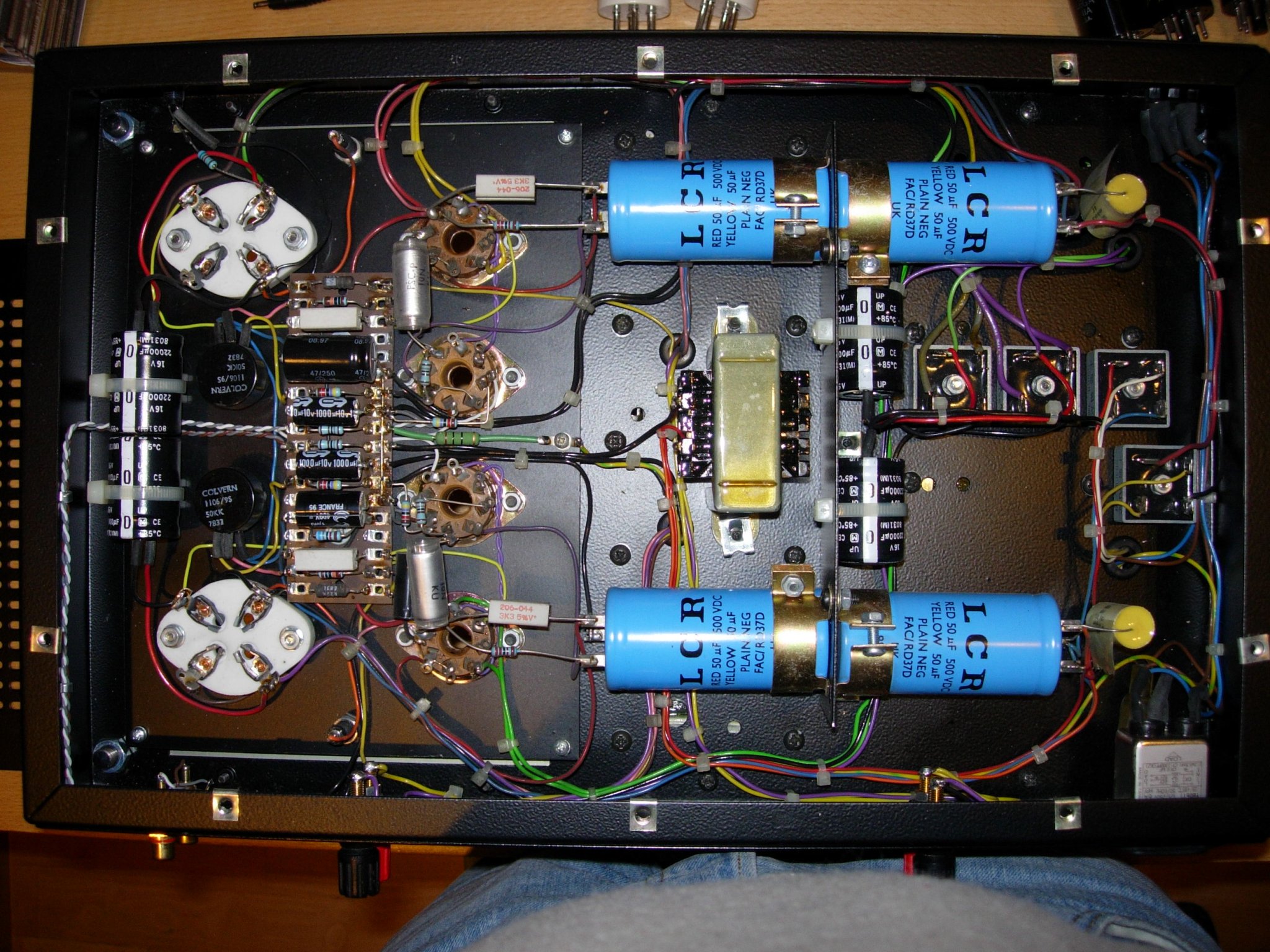

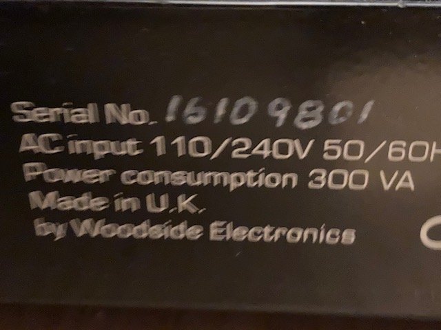

Hello everybody I just registered on the forum. It is indeed a very unusual amplifier with an impressive sound. I have one purchased in January 1999 from the distributor in my country. In these 25 years I have not had any problems and no modification has been made except to change the 6LS7 and put some NOS valves, I have only used it with Svetlana's 811-10 but I understand that it is the same valve as the 572-10 I have no idea about electronics. I can solder cables or change a resistor but little else... The fuse you ask about is 3.15 A and 250V. The stages are somewhat different. Mine is serial number 16109801. It looks like they are from the same day. Either mine has one more capacitor or yours is missing one. I'll send you a photo in case it helps you.
