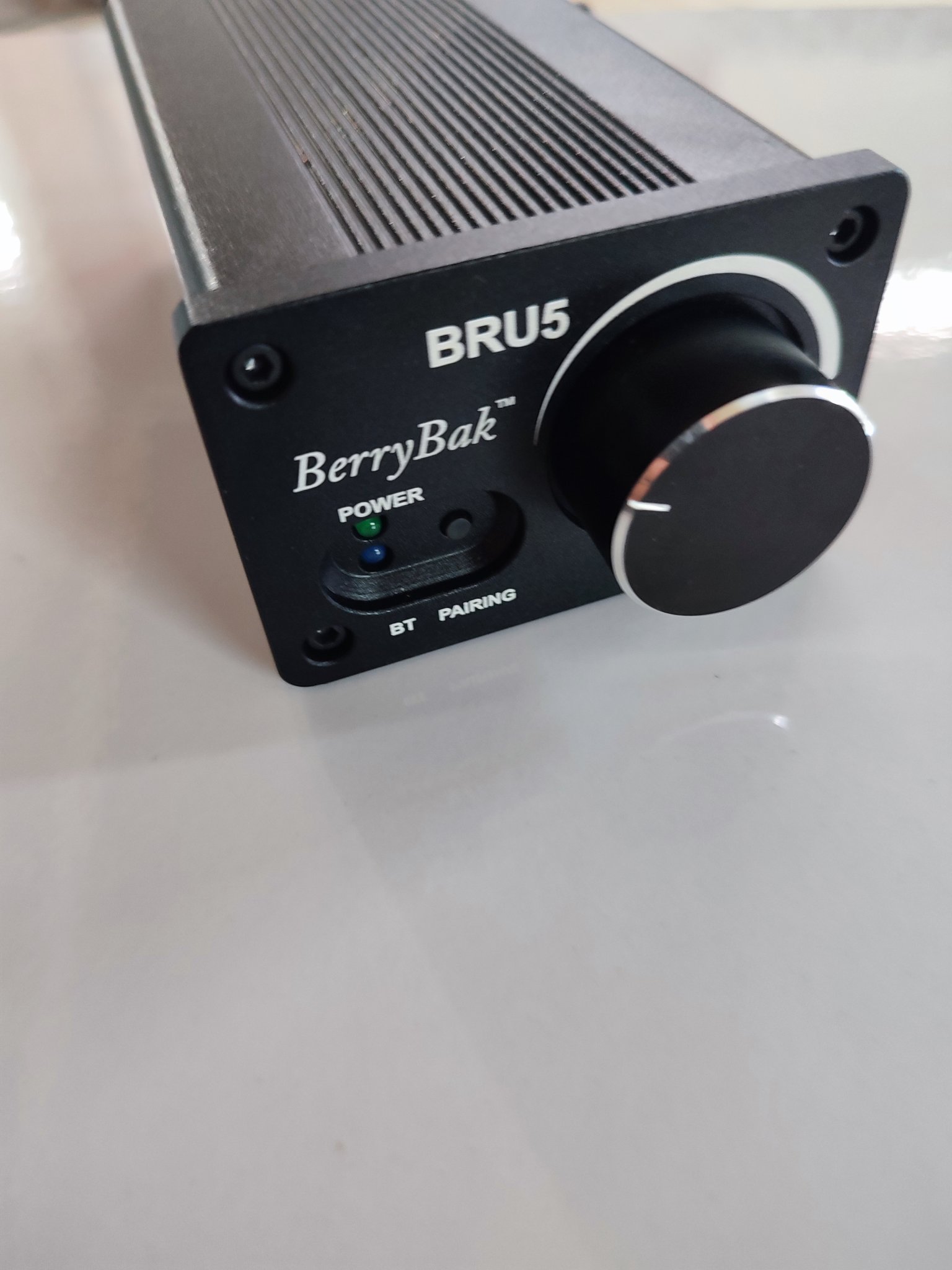

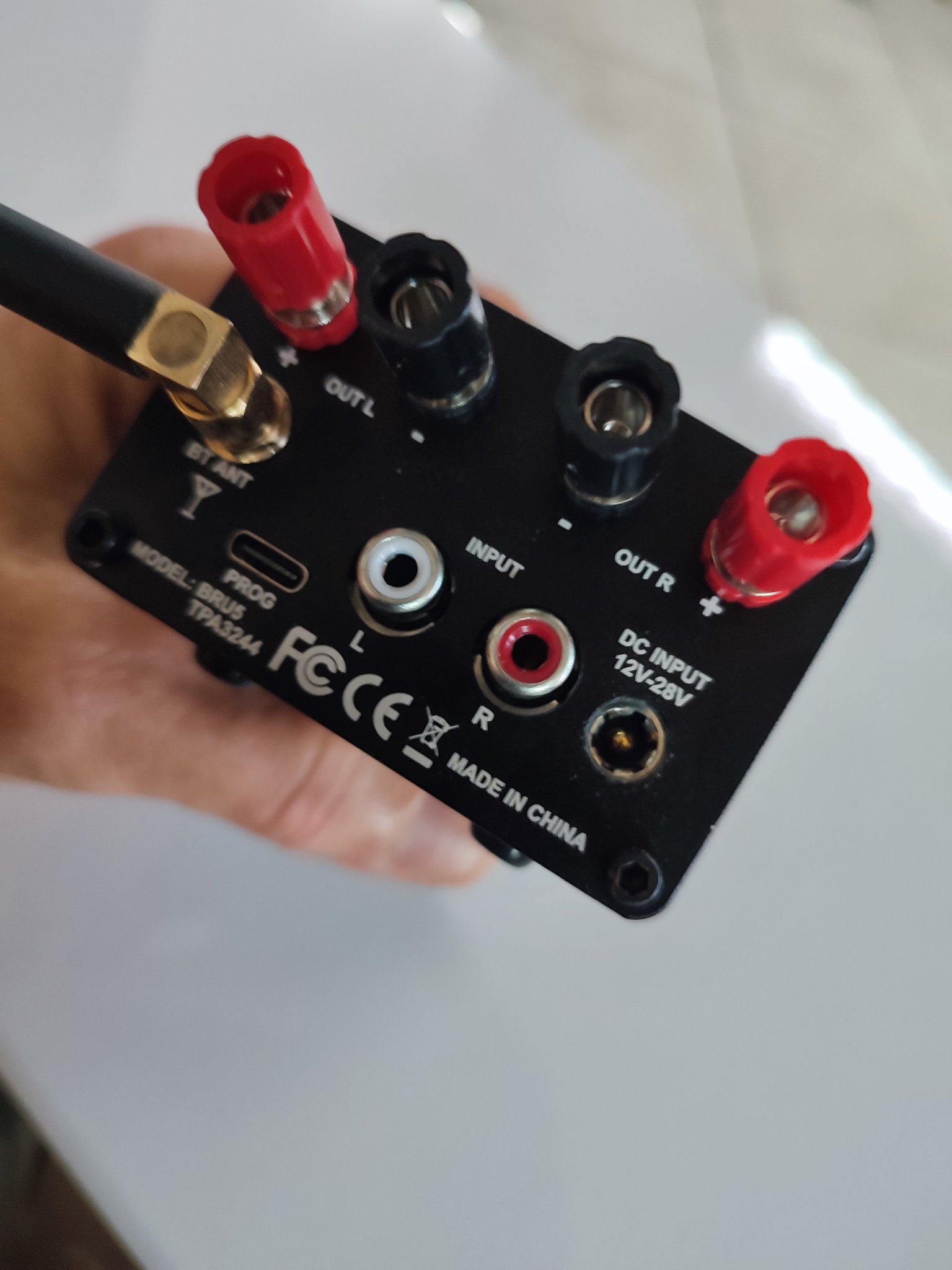

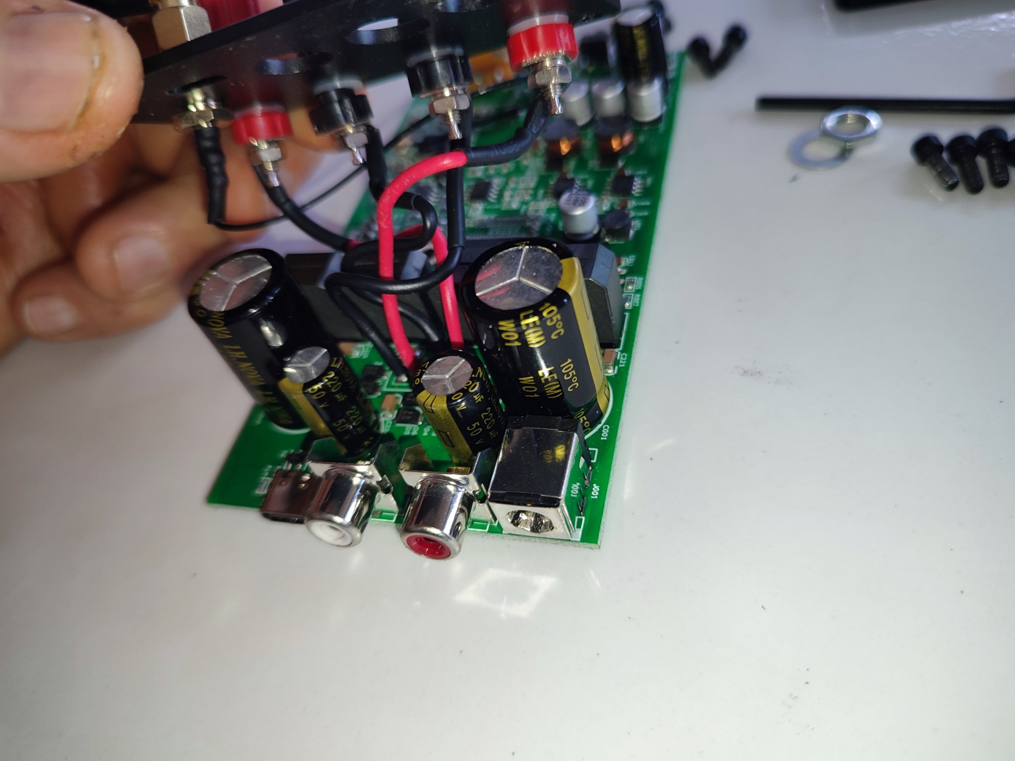

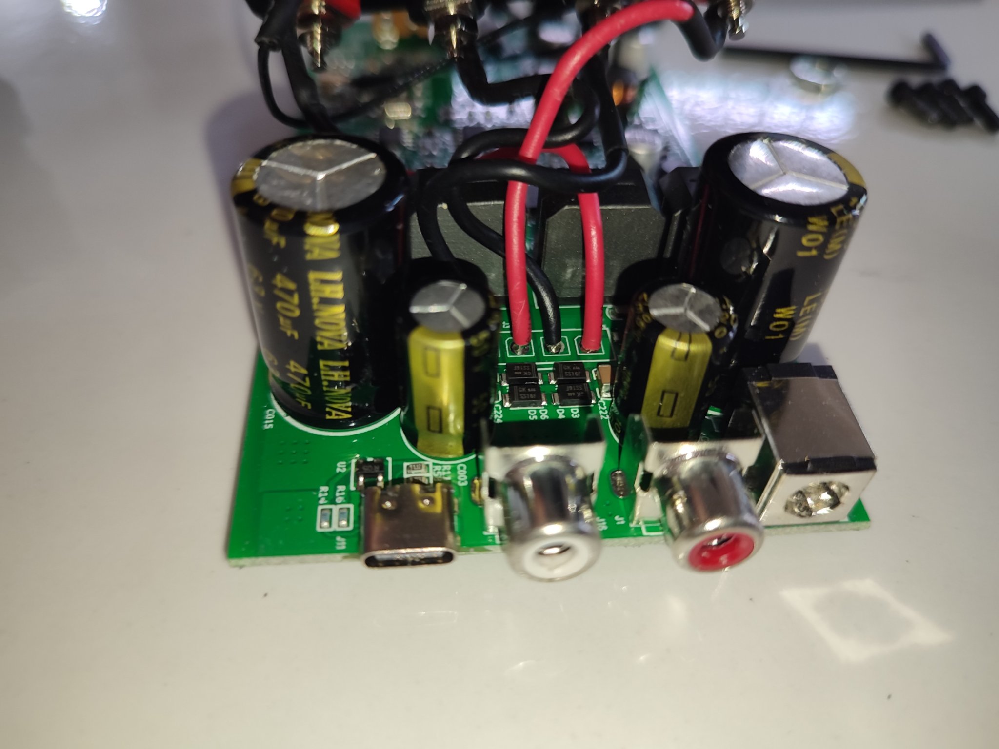

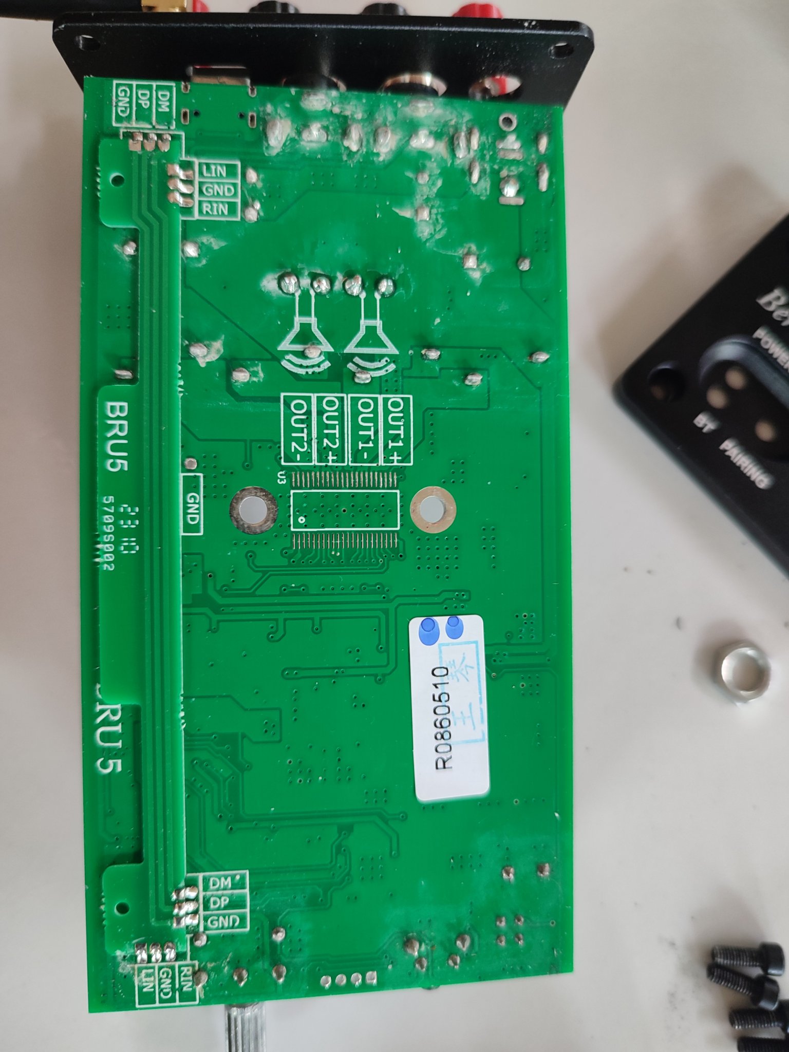

I noticed that the output of the the BRU5 was not as loud as I would have expected at full volume (and no I didn't try to blow my speakers up - I have a pre-amp down line} I suspect it would be the input sensitivity. Odd as it is often the case that someone recommends a resistor tweak to lower the range (some 3116 boards)
I installed the amp this morning with a little frustration. I wired it according to the case markings on the rear, Rt IN and OUT on left of the rear when viewed from the front and L on the Rt.....a bit weird. There was something not right as the sound was skewed to the L and it sounded really weird. Swapped the connections L for R as you would expect when viewed from the front. Same problem. I left the INs as were and swapped the L & R OUTs and bingo!
When this is a few months old I will sort the DC socket and see if there is scope to change the IN and Out orientation. Not really SURE (did you see what I did there) why these amps would be intentionally wired like this and it may have been a production mess up.

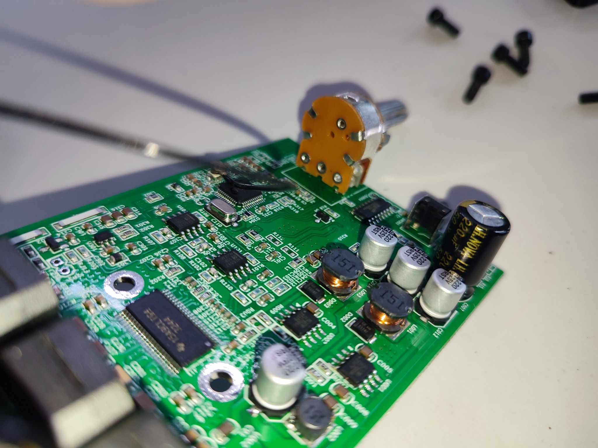

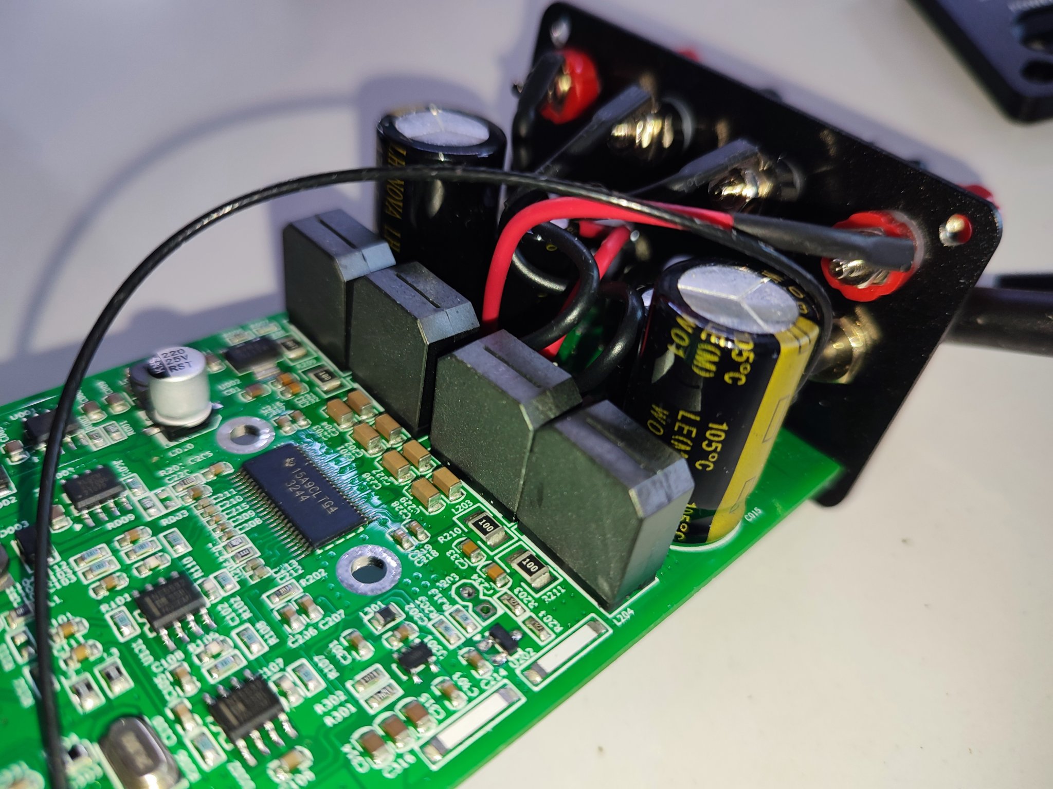

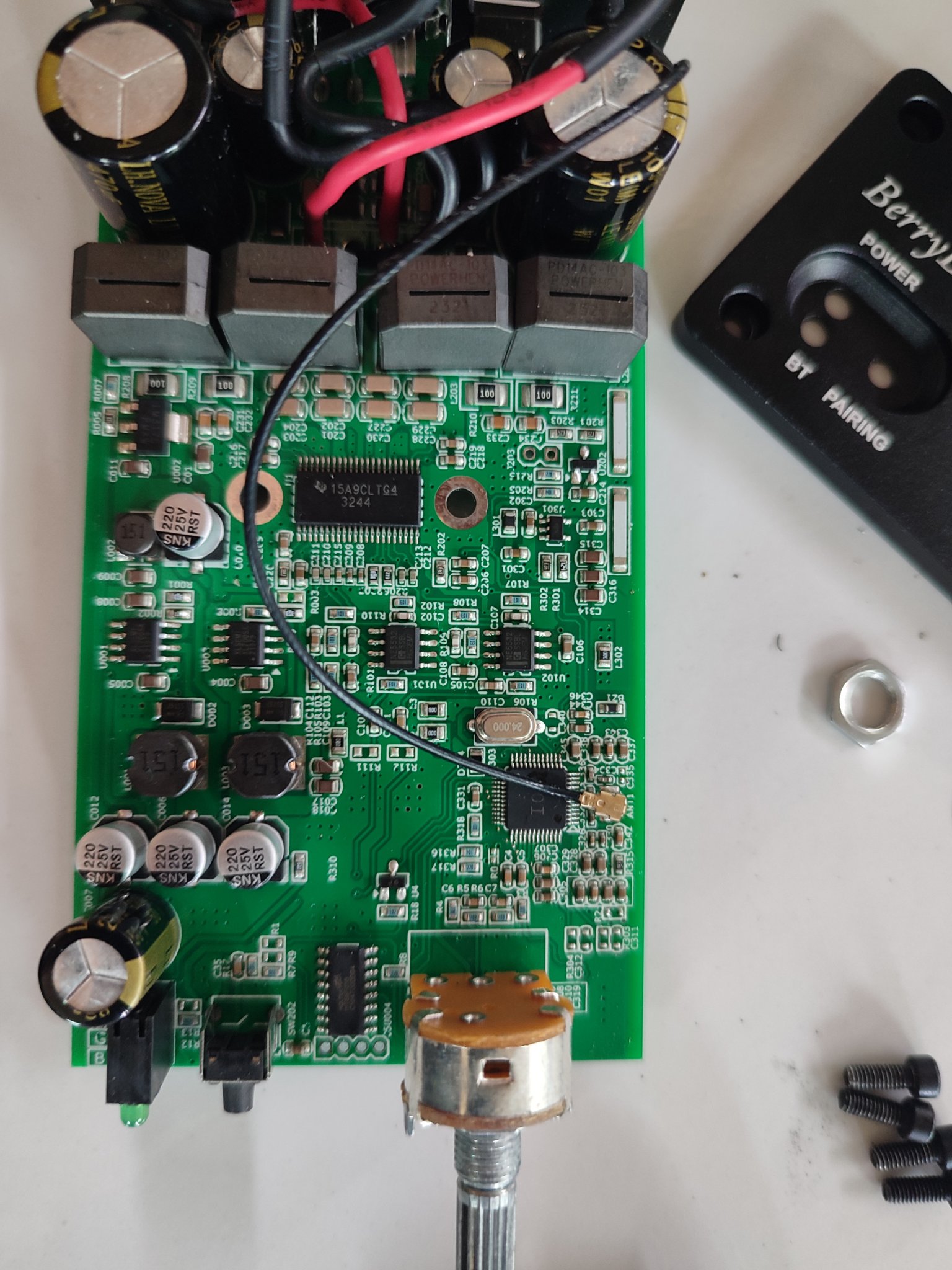

Looks like two NE5532 in the pic posted earlier, surface mount so swapping them might be challenging.
Doubt I'll bother, it already sounds better than my TPA3116/8 boards and the T amps I've tried
Maybe this could be useful for replacing op amps
https://www.aliexpress.com/item/400...069f93a4f678905d120fc6f8f7a&afSmartRedirect=y
I'm very sceptical when it comes to swapping op amps by trial and error. You can certainly change the sound if you installed one that didn't properly meet spec lol. I doubt any significant audible gain will be achieved but it's a cheap wee amp so no great loss etc 😉 maybe someone else will suggest a worthwhile mod but I'm very happy with mine as it is, its an absolute bargain (I,ve paid more in the past for a volume pot)
