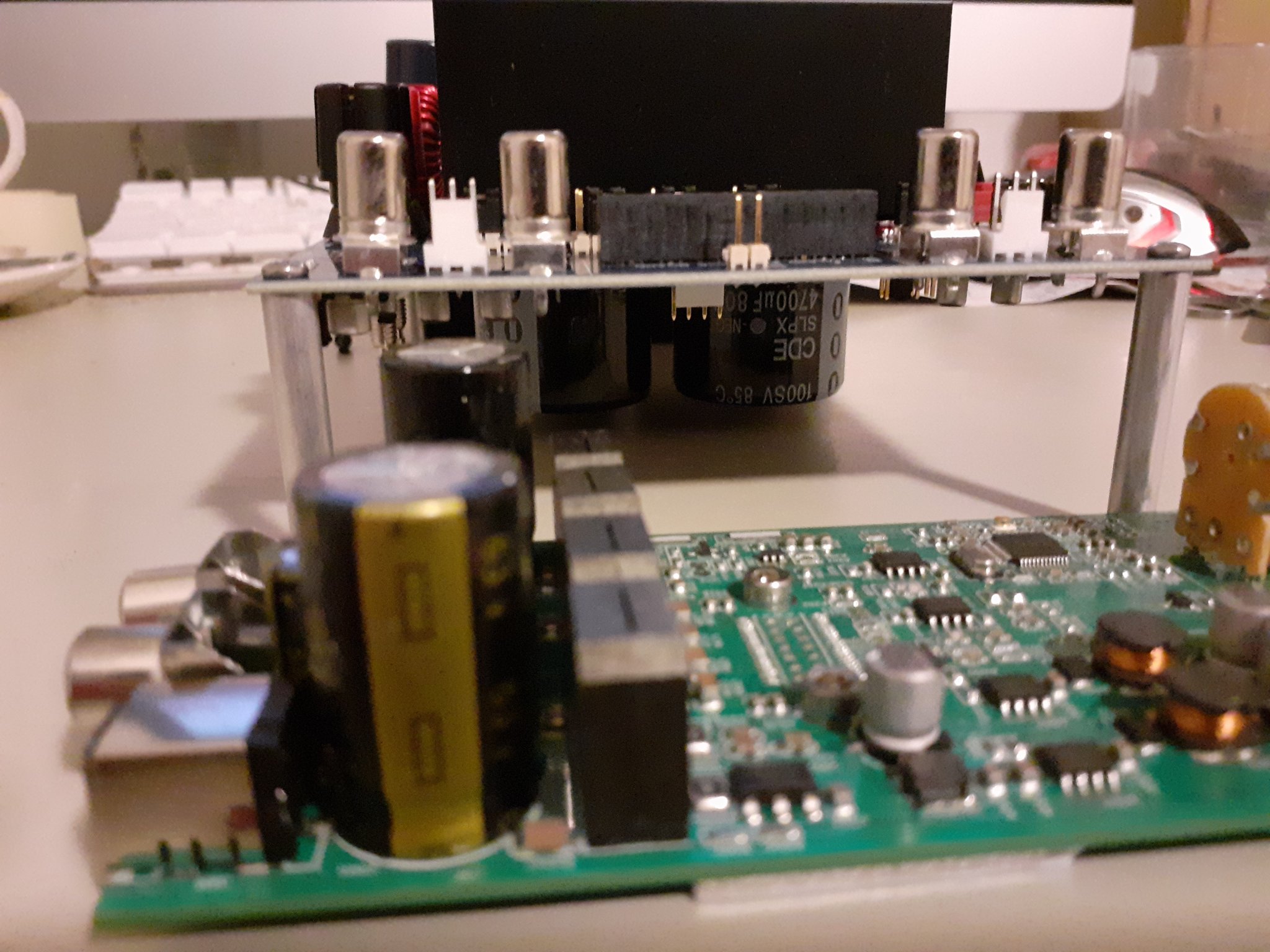

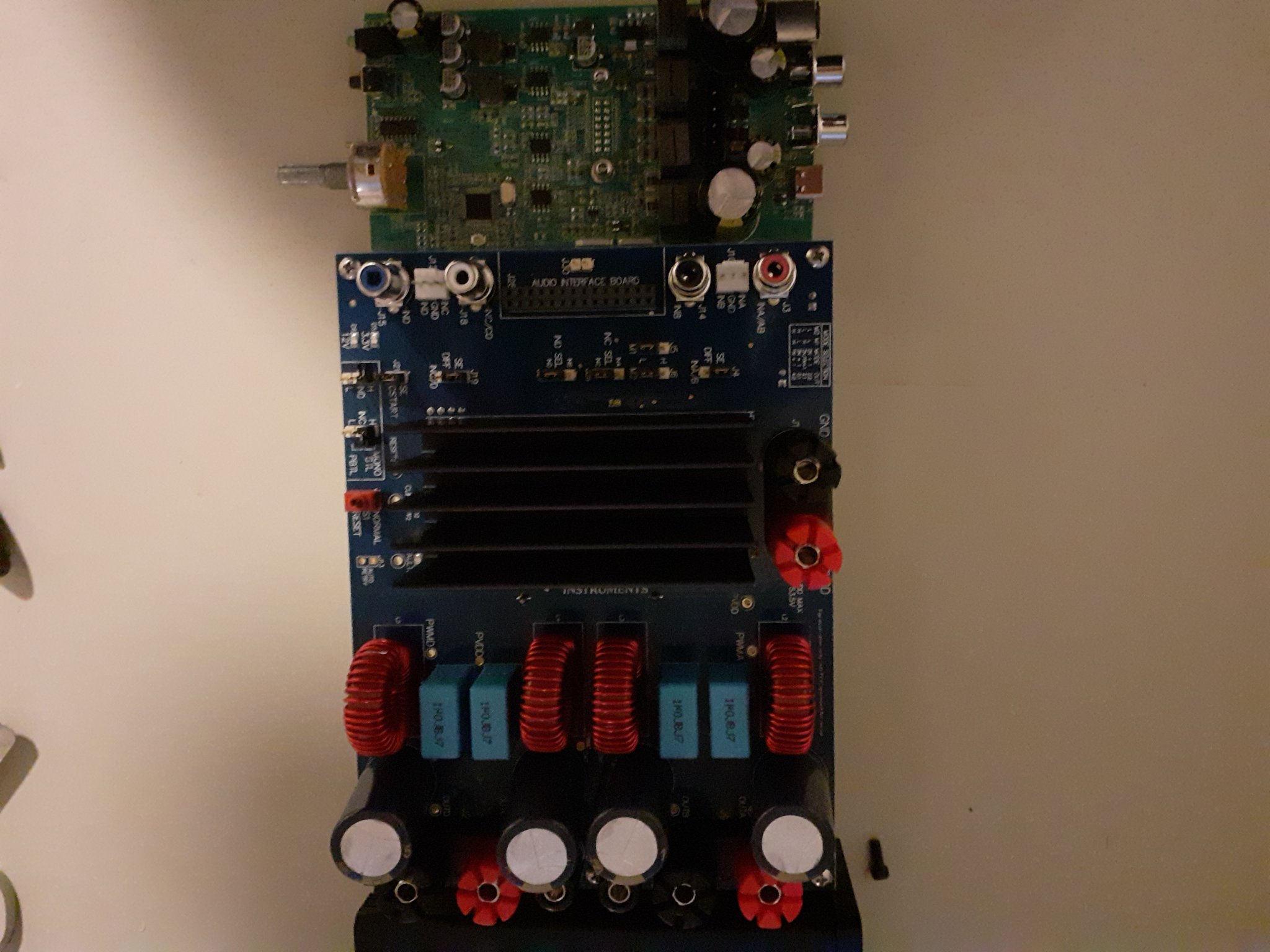

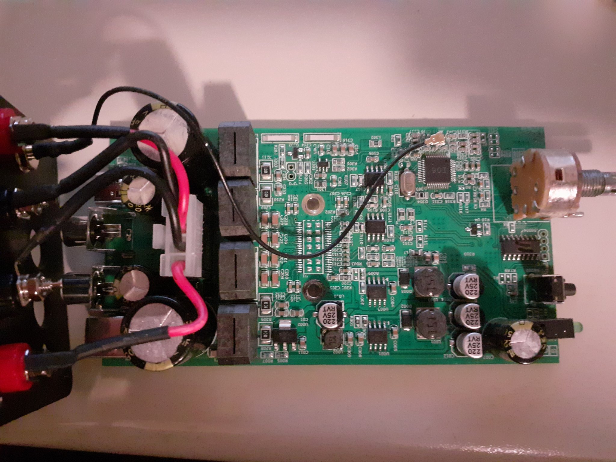

Haven't received software yet, but amp is configurable/reacts when I run a ACP workbench .exe file I had, don't know if it is the correct software for this amp, but I boosted 100Hz by 10dB and switching on and off is very audible, a karaoke removing of voices function works too, the usb-c to usb I used is from a Samsung mobilephone charger, connected, some parts of the dull grey graphics turn blue, seems to function ok, just didn't read a manual yet Amp is really small, I think I will post a photo of this ampboard next to the TI EVM to show the size difference, when I check the pcb (chip), one of these days. I did look at the pcb, chip is on bottomside with a piece of metal screwed on, which transfers heat to the little enclosure. Inductors are like Sagami TH, flat wires soldered through pcb, more than 2 layer pcb and the aux in gets an small long piece of pcb placed on top of the main pcb, to get connection to the front, weird. PCB has also a topside optional footprint for a tpa32xx.
Thanks for the internal pics. This confirms that the printing on the case is incorrect on mine and probably others, the bottom of the PCB has OUT 1 and OUT2 marked. If you flip the board over L OUT is on the left and R on the right. The details on Aliexpress are attached.

I don't know. I also swapped the red and black speaker outputs, not very important maybe. I think the plug on pcb should be turned, I tried desoldering but that didn't go easy so I decided to unscrew the terminals and swap the wires. Easiest to swap on the outside obviously But left right, phase and red white and black is often a little funny:

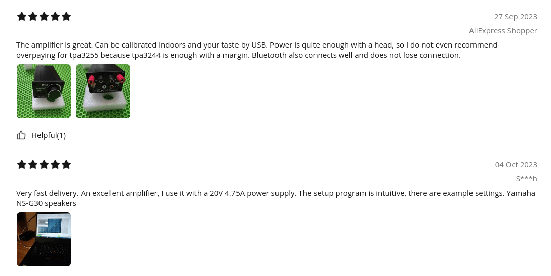

anyone bought the TPA3244 version of the Wondom BRU5 ? $27 on Aliexpress
Looks like it might be respectable (if not superior?) for people with high sensitivity speakers, that don't need all the power of the TPA3255
