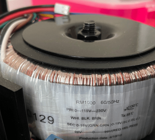

1. Power supply: Start-Protection-Rectifier-Electrolytic 2x200v.
2.SMPS + main amplifier D (8 MOSFETs).
3. Linear power supply: The transformer(Thor).
4. Error correction amplifier 100W (class AB).
5. Control, indication and switching unit.

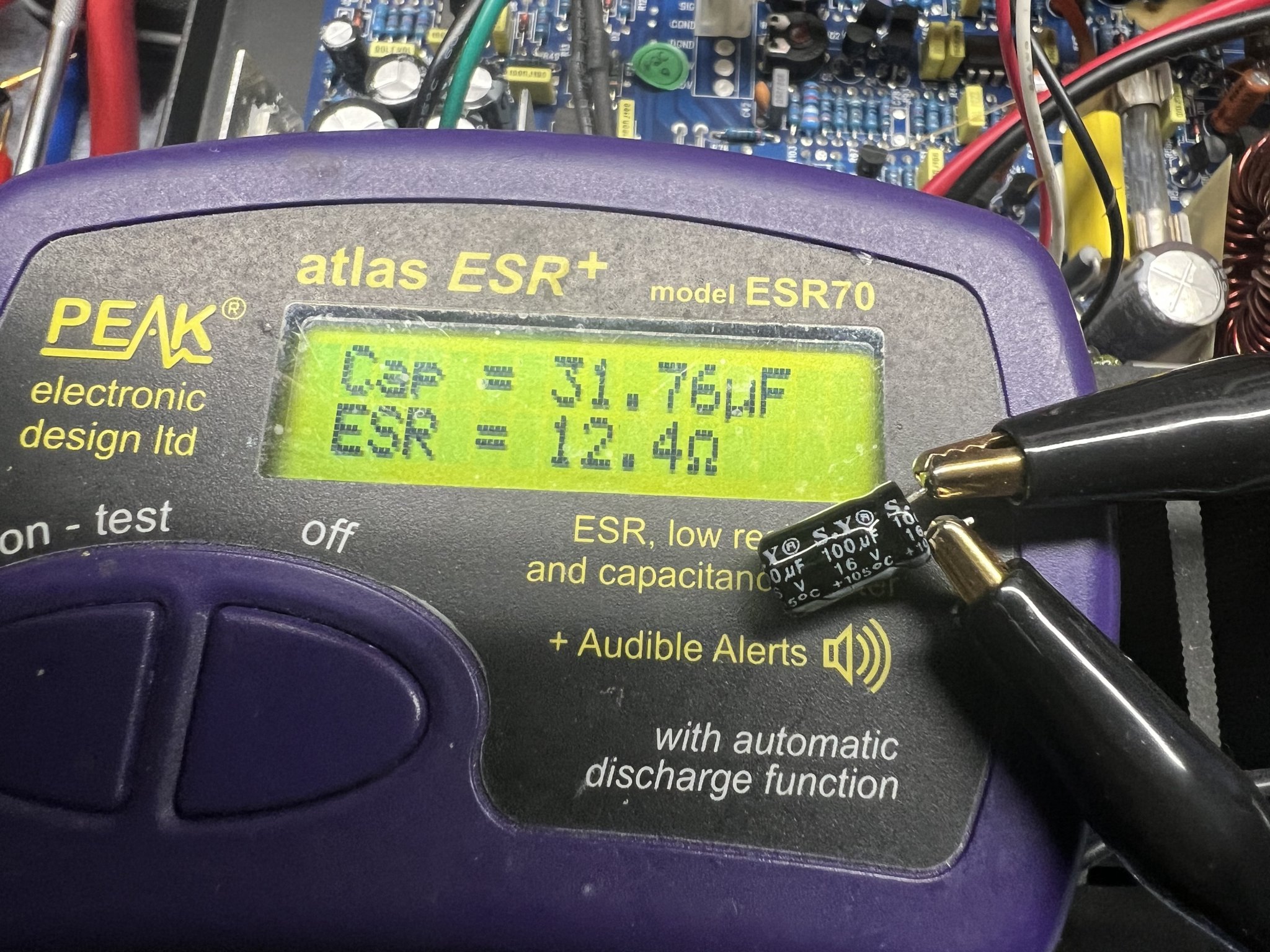

I just benched it. It’s on my 1000w rated isolation transformer and I was running a pair of 16 awg wires, but only 3 feet long. Two sets of speaker wires to attach my two 8 ohm dummy loads. I got a clean 750 watts and then the waveform started clipping. Not a clue what distortion numbers were at that point. My 2000 watt dummy load got pretty hot. So yeah, I don’t see how in any scenario this thing can reach 950 watts into 4 ohms. Disappointing that they’re fibbing their numbers, but at the same time 750 watts should be plenty for a pair of JBL 2245s. Oddly could have sworn that the blue led changes to yellow when it gets close to clipping when I’m driving it hard and I saw non of that. Maybe that’s a different Dayton amp….

I was feeding a 40 hz signal, tried with subsonic filter both on and off and it made no difference. My scope was measuring just over 54.6 volts output and into a four ohm load my math suggests just under 750w. Not sure if that equates to RMS or not, I’m guessing so since it can sit at that constant output until either the dummy load catches fire or the amp does.
As I mentioned in my first post, the whole reason I opened the amp was that I read that some were starting to fail and blow up and people found that the capacitors were the likely cause. So I pulled out the power supply and the very first cap I pull out, 100 uF @ 16v…
Darn those cheap caps! S.Y.?
