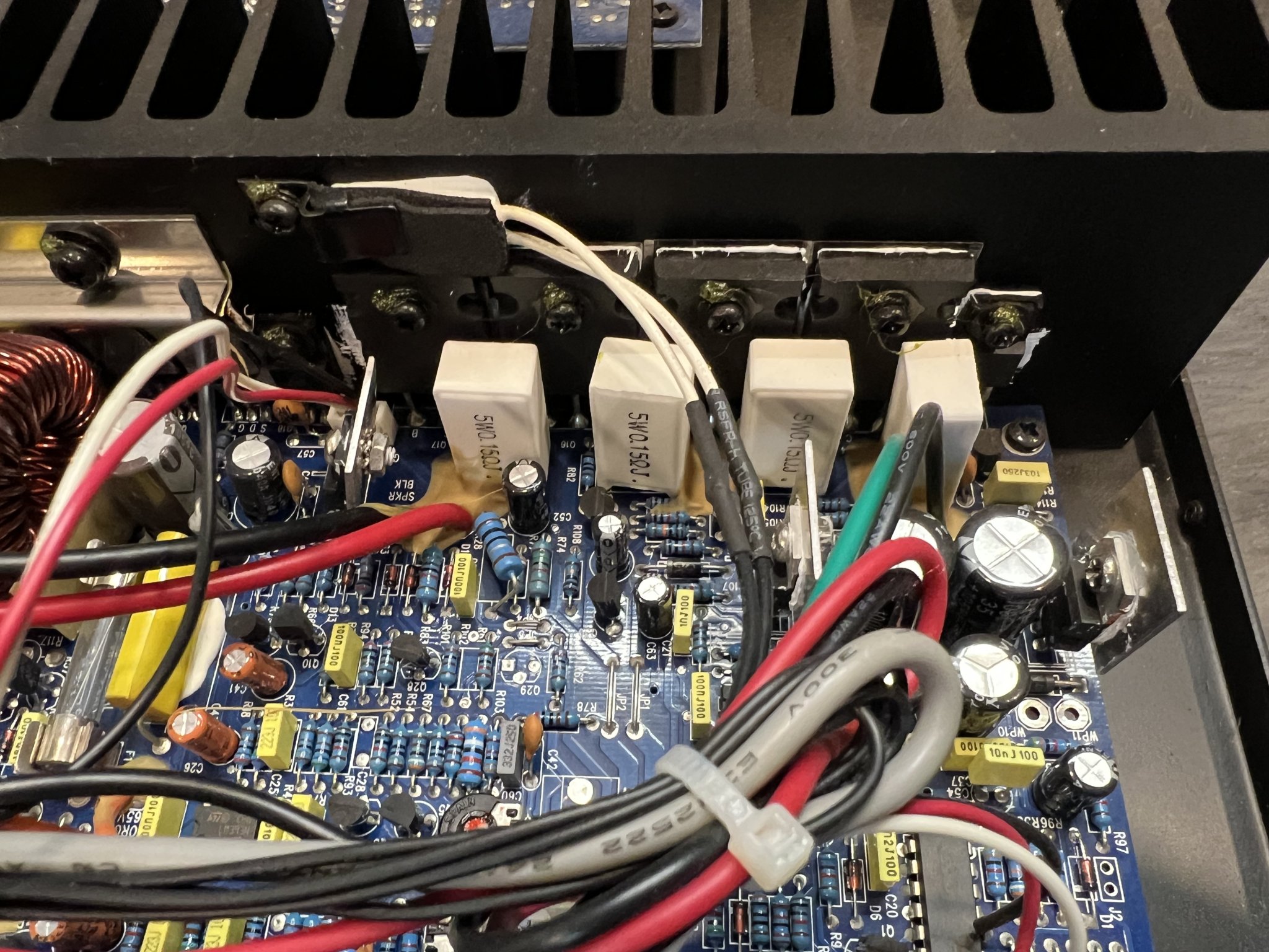

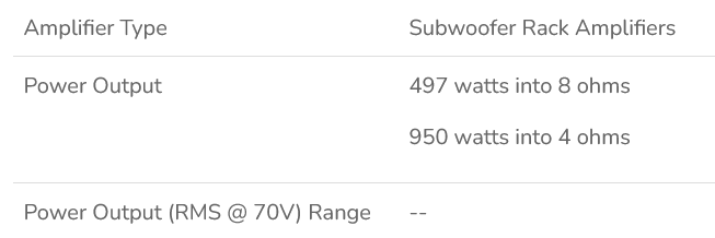

I was curious if two pair of 2SA1943 and 2SC5200 could possibly output 1000 watts at 4 ohms, well 950. I have a Dayton SA1000 rack mounted amp that I got second hand. I know the 1000 watt plate amp couldn’t make power, but I read that the rack amp was okay.

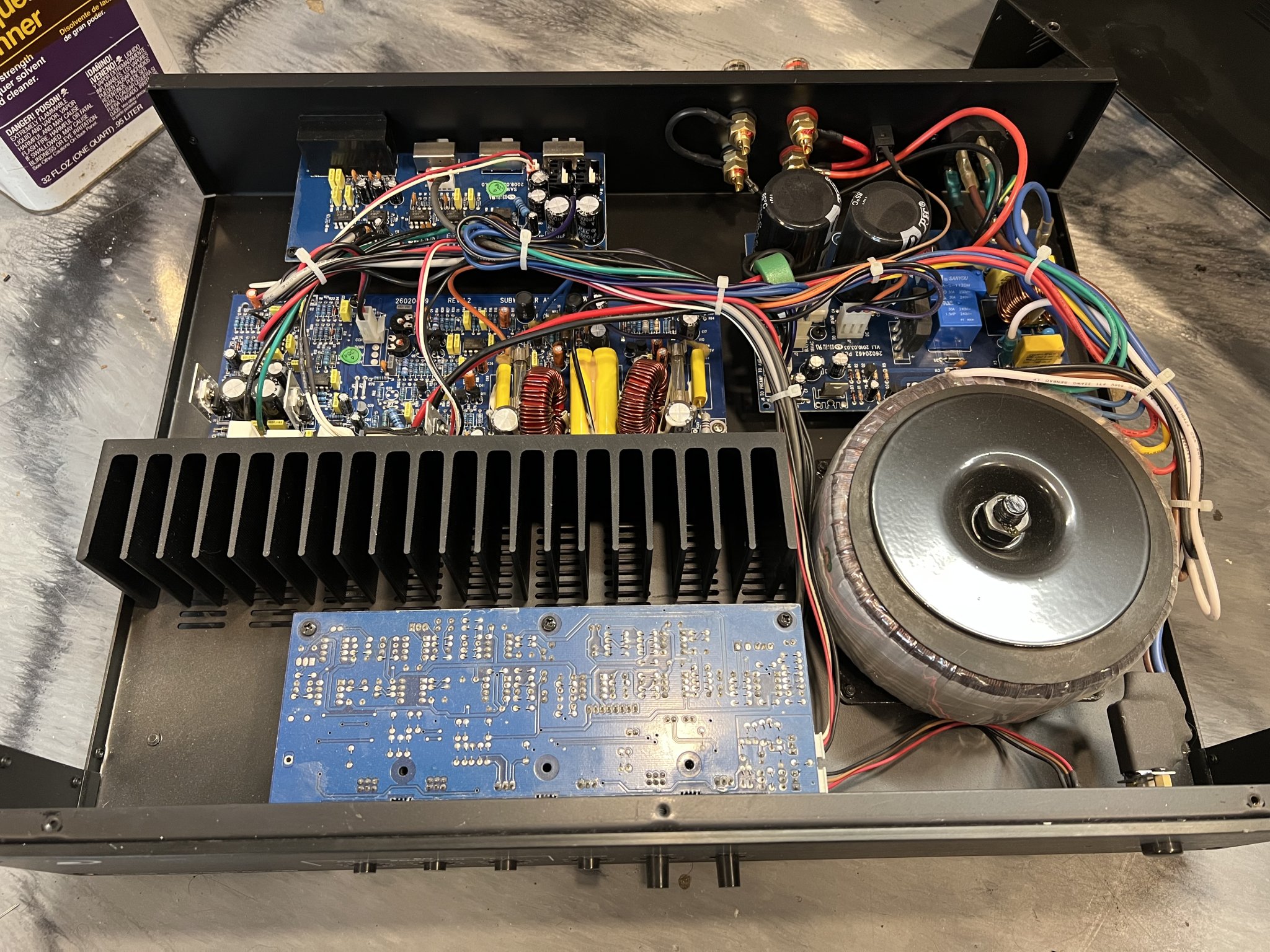

I’ve been reading that some of them have been dying as the capacitors in them are starting to go. I opened mine up to check ESR and such and noticed that this amp only had 4 outputs. I’d figure for 1000 watts RMS it would have 8 at least. I’ve never seen a standard power amplifier rated at 500w @ 8R and 950w @ 4R with only 4 outputs in each channel. It has well over 100 positive reviews, I was just surprised.

Not to mention the small heat sink, which is also mounted internally.
Looks more like 50W/channel, not 500W.

Heatsink or not, these transistors would leave their SOA in such an application. 1000W on sine means 2000W peak, which is 22A @ 4ohm, and they are rated for 15A only. Not to mention their performance decline quickly after about 4A. The data sheet says they are good for a 100W amplifier for a reason.

As a standard class-AB amp, no, two pair is not enough for that power, but I see something on the other side which I suspect is a tracking switch-mode power supply like the Yamaha hybrid amp. Check the filter cap voltage and do the math. But, of course, if you can measure the output, that's the bottom line. If this is a hybrid amp, then the modest heat sink and output transistors makes more sense, but calling it a class-AB is misleading.

Not on that heat sink. Not inside the chassis. Not with the transistors mounted right next to one another.
Manual says rated at only 1/3 duty cycle, and full power is nearly 1% distortion. And a sub amp with measly caps?

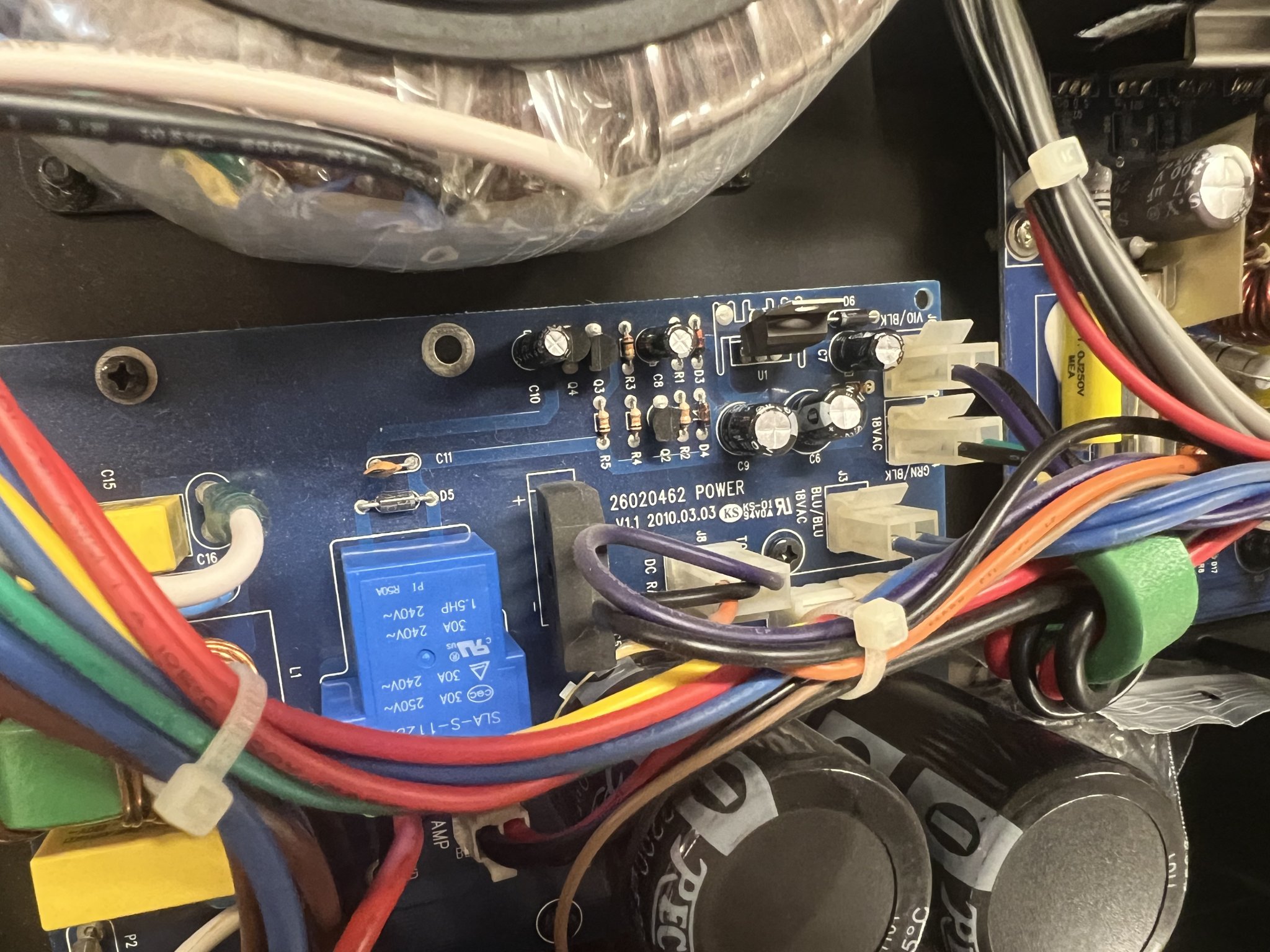

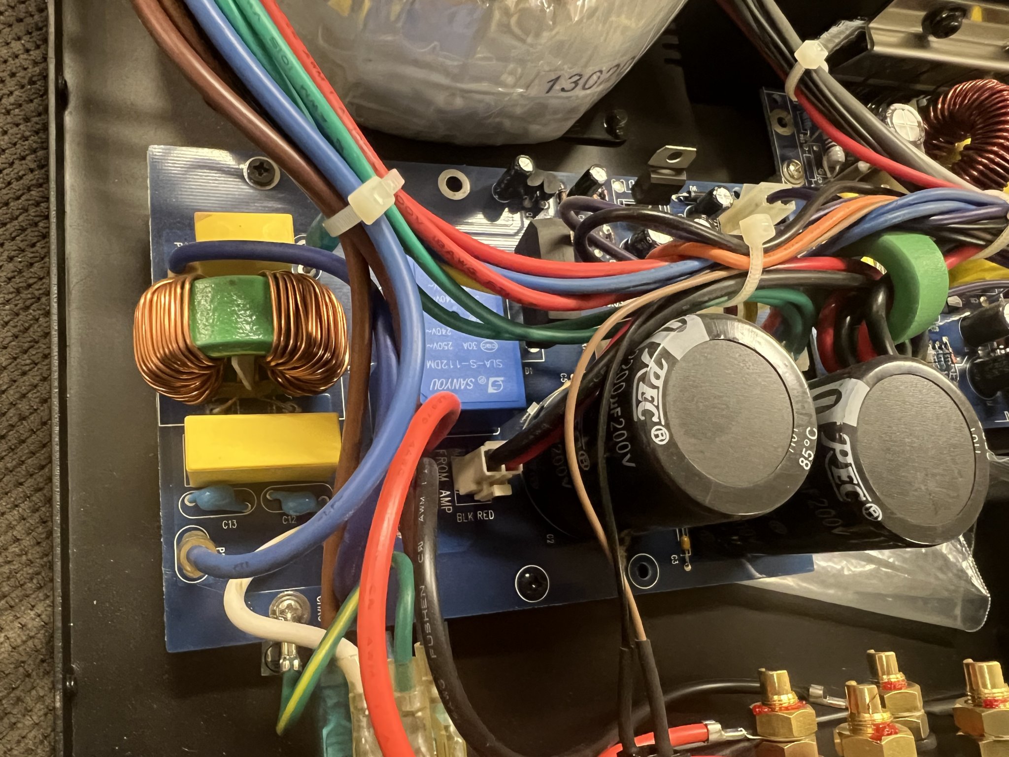

Which side are you talking about? Here are some closet pics of the power supply board. The filters are rated at 200 volts.
I also took pics of the board right next to the power supply as it too has 200v rated capacitors.

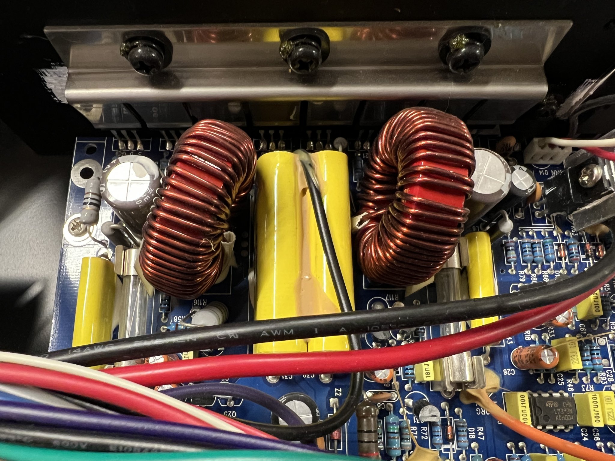

That amplifier has a tracking downconverter power supply, which reduces the power dissipation drastically. Four output transistors may very well be fine for normal use. Plus the switching mosfets, of course.

Thoose inductors seems that something has switching the transistors are rated at 150 watt, but if the amp works in class H things are different,
950 watt I doubt but if works in class H power levels of 500 watt or a little more are pretty dam possible.
