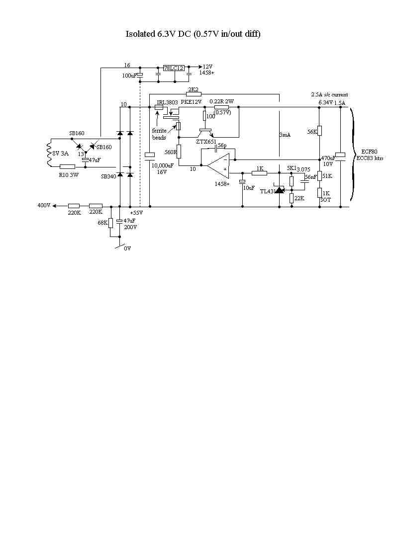

The DC line shift (this is bad) is probably caused by those wretched wind turbine power modules with a non symmetric zero shift.
I currently have the heater referenced about 25V up, but I can try grounding them via a pot, I have a 100W wirewound one in my box somewhere. But shouldn't hum from the heaters have disappeared when I set up a DC heater supply?
Yes, generally. Since you have a DC heater then you won't improve much more. You mention lifted off 25V off ground, presume with a decoupled hivalue cap ?
Have a look at the pic enclosed. I assume yours is sim.This is one of my older discrete circuits of the early 1970's with excellent performance and I regulary use this. Ferrite beads are required to dampen the mosfet. On Lower LH side, the 47uF cap on the split off ground lift off plays a big part in eliminating the commonmode hum component.
The world is short of single brick high current LowDrop out regulators over 2A.

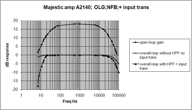

Your circuit has an open loop characteristic set by circuit gains of all tubes. A closed loop (global nfb in our case) is a small calculated sample signal taken from the output and sent back to the input (usually cathode) and will reduce the gain, I've mentioned a typ figure of 15dB for this type of amp (in the example 15dB =5.6x gain reduction) which will flatten and extend the overall amplifier response. There are restrictions to how far one can do this without running into instability at both upper and lower frequency ends and requires skill. The first step is to plot an open loop response.
See enclosed pic. This tube amplifier is a top notch 150W performer and the top curve in graph of open loop gain of amp without global nfb, and your amp would have something sim, perhaps response falling off bit sooner at the upper end. No two curves are the same, the o/p tranny being the unpredictable component. The remainder of the graph is with global nfb connected and optimised. Notice how smooth and stretched the response has become.This isn't snake oil. The only sacrifice is loss of gain.
My favourite to do the many performance graphs after an amp has been designed, as the purpose is to ensure stability and proper performance with long loudspeaker leads and various loudspeakers. It is a long physics subject but very fascinating one.
I let Morgan Jones book Valve amps 3rd edition page 407 complete the rest of the stability thesis as this is eventually the design finale of global nfb..
