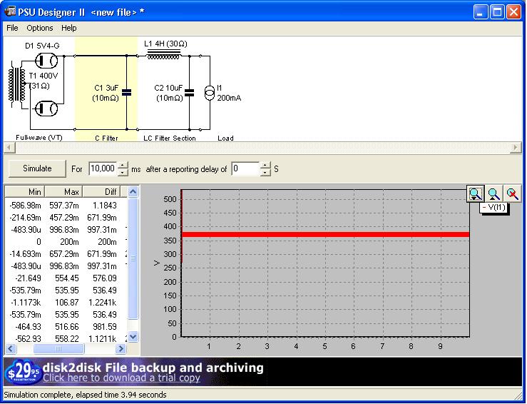

I'm just curious: isn't this circuit a bit much for a 5V4 rectifier? The specs for this tube call for a maximum RMS plate voltage of 375V for a capacitor input filter, yet the transformer used has a 400-0-400 secondary. I just figure there's something out there I'm overlooking...
If you look at the CLC, the first C is small enough (10uf) that it is still considered a Choke input filter, so you resulting Voltage should be just over .9x Primary VAC, so my guess is around 375 V.
That low value first Cap sets the output voltage on this CLC. Now a high value first C will get you a full fledged Cap input filter, and resulting voltage would be more near 1.4xVAC...
PSU designer should confirm this...
Actually, from PSU designer, that first cap should be more like 3uf to get around 375V...
I had to guess at Primary/Secondary DC resistance on power tranny and on choke...the real values can change the output voltage quite a bit...
