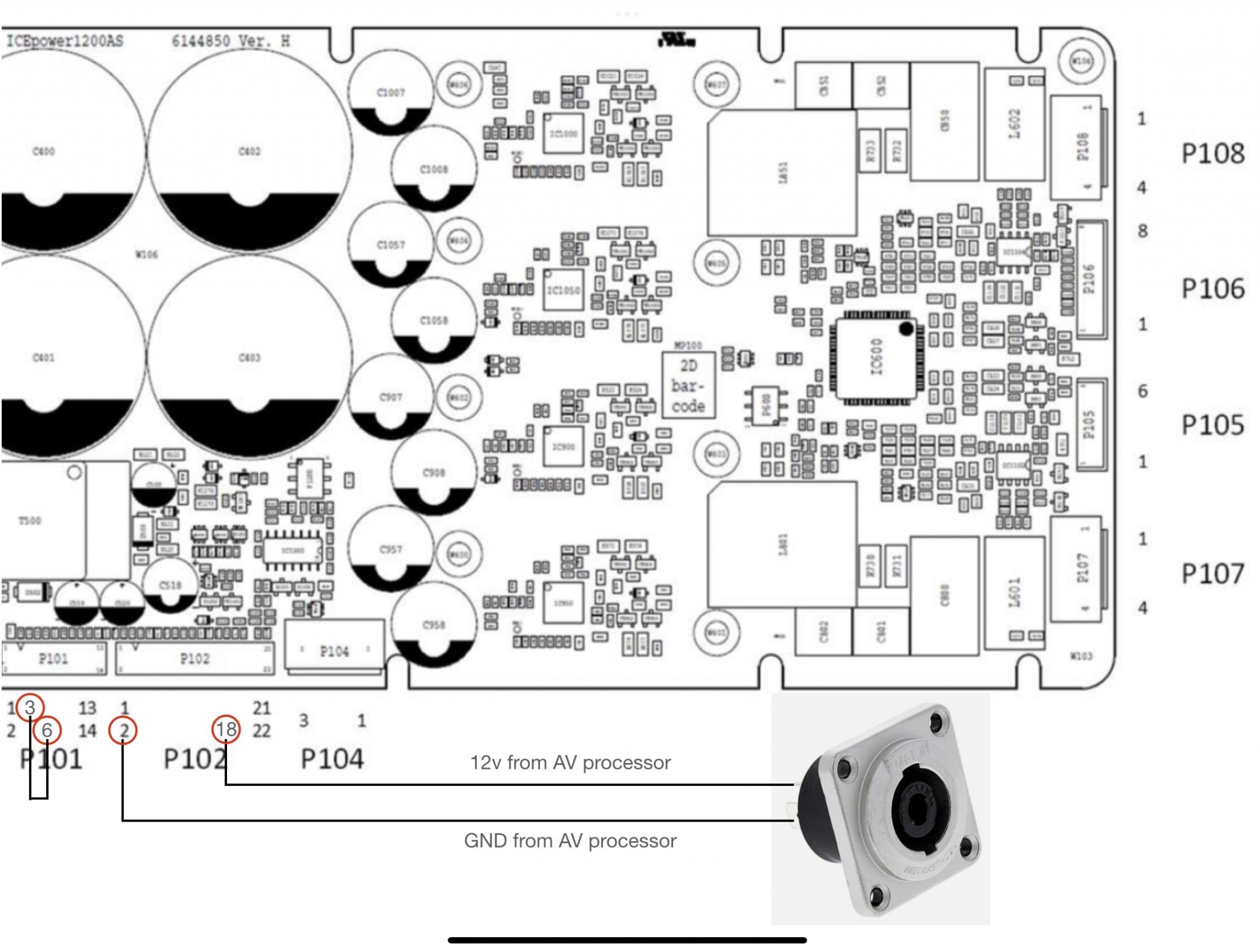

wiring up the ICEedge 1200AS2 board
Will this work?

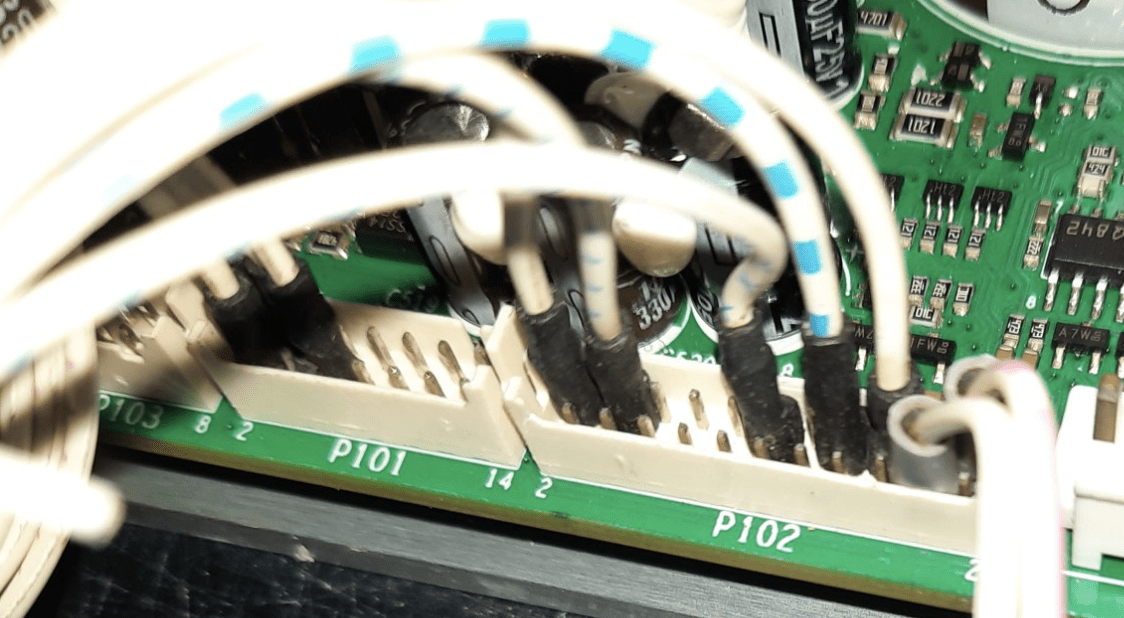

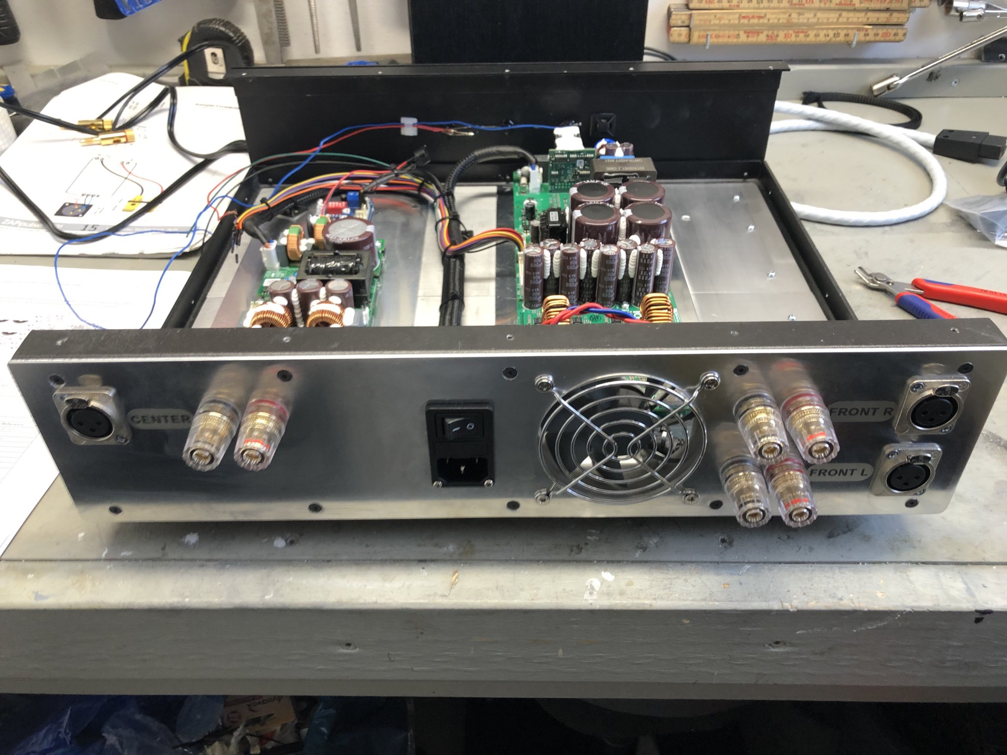

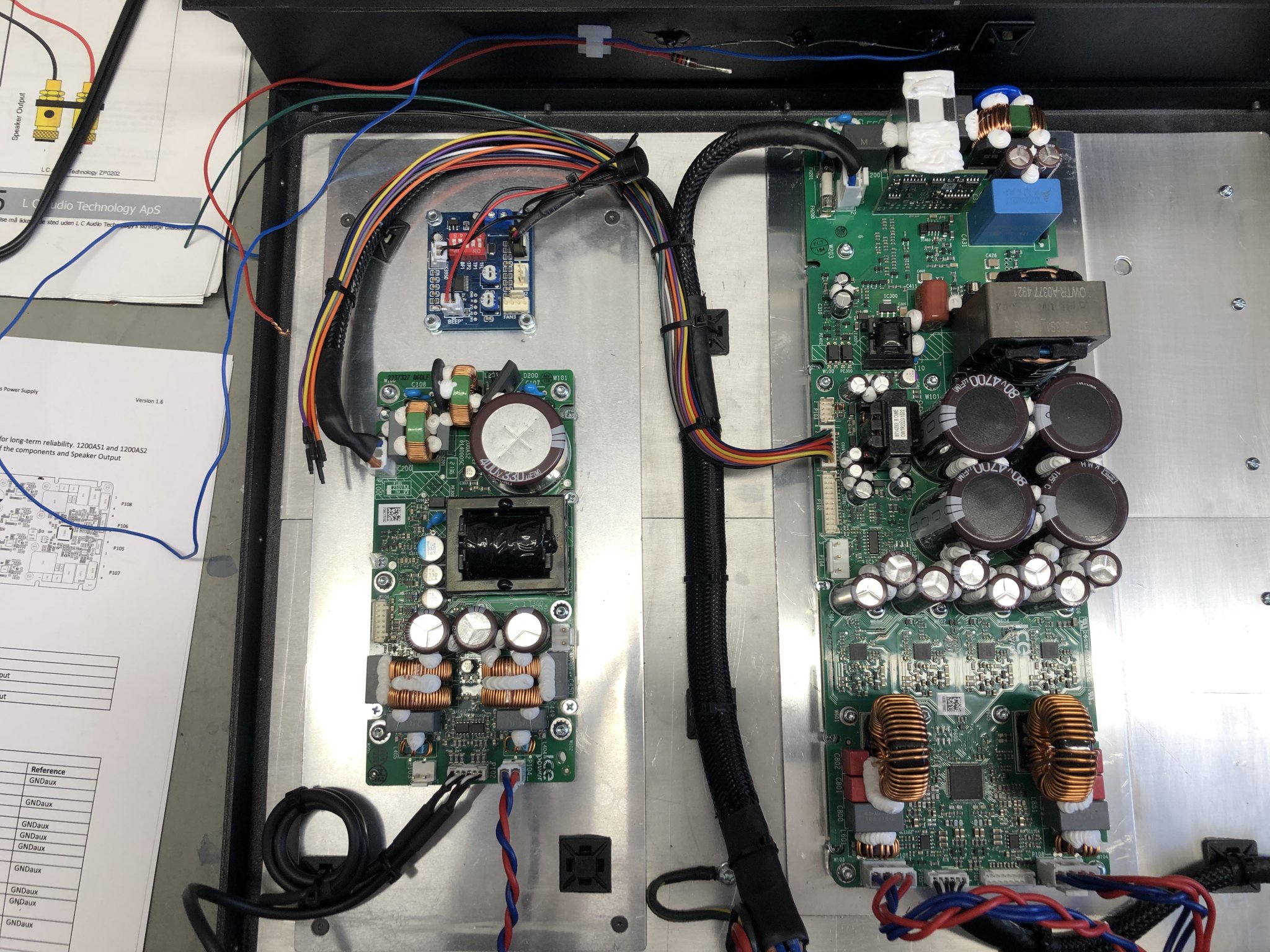

I have built an output stage with three channels, front and center. However, I don't know which facilities Ice Power offers that I should use. Right now I have only used 15v for the fan control.

The most useful apart for the ones that show the state of the module (clip,temp warnings,etc) are stand by,trigger,wake up on signal,etc.
Have a read at the PDF,it's very detailed.
You can even add volt and amp meters if you like this kind of looks,it's all on board.
I have connected my 1200as2 to an Apple AirPort Express, and it is as if the AirPort keeps the amp on. When not connected, the amp go into standby correct, so the control wiring should be correct. I can’t measure any mV when not playing, but maybe the Airport periodically has some output and this keeps resetting the SignalSense timer. Any ideas?
