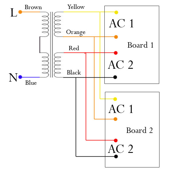

wiring up a transformer (brian gts kit)
Does the PS board have two terminal blocks for AC in? Each with two terminals? That's the way it looks in your rather blurry photo.
