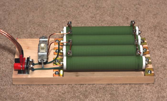

I'm a little late to this discussion, but a little while ago I measured some large wire wound resistors. Using my quick and dirty LCR measurements, wire wound resistors do have some inductance, but it is so very small for the resistors I measured that the inductance gets swamped by nearly everything else.
I have attached an image of my resistors, I use these as a dummy load for measuring amplifier output power.
Here is the link to the measurements I made of them

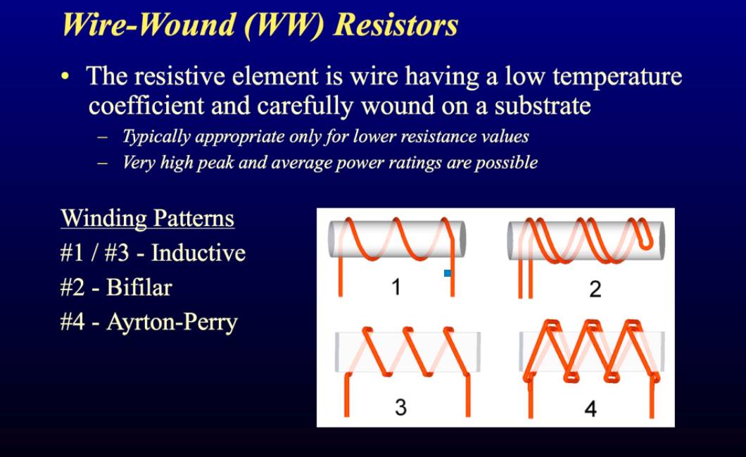

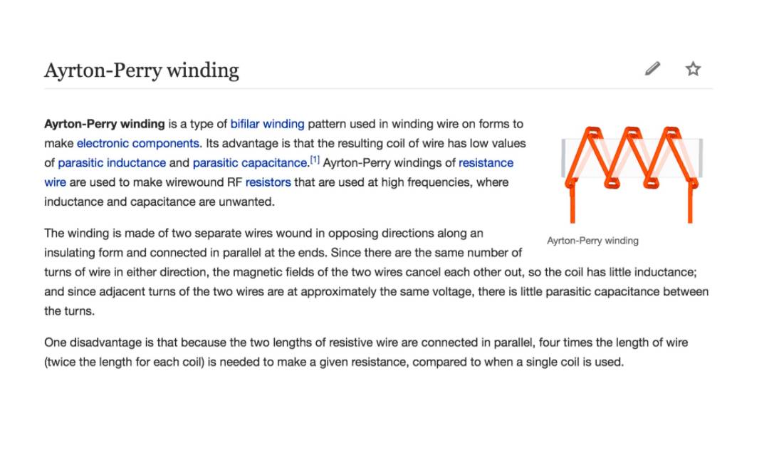

I'm not sure where I originally found these, but here is some additional information on various ways that wire wound resistors are constructed.

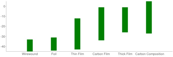

Resistor Noise >> Resistor Guide
Very low noise resistors 🙂
Wirewounds are the best for use in the input stages, preamplifiers, phono, crossovers etc.
My personal experience: metal films were replaced by wirewounds in valve line stage and sound is incredible now.
The cost is high for MRA Mills but industrial quality and Ohmite are affordable.
Is worth to try, but not many audio Diyers do in reality. Have a nice day
