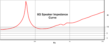

Loudspeaker datasheets usually have impedance versus frequency graphs in them. The low-frequency resonant peaks are very dependent on the loudspeaker enclosure if the back side of the loudspeaker is open. The high-frequency part of the graph does not.depend significantly on the enclosure.

Many thanks to all who have responded, I think that answers my question - one point though - does the impedance of a loudspeaker vary from its dc ohmic level when driven within its useful frequency range ?
Yes, very much so: think of the resonance frequency.
It is an extreme, of course, but if you look at the impedance curve provided in all good datasheets, you will see that it is far from flat, even if you exclude resonance

In fact, looking at such graphs as you suggest, I see that impedance starts at a given level, then rises (steeply in some cases) at the speaker's resonant frequency, then falls to a level close to it's DC value before rising gradually with frequency.
The nominal impedance of your speaker is 4 ohm. You may regard this as a sort of average value for the impedance of the speaker (which, as you say, varies with frequency).PS: I am in the process of constructing an active system, using speakers which although labelled as 4 Ohms, actually measure only about 2,8/2,9 Ohms DC. Such a low impedance would be unacceptable - hence my original post querying wire-wounds.
