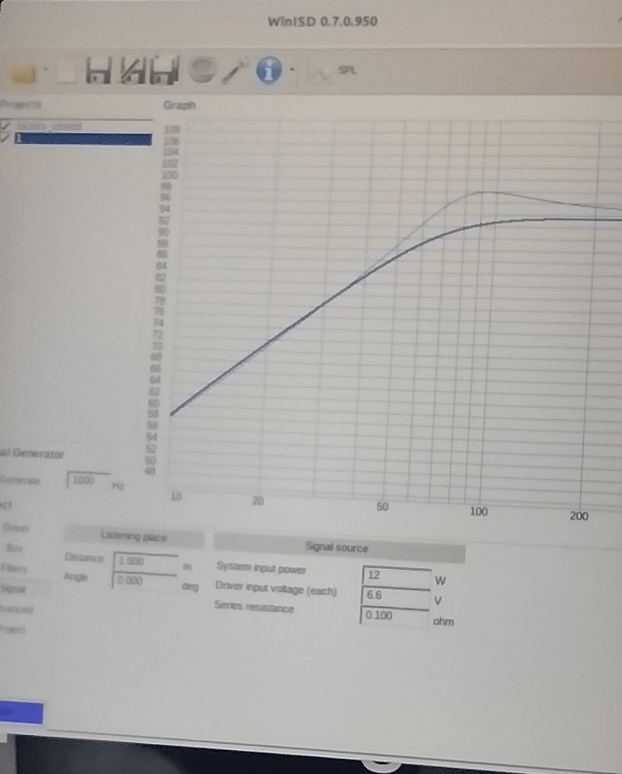

I use Wine to run WinISD with Linux. Sometimes I use a magnifying glass to enter data 🤣
I have a second monitor and what has worked for me is set it up to have less resolution with the same aspect ratio. Those fonts are very pixelated in any case but I can manage.
I set the secondary monitor to 720px width, displaying frequency up to 300Hz and this has never looked better for what I do.
Still running it with Wine, PC with Ubuntu. You can even see the units in this bad quality phone photo.
I should have tried this before.
