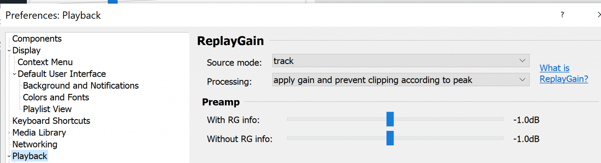

Use WASAPI Event with the Focusrite. Set the Focusrite as above in Windows. In Foobar :
It may seem tricky but its just a case of getting the settings configured and your done.
Thank you for these screenshots, much appreciated and very usefull. Unfortunately the replay gain did not work, nor did the earlier settings in Windows Sound and Foobar. According to the windows settings the headphone is still using the Realtek driver.Use WASAPI Event with the Focusrite. Set the Focusrite as above in Windows. In Foobar :

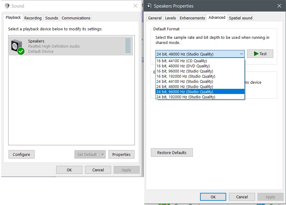

Thanks for the suggestion. One of the problems was that the FocusRite would only be set to 48Khz which meant transforming the 44100 recorded music. Fortunately I found a work around and I've managed to switch the FocusRite Solo (2nd Gen) to 44100. Sound cleared up a lot but another problem popped up: I've got some ringing in the speaker crossovers (or in the tweeter), right at the crossover frequency which is very annoying. Had not noticed it before so now working on solving that issue. All fun and games.I don't know if you've looked into these little boxes, but in case you haven't...

If using Scarlett Solo, 2nd Gen., IIUC there are ASIO drivers for it. Windows only forces fixed sample rates on ASIO devices in certain cases where a device is set at "Default Sound Device" and or "Default Communication Device." To prevent that from happening is tricky since Windows can switch the settings back automatically without telling you. Therefore the best choice of audio device driver choice for Windows10 is "WASAPI Exclusive Mode." Both ASIO and WASAPI Exclusive only work with player apps that support the driver format. Foobar2000 can work with both, for example.
If ASIO is the best driver Focusrite provides for Solo, then the thing you want to do is use that. Also, its necessary to go into Windows Control Panel sound settings and get rid of the green circle with a while checkmark in it can can be seen in the screenshot below. That checkmark indicates the sound device is assigned as one or both default sound devices, which is not good. If you have another sound device you aren't using attached to the computer then you can assign the default device roles to it. So long as those settings don't change, ASIO will let the player app or recording app set the correct sample rate as needed. If there is not a spare sound device already, there are some cheap USB sound devices that can be assigned as the Windows default devices: https://www.google.com/search?q=che...SCugQ_AUoAXoECAEQAw&biw=1202&bih=561&dpr=1.56
BTW, most modern operating systems do more or less the same as Windows by default. That's so multiple apps can access the default sound device as needed. IIUC in the case of linux the Alsa sound system can be configured to turn off shared access and possible resampling.
Yes, Windows is silent resetting the default device. What helped is the FocusRite program "FocusRite Device Settings" that I overlooked when I installed the FocusRite software (it's only a driver, isn't?) and the way the menu has been set up in Windows 11. Duh. 😱If using Scarlett Solo, 2nd Gen., IIUC there are ASIO drivers for it. Windows only forces fixed sample rates on ASIO devices in certain cases where a device is set at "Default Sound Device" and or "Default Communication Device." To prevent that from happening is tricky since Windows can switch the settings back automatically without telling you. ....
But at least I now have the 44100 rate. Unfortunately FocusRite cannot be set to exclusive if I want to use the internal laptop speakers. As long as I do not unplug the FocusRite then Foobar keeps on using Focusrite at 44100 otherwise things go haywire again with Windows resetting defaults. And Windows natively (with the Realtek) will only see 48K, the other settings are not visible (I'm pretty sure the vendor has customized the settings)
