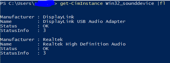

Can you help me locate DAC information, and such as what sound cards does my laptop have? Secondly, what factory DAC and chips does my laptop have? I managed to find most specs, but the DAC info seems most elusive with most brands I was not able to pull up any details regarding what digital to analog converter is onboard.
The Laptop is a Dell Alienware, 2017 M17 R4, Pentium i7, 32GB.
Open Powershell and type:
Code:
Get-CimInstance Win32_sounddevice | fl
It will give an output similar to this:
If it doesn't work change Win32 to Win64
You can also hit Windows + X and open Device Manager. Find "Sound Devices" and look at the properties.

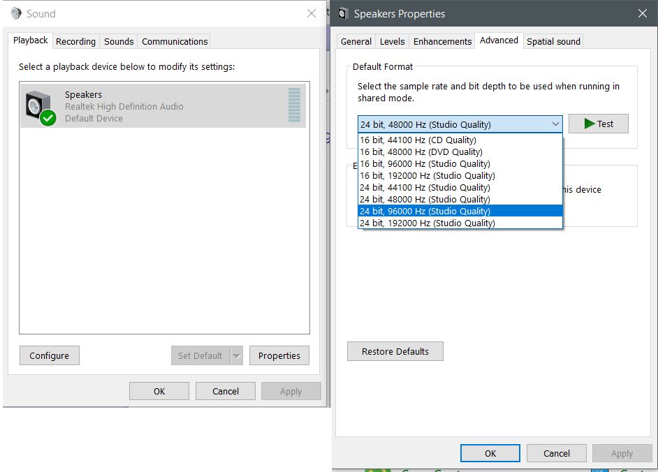

@EL506 You need a USB board with either 'ASIO' or else 'WASAPI Exclusive Mode' drivers. That's the only way to avoid Window sound engine. If ASIO there can still be a problem if the sound device is assigned by Windows to be the 'Default Sound Device' and or the 'Default Communication Device.' In that case you need a 2nd (possibly otherwise unused) sound device that you can assign as default. A $10 USB dac will do fine for assigning as both defaults.
The green circle with a white checkmark in the screenshot below is bad news. It means defaults are assigned to that sound card.
