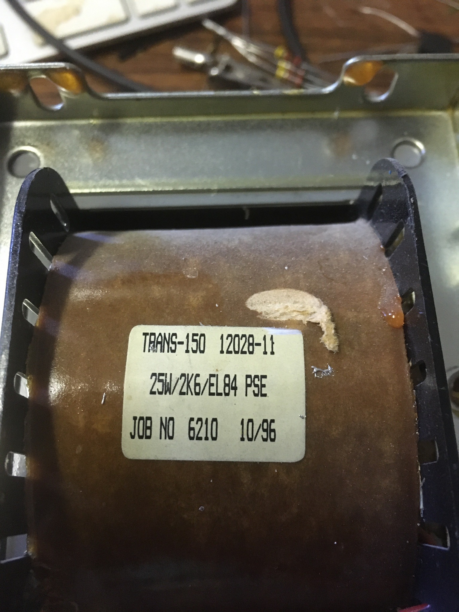

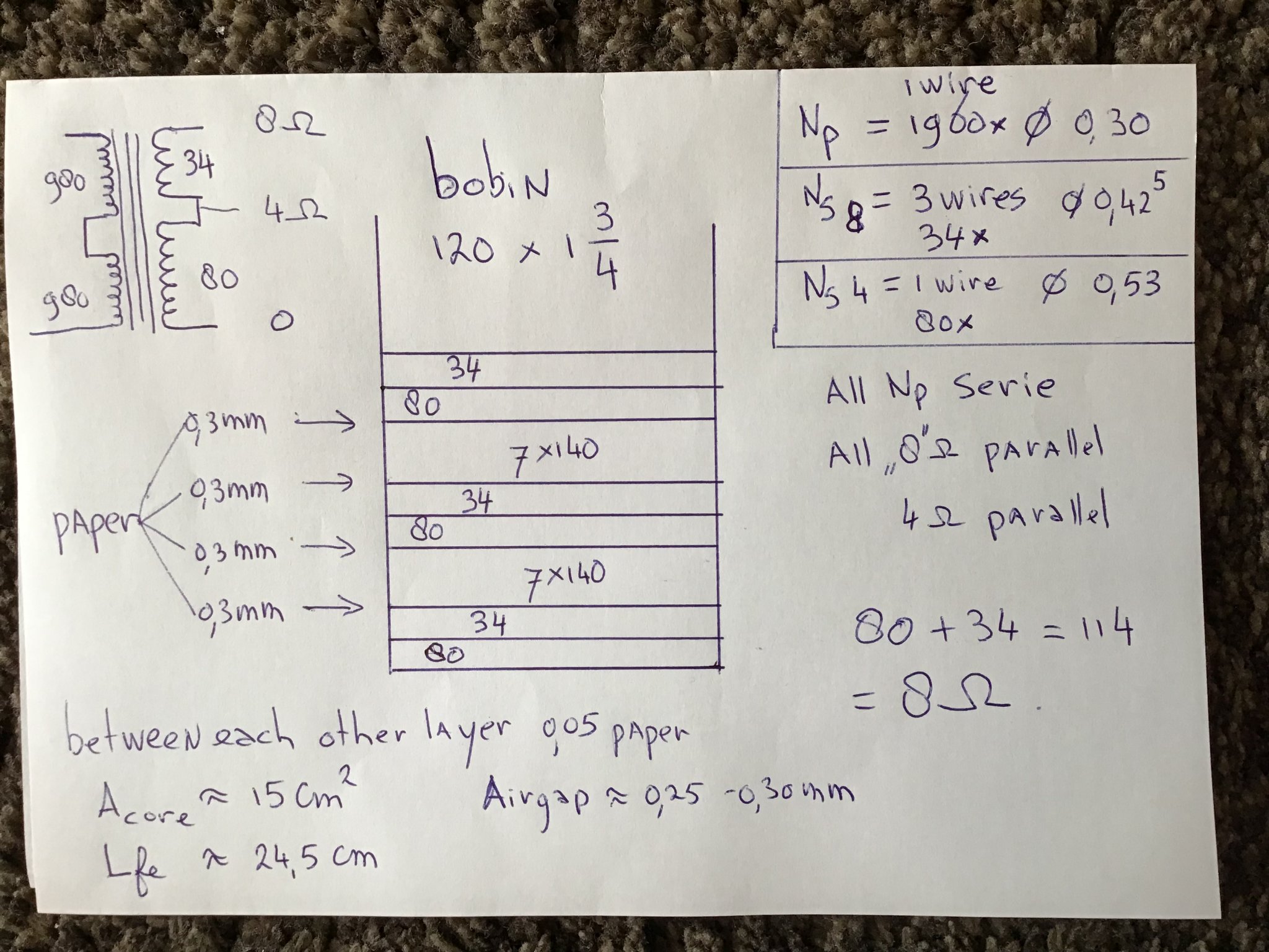

I had an old Audionote EI transformer. This is the winding diagram. Because of the vacuum impregnation i am not 100% sure if the isolation between layers and the airgap is 100% correct but it 9CF082DB-F6B1-4534-80BC-984B07653EED.jpeg
will be close. The same for the wires, i am 95% sure.
Btw, the 25W is completely nonsens.
It´s mostly right, and close to what I wind for my 50W 2x6L6/EL34 Guitar OTs, but there are a couple "typos"
* Primaries are shown as 900+900 turns on drawing but 1900 total on the wire list. "Pick one" 😉
* 8 ohm winding, 3 x 0.42 mm diameter wires in parallel is "possible"
* 4 ohm winding made out of a single 0.53 mm diameter wire is impossibly thin.
I might believe three such wires in parallel.
* "0.3 mm paper" is most probably Presspahn, not any random paper.
* interleaving shown: primary split in two and secondaries in 3, just to separate primaries, is about the minimum acceptable for Hi Fi, nothing to write home about; is this considered a high end OT?
EDIT: rereading I see it´s not a PP transformer (although by sheer chance turns match what I use for PP, hence the confusion) but apparently a SE one.
They also used the worst handwritten symbol for "8" , now I guess primary halves are 980 turns each, and total is 1960 turns (that "6" is also weird).
Oh well.
Still maintain my comments abut interleaving shown: not bad, at all, but nothing exceptional.
Not even comparable to Mr Turner´s Australian ones.
Just curious: is this one of those silver wire magical transformers?
