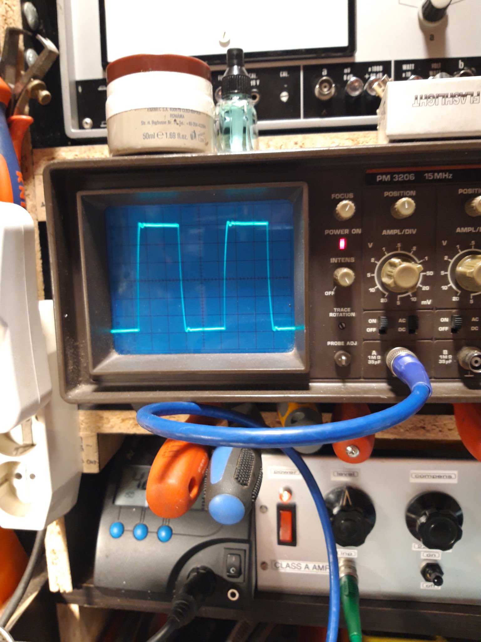

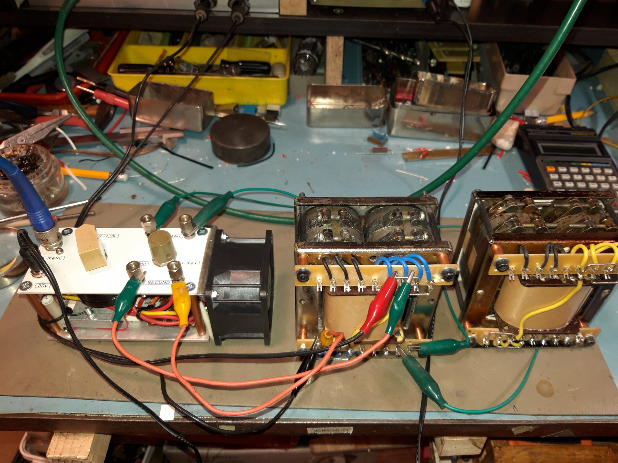

You can do OT in DIY mode, I built over a hundred of these transformers but my advice is to buy quality cores prefer C-core or double core. The last two transformers for SE have a band at -1dB of 12Hz-118Khz with a bias current of 50mA

1. Think of your target first. And start small. I consider a max of 5W@25Hz for SE, 20W for PP is a good beginning spot for first attempt OPTs. Such range can also work with some household materials for insulation.

6. You'll need at least an frequency generator and oscilloscope to verify your final result via square waves. Identifying square wave shapes takes some training. Preferably you'll also need a bode plotter.
