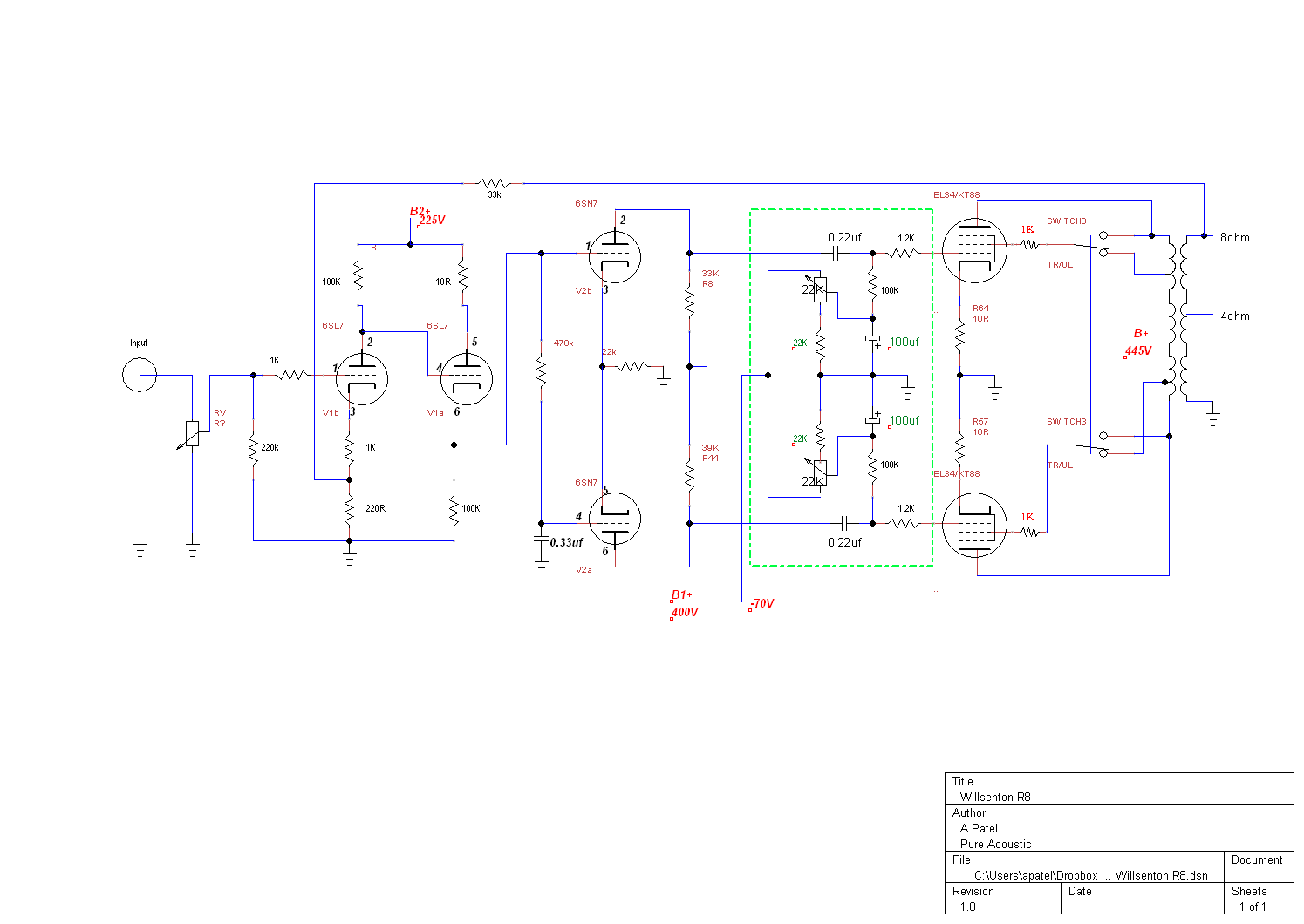

You may need to add a dominant pole to the design. The first 100k resistor from plate to HT needs a series resistor and cap. Try 10k and 330pF in series across the 100k plate resistor of the first stage. The GNFB should be from the 8R tap? You will have to experiment with the cap value. Watch your tweeters.

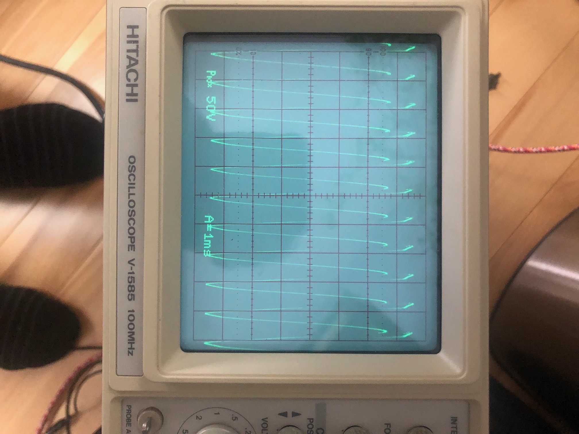

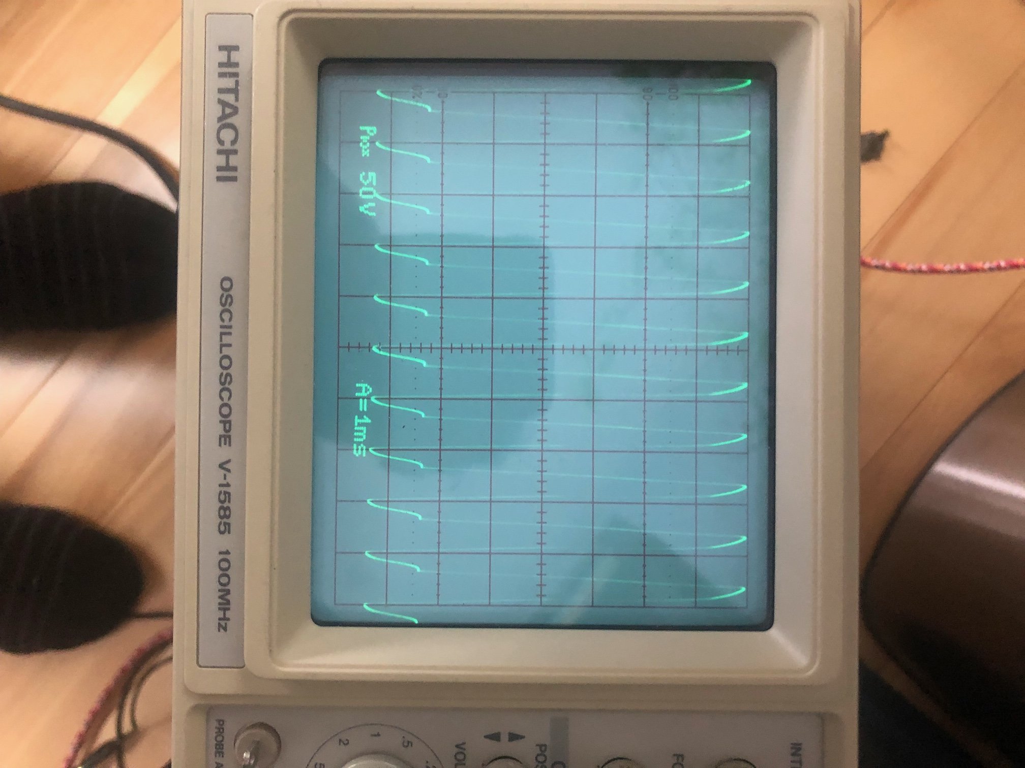

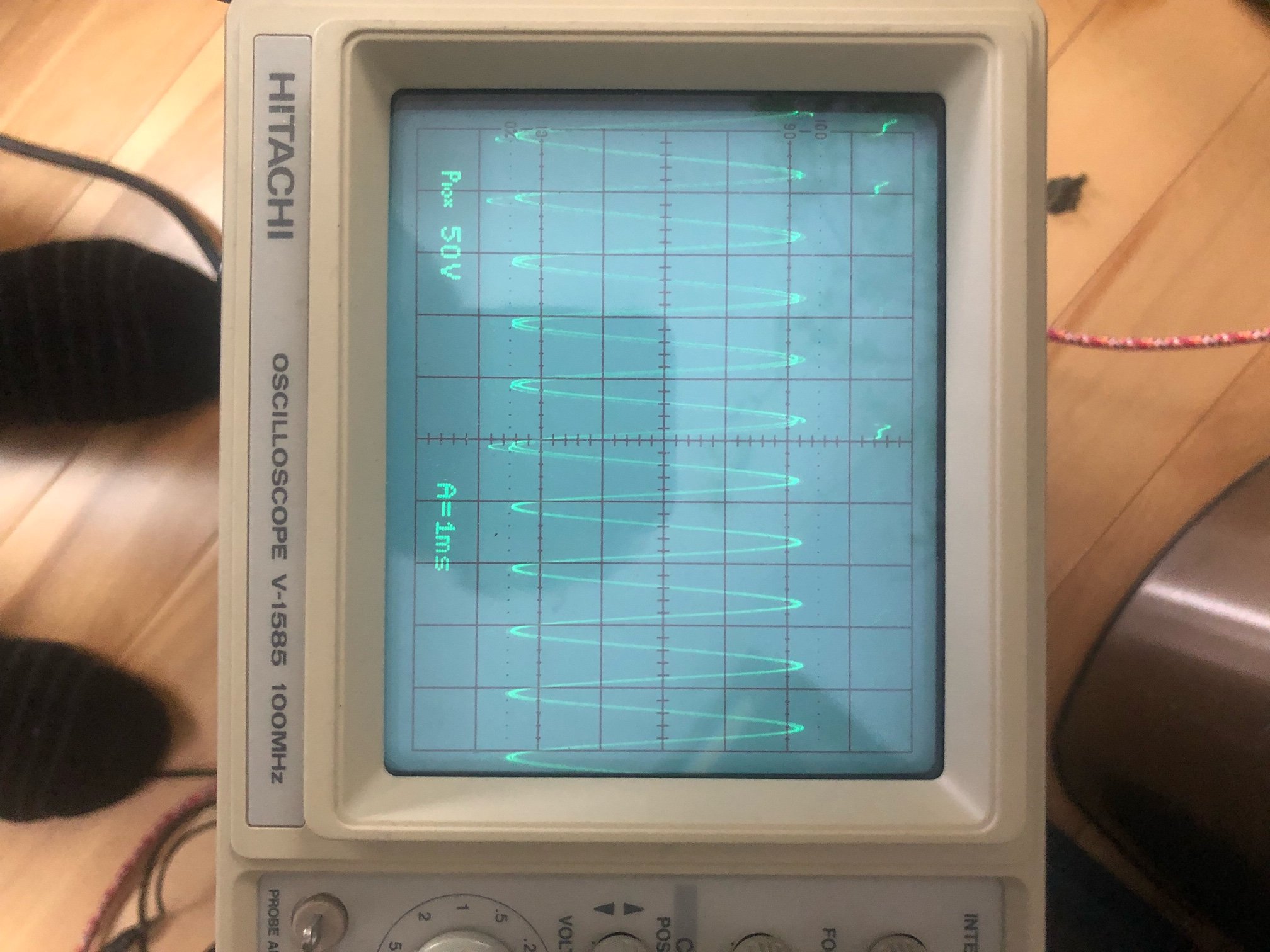

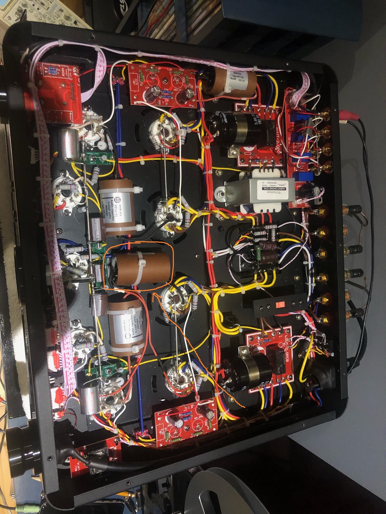

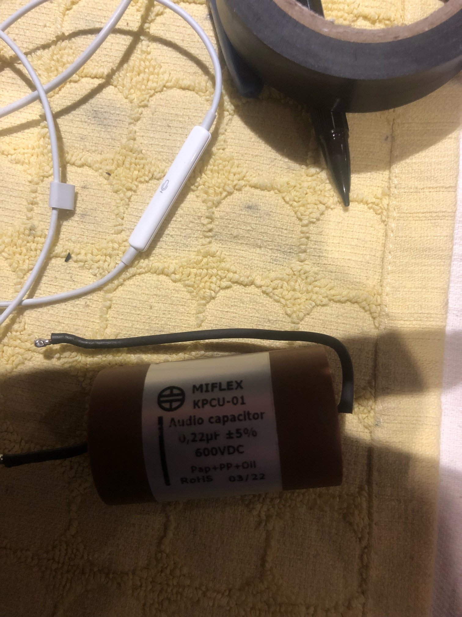

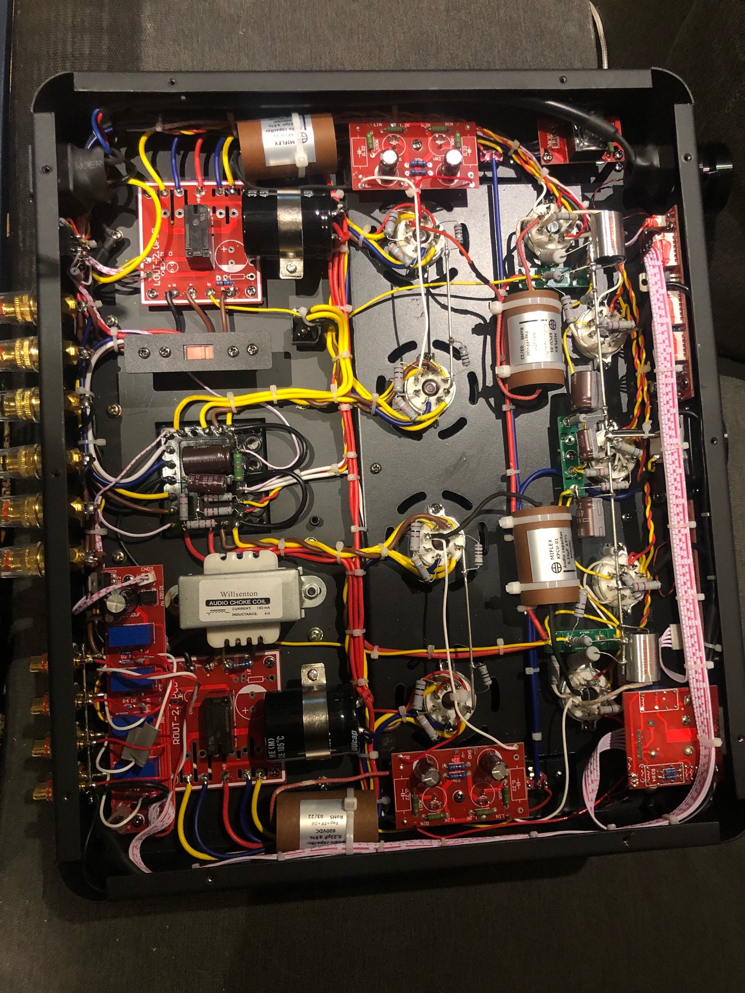

I have found the problem and I have to say I'm quite disappointed. Maybe a nube move on my part trusting and placing too much confidence in expensive audio capacitors.
The only upgrade I've done was to replace the 4 x 0.22uF capacitors with brand new Miflex KPCU-01. This upgrade and exact product was used my other members on other forums as well. Although it improved the sound, one of the 4 caps obviously has some fault as it causes these oscillations when increasing the volume in triode mode.
Willsenton support send me some troubleshooting steps thinking it's one of the tubes that's causing it. I will post their instructions in my next post so others could follow it as well in case they develop issues. Basically they said that if the issue exists in one channel it could also manifest itself in the other channel although the other channel doesn't have an issue per se. So I narrowed it down the issue being on the left channel only and no faulty tube. My next thing was to undo the only upgrade I've done which is these caps, narrowing down to one cap. This cap is not cheap for me, CAD $40 plus "canadian" taxes. I'll try to contact Miflex and see if they can do anything about it.
All this was caused by a relatively expensive, brand new, exotic, Pap+PP+Oil cap.
Thanks again for all your help as I've learned a lot from all your input. I hope it will also help others on this forum in case they develop issues in the future with their Miflex upgrades.

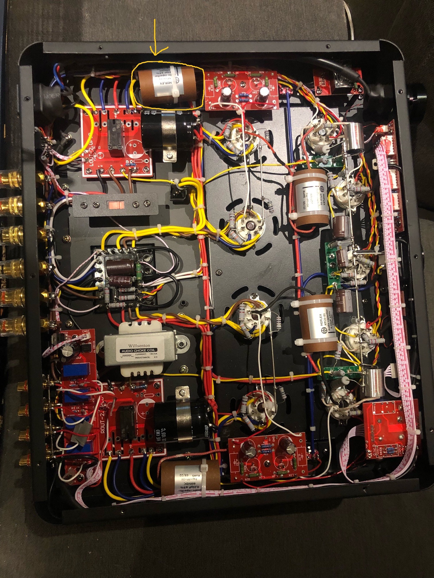

I feel stupid now bashing Miflex.
I tried to place the "faulty" cap in a totally different location. I tried this already but left the cap in the same vicinity as the big power cap. It's weird that the other side doesn't have the same issue although it's also close to a large power cap. Is this an indication that the power cap has some major leakage? Or is it the output transformer behing the power cap. The side with the issue is a mirror setup as the other side that has no issue.
Live and learn. Happy there was nothing wrong with anything and it was just a positioning problem aka user problem.
Thanks again.

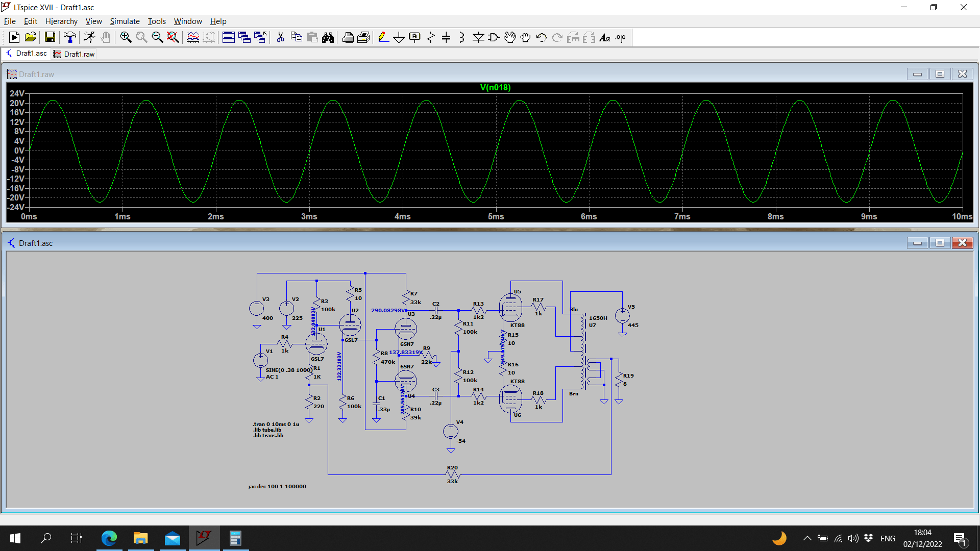

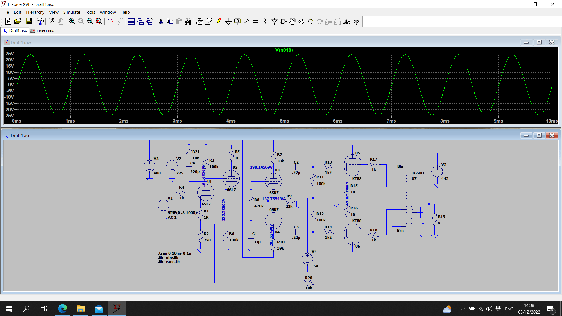

It's actually a token gesture amount of NFB < 6dB. This is shown up in your triode mode where the gain drops significantly. So I cannot see that being the source of your issue.
I've done a simulation both in triode and ultra mode. Again no sign of an issue. This is with an accurate Hammond OPT rather than the one you have.
The only thing I can see is that the .22uF should be kept away from the 1'st stage. It's just possible they are so big that the signal is coupling back into the input. I would have been happy with mk2/mk4's myself but hey! Unlikely but just a suggestion. The +225V decoupling is OK you may need a film cap across the electrolytic again unlikely. Your KT88 may have a fault but again why would it work in UL.
It's interesting that the distortion and output damping factor can be improved by some increase in the GNFB.
With one component change and the addition of two components to create a dominant pole the distortion drops by 10dB. The input sensitivity is now 800mV but that's fine with modern inputs.
