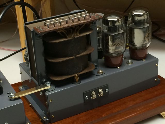

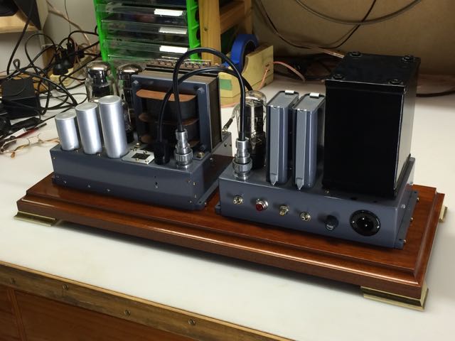

This final set of posts has been a long time coming, but we've now finally completed the Williamson restoration and mounted the two chassis on a base.
The amplifier has been running well for nearly a year, mostly using the original Bakers Selhurst driver in the huge bass reflex enclosure my dad made for it. The combination still sounds pretty impressive!
The other reason for taking nearly 12 months to get the restoration finished is that we got seriously distracted sourcing, then restoring an original mono Acoustical (QUAD) pre-amplifier. This has been a challenging project, but we now have volume and tone controls and when we've figured out the equalisation filters we'll have a workable phono pre-amp stage.

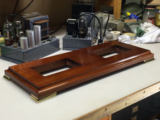

The base for the amplifier chassis is made from a slab of timber (some sort of eucalyptus) from a junk shop, with routed detail and a traditional french polish finish. I'll make an acrylic cover at some stage to keep the dust off when not in use.

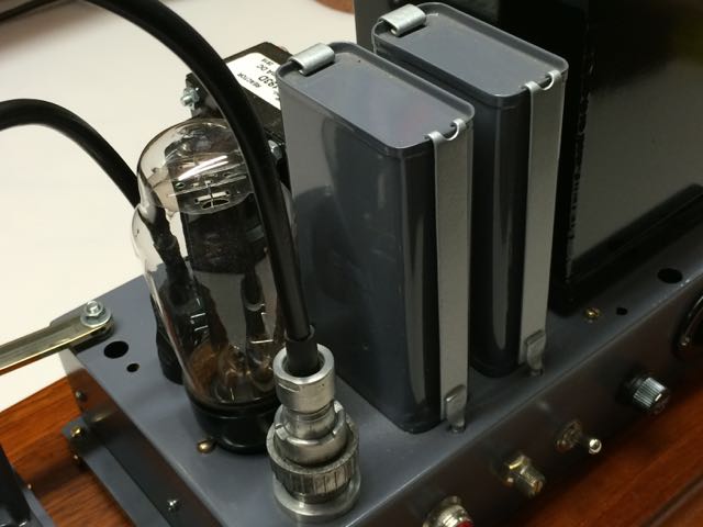

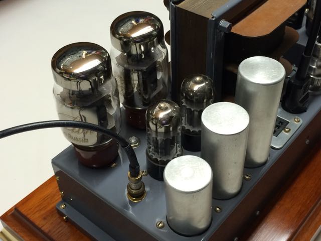

Some detail shots. All those capacitors on top are dummies, the original items, but not used in circuit. The KT66s are new, but the rectifier is the 60 year old original.
