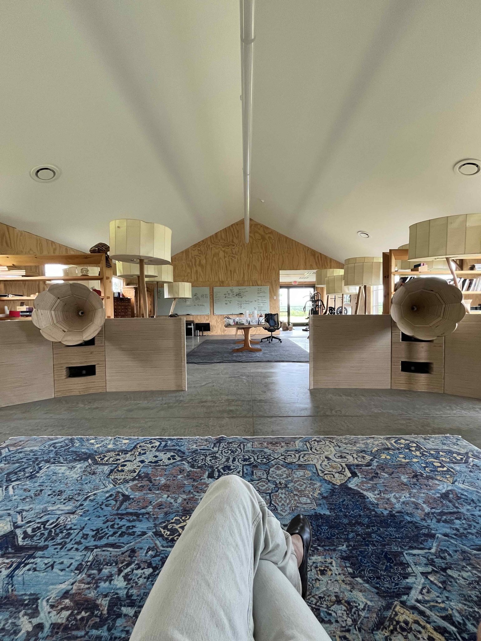

I stopped by the A for Ara workshop this weekend to take a tour and have a listen...what an incredible set up. CNC, metal mill, finishing room, the works. Very friendly host as well! The sheer amount of experimentation and thoughtfulness that have gone into these speakers is super impressive. Learned more than a few things as well, like the engineering reasons behind the petals (you want a sectioned horn for strength/stability to prevent seasonal wood deformities).
As far as the sound...despite the reverberant room, these boys image incredibly well and they were super clear to my ears, with just a single coaxial in the throat.
I'll also mention one of their bookshelf models, a two-way "half horn" type model designed to limit horizontal bandwidth outside of listening position. Would work great as a nearfield monitor. Definitely DIY-able. Can't wait to visit again and see what else is cooking!
