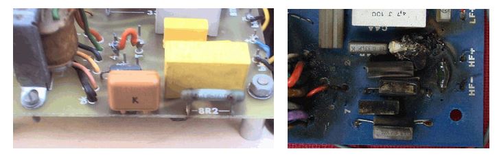

The UK diy electrical hobbyist market has been severely restricted in recent years by the necessity for safety. 😀
Periodic Inspection Report Explained | Electrical Safety First
It's no longer considered good enough for any amateur to build or even maintain mains equipment. Frankly it can burn down your house and workplace, and electrocute your friends.
Anyone sticking mains equipment in a box (easy as it might sound) must be qualified to do so. It must then be tested for safety (PAT testing at its simplest) and meet EU regulations.
What happens in case of flood, for instance. Or a mains spike down the mains. Or if you leave it to overheat covered by your jumper?
This is why some (maybe) OCD people unplug everything at night. But the fact is that manufacturers frequently recall devices for safety reasons. And these are EXPERTS. What do you really know about electrics? 🙂

Even loudspeakers are a fire hazard. Overload the tweeter section by fast tape-spooling forward, as we did in studios in the old days, can set components on fire. Hopefully nothing flammable was nearby. Well, obviously not, otherwise we wouldn't have the picture below. Phew. 😱
All I can say, is I prefer to stay within my comfort zone and sleep soundly at night. 🙂
Each component should be considered for thermal performance and ventillation, internal and external electrical isolation, mechanical security including long term vibration considerations, where and how you fuse, how you use switches, how you earth for safety (including the methods of affixing the connections) and how you introduce the input/output connectors. Other things include noise isolation from the mains and other places and how you internally earth the device for correct performance.
