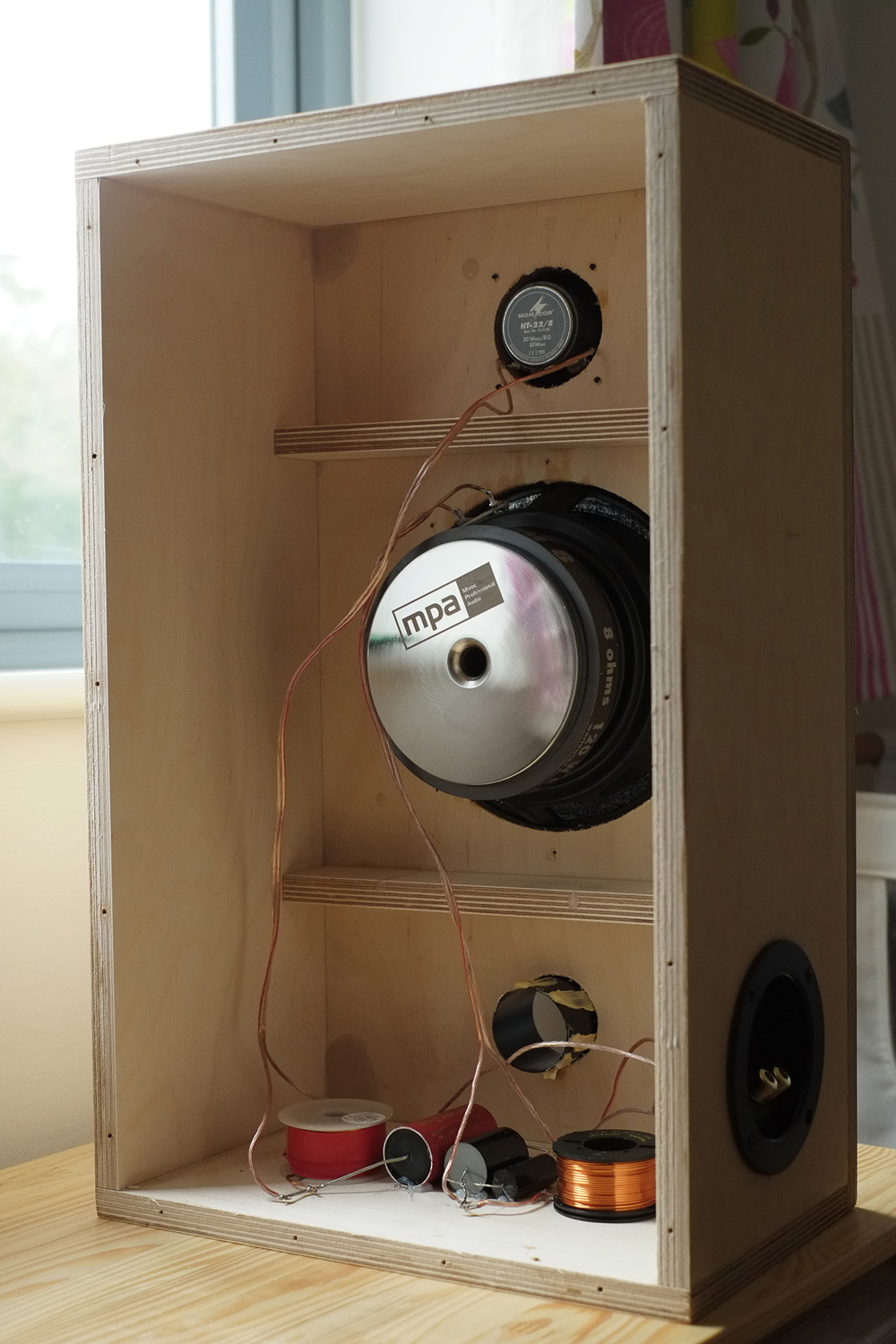

TBH, I didn't fancy a couple of woofers in a box with a tweeter at either end. Much as I love 8" bass and tweeter.
This is more like it. About a Cubic Foot or 30L.
http://www.diyaudio.com/forums/multi-way/147632-classic-monitor-designs-25.html#post4428857

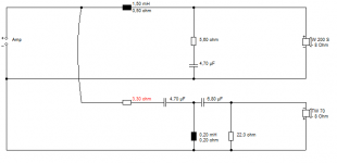

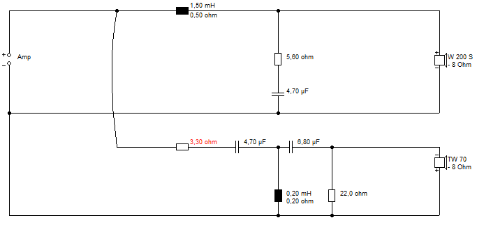

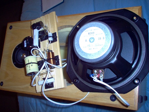

Crossovers aren't hard. You can fiddle with them, even unwind coils.
Not the last word, but something on these lines below.
How are your soldering skills?
