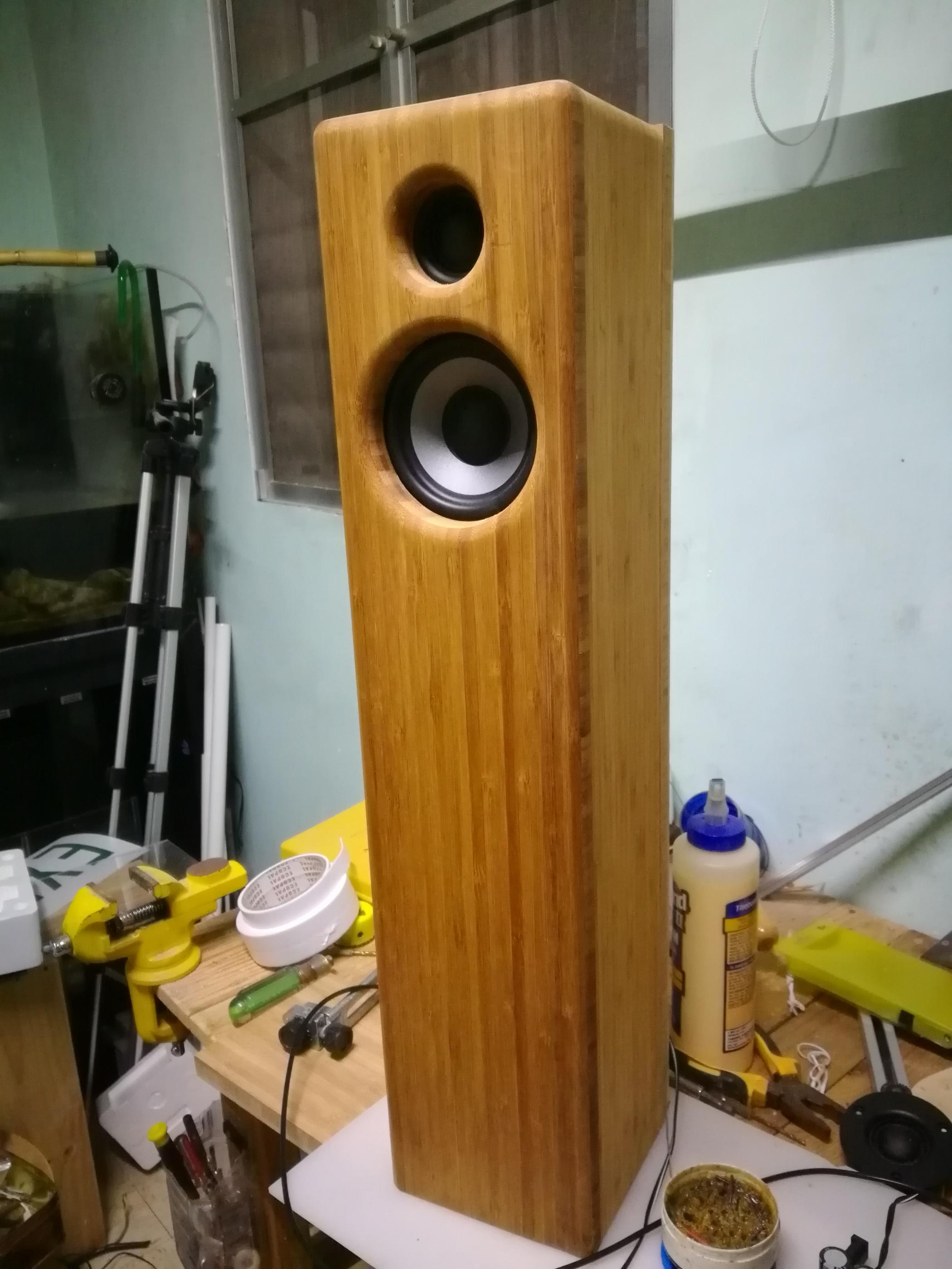

It feels like hard wood, strong and heavy too, but feels must smoother to work with. Especially with hand saw or chisel. And even not hard to cross cut against grains. But amazingly strong and sturdy.

I haven't add bottom piece yet. According 5.7 litre calculation, bottom plate needs to be a little bit higher than bottom line. But as it is on the photo, I tested over a white piece of silicon rubber mat. Not 100% sealed but sounds not bad to my ears. If I bend whole thing backwards and make a small gap at bottom, bass sounds change a lot. I can't decide which sound is good to me. Is there any way to determine that?
So, I'm gonna finish it up. And try if it OK sound. If not I can add hole or whatever it needs. By the way I heard that first 100 hours I shouldn't turn volume too high... And after 100 hours of playing, driver will reach full capacity. Or something like that. Is that true?

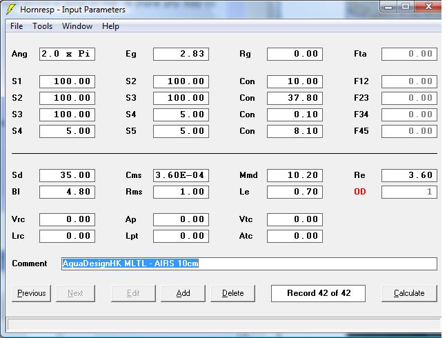

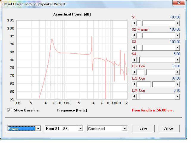

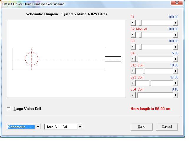

Because the box is tall and thin it falls between a "ported bass reflex (BR)" and a "mass loaded transmission line (MLTL)". I've used HornResp to estimate both and I get the same answer for both. I also tried a sealed box and the performance is poor so your ears are correct. HornResp is only useful for bass response so low freq (<500Hz).
The MLTL graphs were include because you could get reflections (glitches) due to the aspect ratio (tall box). You should place some polyester fill (2 cm deep) at the bottom of the box to reduce them. You'll need a 2.5cm diameter x 8cm long pipe near the bottom 1/3 of the case at the back side.

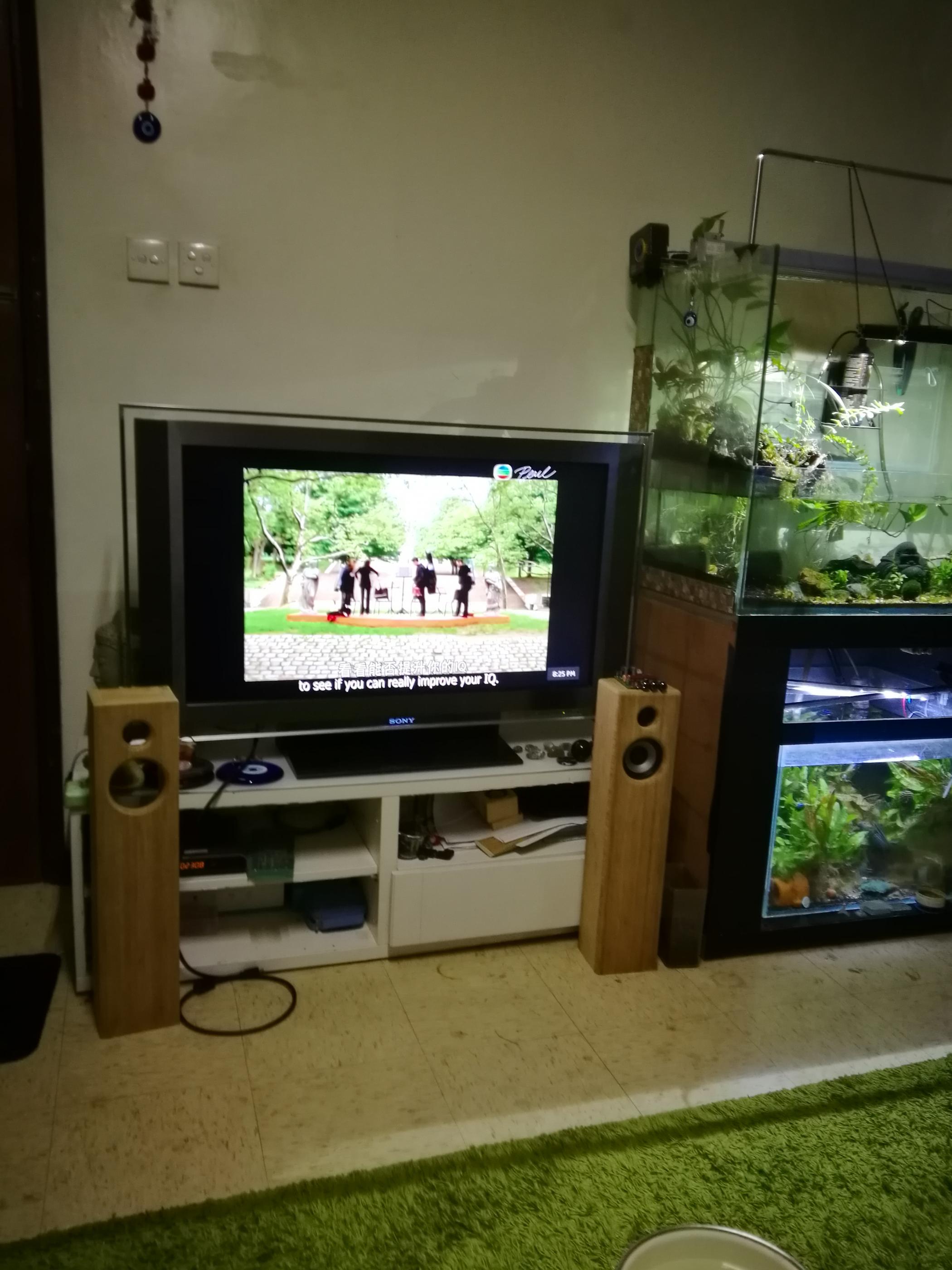

Ok I now understand. I can get some nice looking pipes as below. Also i can make the hole match with tweeters hole, like rounded over edges. I think I can finish everything tomorrow. And definitely share the results! Thanks again...
