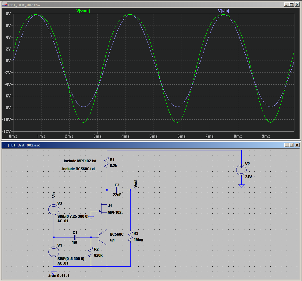

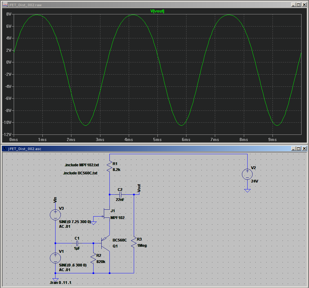

Using valves is not the only way to generate progressive, subtle distortion, though. Like many others, I have been tinkering with ideas to generate progressive distortion from solid-state circuits for many years. The attached images show one example, a JFET circuit I came up with. The JFET is wired in common-gate mode, which is not typical in audio circuits; a BJT emitter-follower drives the low-impedance JFET source directly, eliminating the linearising effect of a source resistance.
The images show this circuit generating a significant (and certainly audible) amount of distortion, which would probably be heard as a clean tone, but a richer clean than the thin cold sound of an unclipped op-amp stage.
The second image shows an undistorted sine wave (purple trace) overlaid on the output of the circuit (green), so you can see just how much distortion is actually being generated. Note that there is no actual clipping whatsoever, though - neither half-cycle of the output is flat-topped!
An FFT of the output waveform shows a large amount of second-harmonic distortion, and inaudibly low levels of all other harmonics. This is no accident, as the goal was to use the square-law characteristic of the JFET to extract musical-sounding second harmonic distortion.
For my musical tastes, this is where good clean tone comes from - progressive soft distortion, long before any actual clipping occurs. Op-amps configured as the usual textbook inverting or non-inverting gain stages fail miserably at this.
