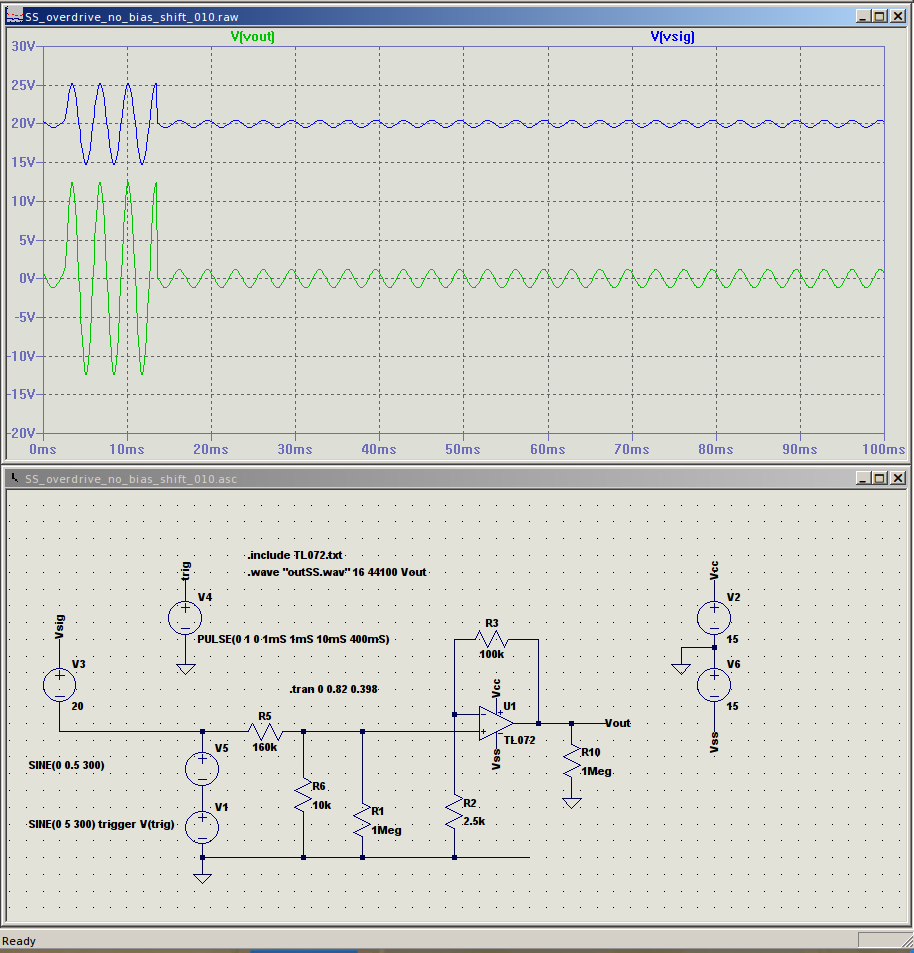

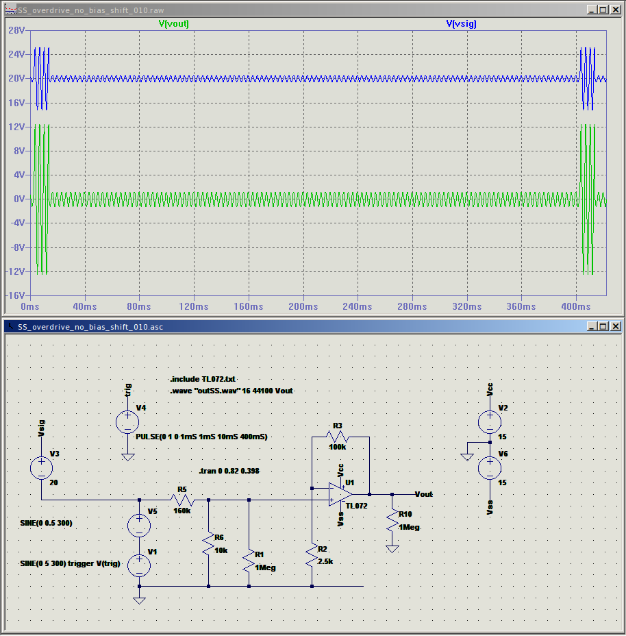

Recently I started thinking about ways we might use LTSpice circuit simulation software to give us a little more insight into guitar amp designs. The signals from a guitar playing music are anything but static, with constant jumps in amplitude, frequency, and waveform. As I mentioned earlier in this thread, I have come to believe that the way these jumps in amplitude are treated are part of the reason why valve amps so often sound better than SS amps.
To test this hypothesis in LTSpice, the first step I took was to concoct (in LTSpice) an input signal that wasn't completely static like the traditional continuous sine wave test tone. I can't simulate a real guitar signal, but at least I can take one step in that direction - I can make the amplitude vary with time, in a manner that at least crudely mimics the guitar-pick (or finger) hitting the string and triggering a new note every so often.
The attached image shows how I coaxed LTSpice into spitting out what is sometimes called a "tone burst" signal - still a sine wave of fixed frequency, but the amplitude jumps between a short loud burst, and a longer quieter stretch between bursts.
The first attached image shows how an op-amp (in this case, a simulated TL072) behaves with this tone-burst input. The upper purplish-blue trace is the input. The green trace is the amplified output.
The op-amp does exactly what 50+ years of brilliant electronics engineers worked very hard to achieve: the output signal is a virtually perfect copy of the input signal. This is a very good amp. This is exactly what we want for Hi-Fi, and for virtually every other audio application except e-guitar.
If you understand how op-amps came into existence, and how they work, this nearly perfect behaviour will not come as a surprise. This is exactly what makes op-amps the technological miracle they are: tiny, cheap, yet almost perfect amplification.
The second image is a closer zoom into the waveforms of the first image. We see nothing new - the output signal is still a perfect copy of the input. Again, this is a very good amp to any audio engineer.
-Gnobuddy

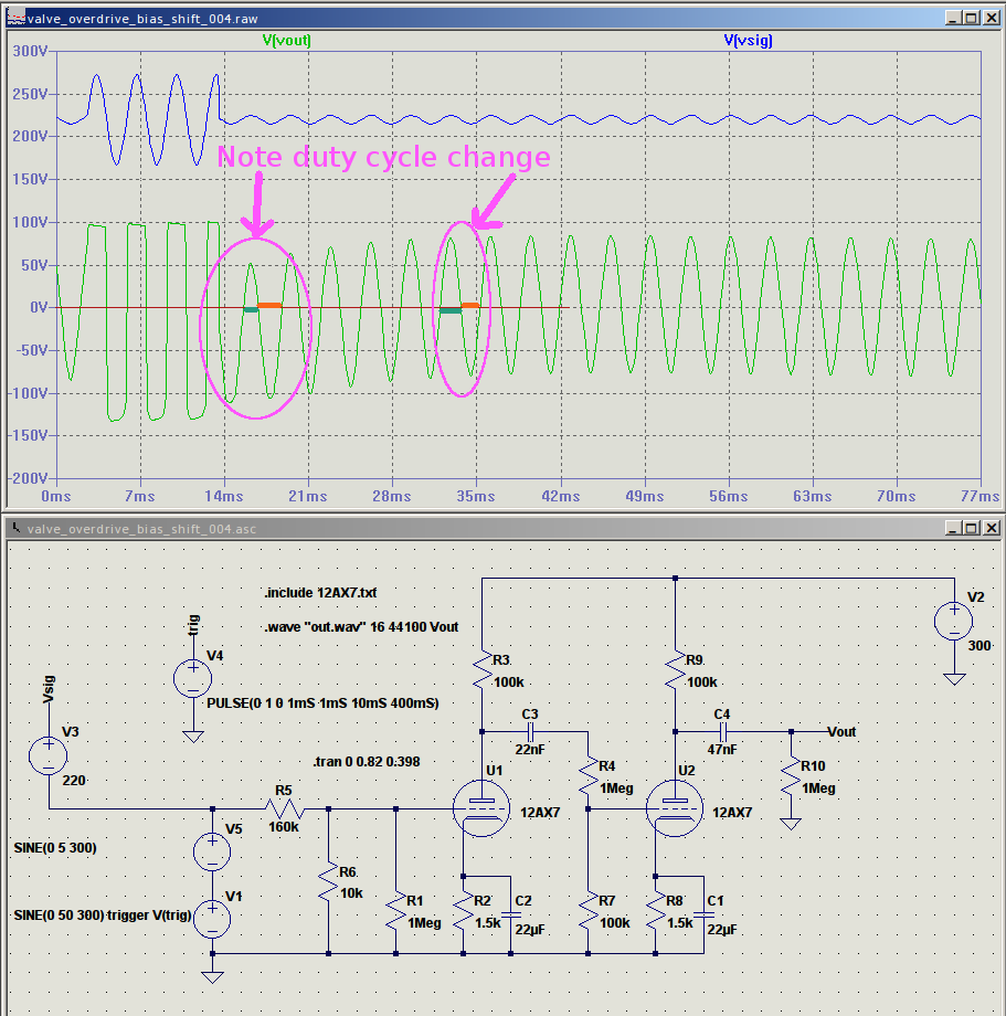

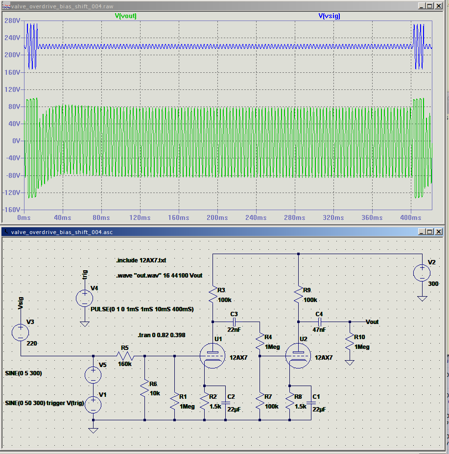

Now let's take a look at an LTSpice simulation of a valve amplifier, fed the same signal, but bigger (because an op-amp only has +/- 15V rails, it cannot handle the big input signals that valves can work with.)
Look at the first image. Once again, the purple trace is the input, the green one the output. But this time, the output is anything but an identical copy of the input! Instead, the ancient and primitive valve circuit suffers DC bias shifts when that big initial burst of signal hits, and then recovers slowly as the cathode bypass and coupling capacitors discharge. The gain drops when the big signal hits, and climbs when the signal level drops - so there is much less dynamic range in the signal. The valve amp also acts like a compressor, smoothing out dynamics and increasing the sustain of the guitar.
There's more. Look at the second image, which is a zoom into the first one. Notice how the duty cycle of the output signal varies as the bias shifts and recovers? Mathematically, this has the effect of altering the harmonic spectrum of the signal. Though the input tone-burst only has one frequency in it, the output of the valve amp contains additional harmonics that alter the timbre - and the timbre shifts over time, lending movement and life to the notes from the guitar.
This means that instead of a steady bumble-bee buzz, we hear a little more subtlety and movement in the timbre, closer to a "proper" musical instrument like a saxophone, where the timbre varies continuously with the players blowing force, lip shape, et cetera.
These are, of course, only simulations, so take them for what they're worth. The valve simulations are certainly imperfect, they're only as good as the mathematical model representing the valve in LTSpice. Still, simulation warts and all, we can actually SEE differences in behaviour between the solid-state preamp, and the valve one.
To clarify a point: the much older and more primitive valve amplifier is a bad amplifier. It fails to accurately reproduce the input, which is the goal of all amplification to almost any audio engineer or tech. But as so often happens with the aesthetic arts, it is the imperfections that make good art. In this case, the imperfections of the valve amp extract better sound from an inherently flawed instrument (solid-body electric guitar.)
You could draw a crude analogy with a paintbrush - an imperfect means to apply paint to a canvas, since it leaves brush strokes, applies a non-uniform coat of paint, et cetera. A paint roller does a much better job of applying a flat, wide, uniform coat of paint. But which one is better for making great art? What would Da Vinci's Mona Lisa look like if he had used a few paint rollers to apply uniform, even layers of paint, with no brush strokes, no translucency, no gaps in the paint, no variations in thickness, lustre, opacity, sheen?
You may or may not find any of this compelling, or even interesting, but at least we can see that there is more to the discussion than just claims of magic hearing or "golden ears". The old, primitive, imperfect valve circuit does (technically bad) things to the signal that the modern, precise, accurate, nearly perfect op-amp does not. And paradoxically, at least in my opinion, the only way to make a good guitar amp is to make a bad amp that flatters a bad instrument in a good way. 😀
There is a corollary: IMO, it is ridiculous to try to make a Hi-Fi amp using valves. Solid-state circuitry is vastly better at accurately reproducing the input signal - and that is the goal of Hi-Fi.
Amplifying e-guitar is something else entirely. The input signal sounds bad; we don't want to reproduce it accurately, we want to wrestle, mangle, squash, pummel, and massage it into something that sounds more musical. And ancient, faulty, valve technology happens to be quite good at doing that.
-Gnobuddy
