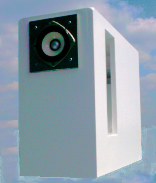

Hello,
the flute Sat might be a solution down to 120 Hz 6dB,

look here spiderless,
That is an old version. All the current ones, and that have been made since VIFA was making them (at least) have had traditional spiders.
Those, and the JX150, JX125 of the same era, do have a mechanical rear suspension (the rod connecting the dustcap to a foam spider at the back of the driver). The JXR6 (and J6T and Alpair 5) all rely on ferrofluid for the rear suspension/alignment.
dave
Dave is right. The image is of the original J92. From the Vifa era onwards, they have a conventional spider. Partly because Vifa made conventional drivers and weren't geared up to produce the Jordan rear suspension.
