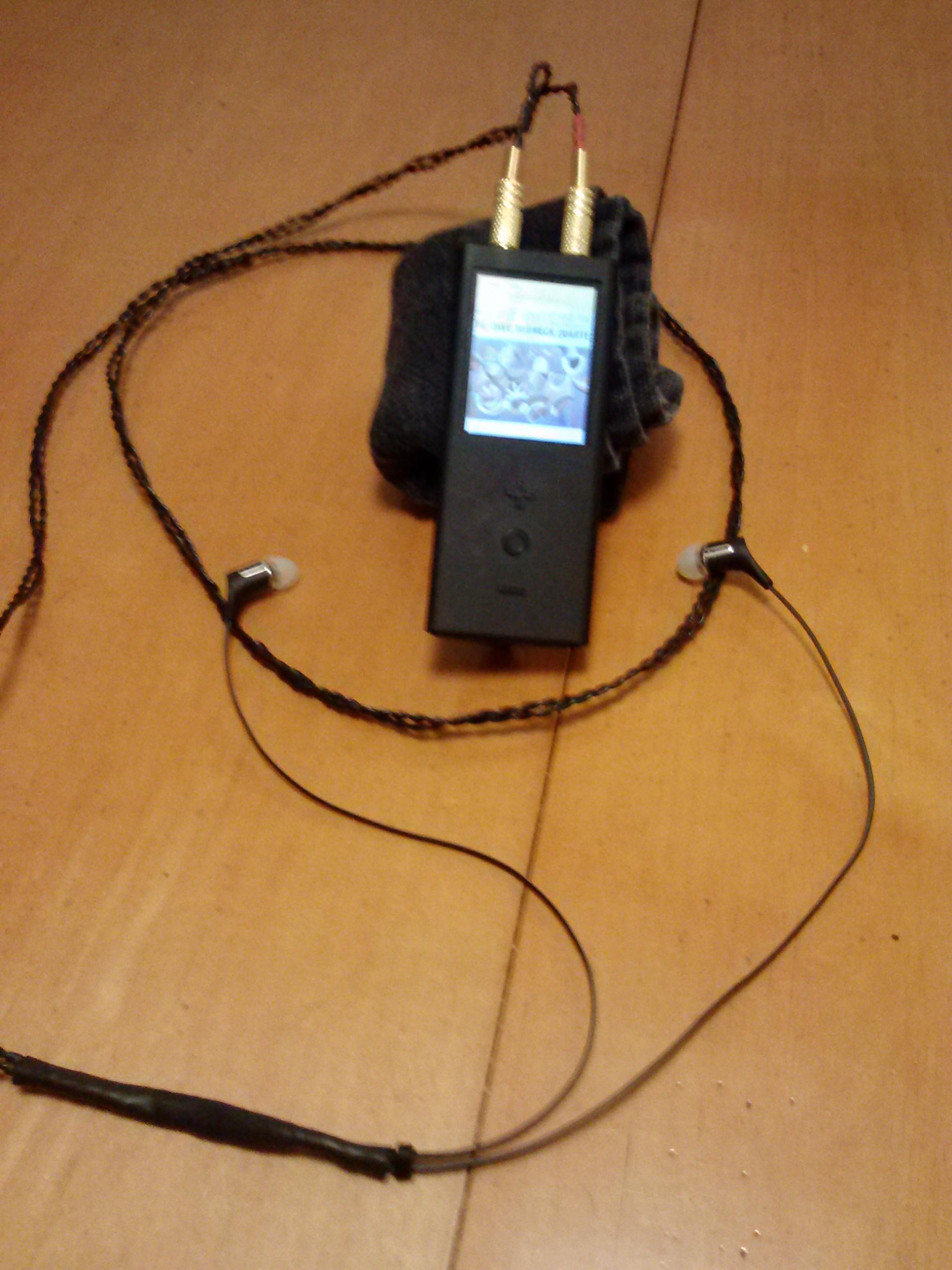

I'm eager to use my Pono player as a balanced source with the Wiener. Gmarsh was kind enough to offer a schematic for the balanced hook up. The Wiener card should arrive any day.
While waiting for my card, I finally got the nerve to do surgery on a pair of Klipsch X4s to render them "balanced" in the sense that left and right channels no longer share a common ground. The patient survived the surgery, The improvement in SQ is dramatic.
The first thing noticed is the need attenuate the volume compared to single-ended. The separation and depth of soundstage are spooky. The details are fantastic.
The balanced results with the Wiener and speakers are eagerly anticipated and will be shared.
